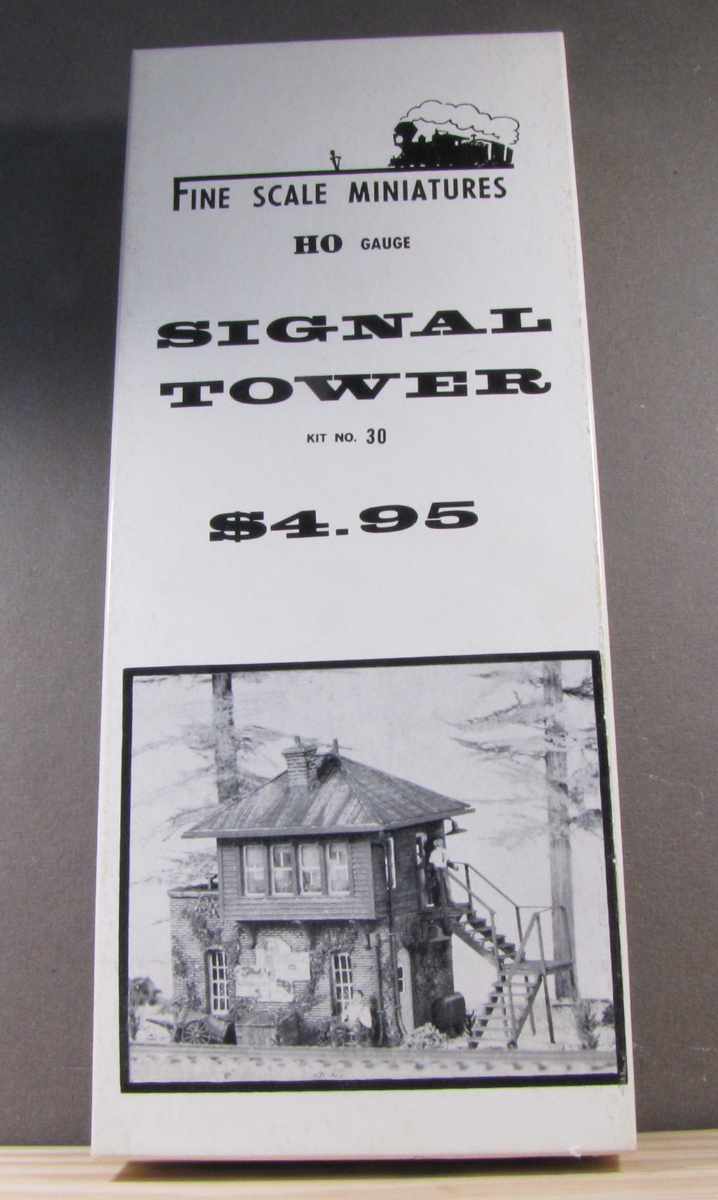

The signal tower. Again that's what I paid for it. Both were bought in a hobby shop many many years ago. The walls are warped because they are some kind of paper. It would be a great candidate for replacing the warped material for something used in wall construction today.
My big problem here is that I have to many "projects" and not spending time any any long enough to finish them.

Bernd, I was able to salvage the walls of the tower, even though the box had be soaked with water. The roof was in worse shape and prompted me to make a new sub-roof and change the covering to slate.
