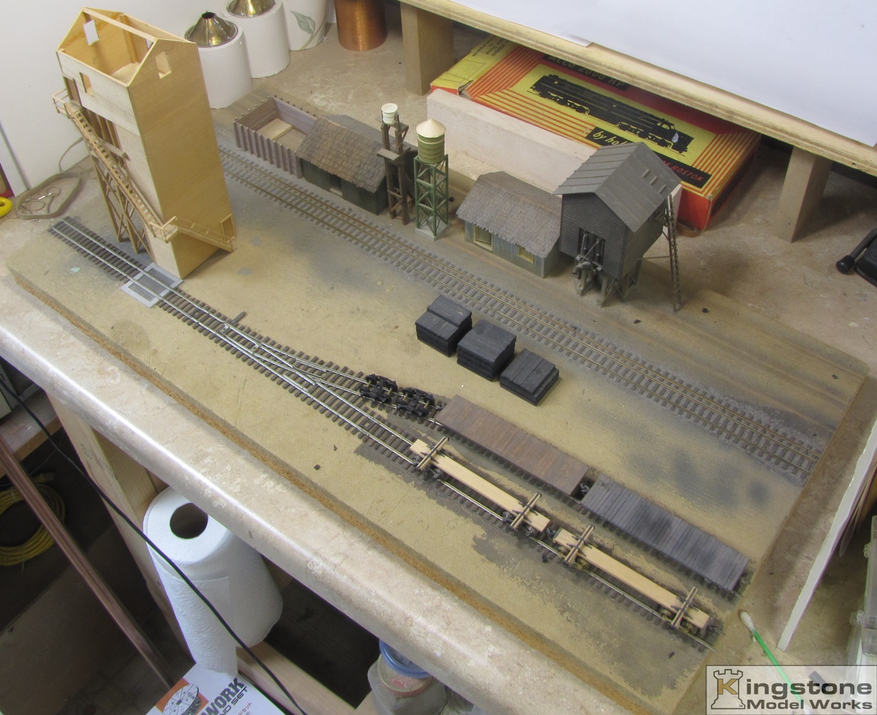

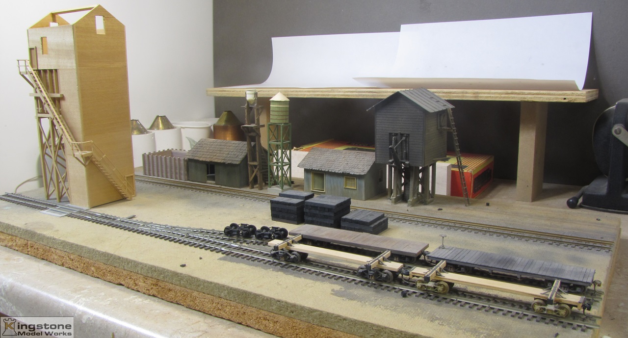

After looking through the kit to make sure everything was there I decided I needed to get out my 12" X 24.5" engine fueling facility module.
The concept behind the module is that is serves both HO and HOn3 engines and narrow gauge would fill the 100 ton coaling tower by Alexander Scale Models coaling station. I started this module over 20 years ago when I lived in a mobile home. The amazing thing is that the models sustained very little damage over those years.

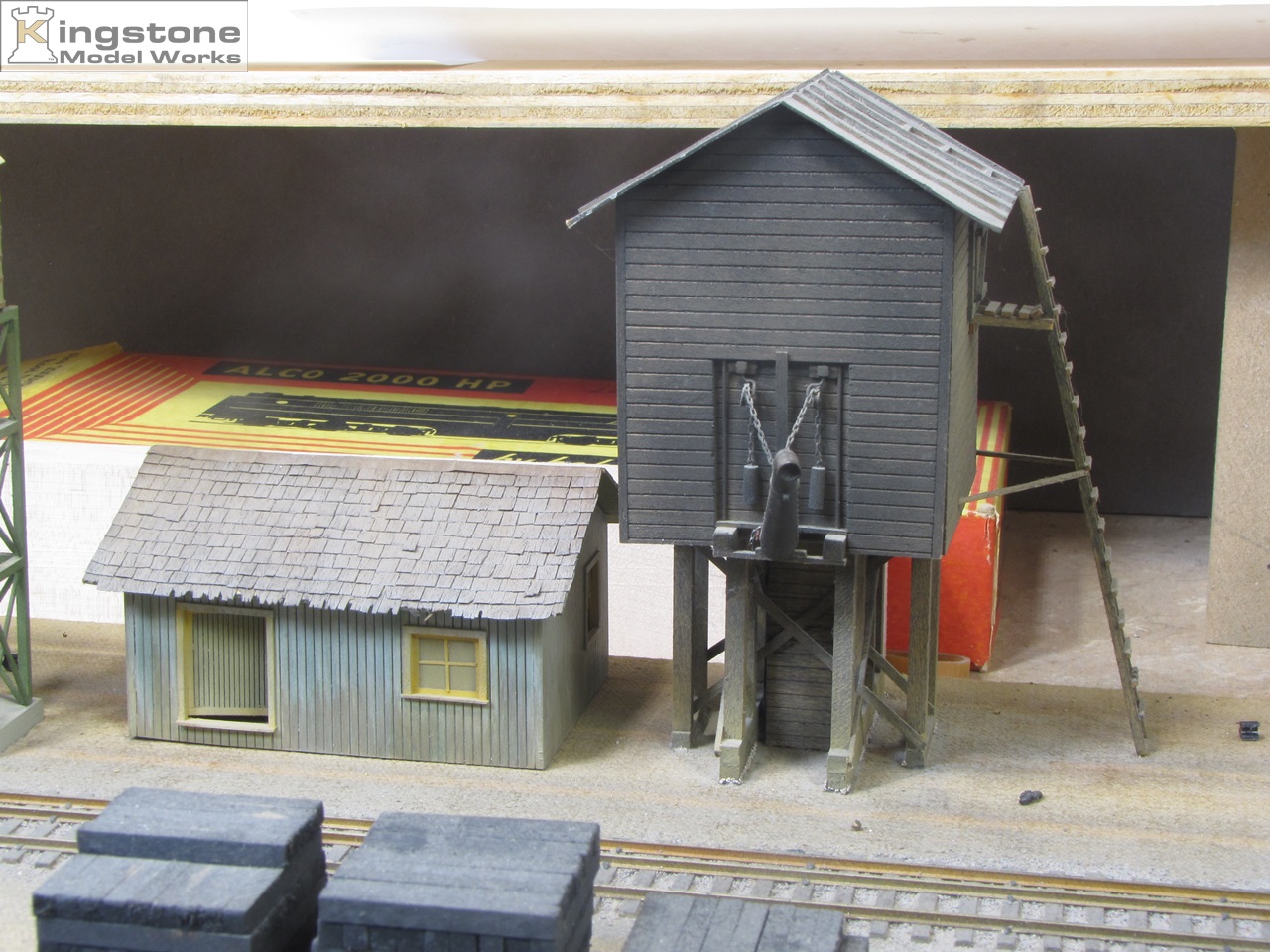

The square water tank is also an Alexander Scale Models. The yard office was scratch built. The shingles on it are cigar cedar wrap. Each shingle was cut individually and glued on.

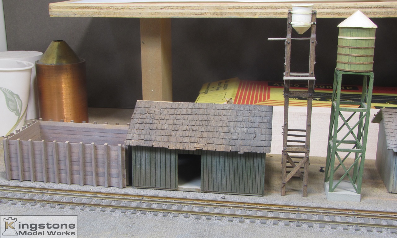

The sand bin, sand drying house and two sanding towers are all scratch build. The sand bin, drying house and sand tower are copied from Campbell Scale Models plans. I do have the original kit. The shingles are cigar cedar wrap.

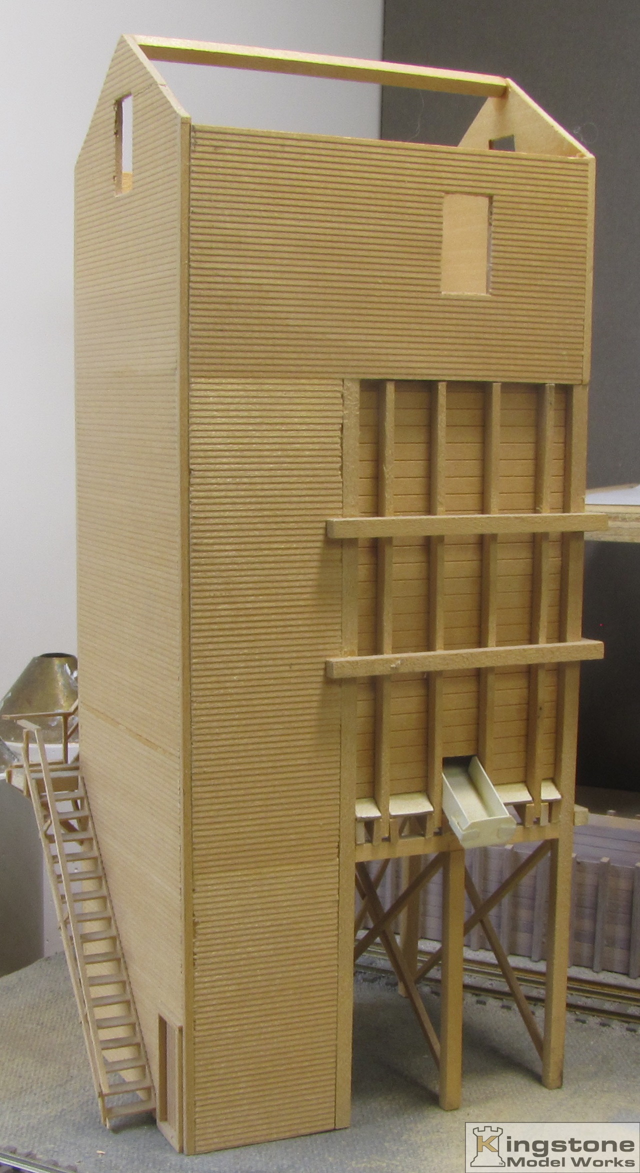

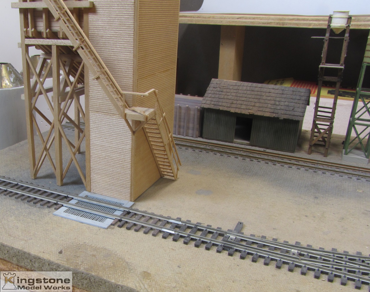

This is the only damage the coaling station sustained in over 20 years and of course it's not completed as is much of the diorama.

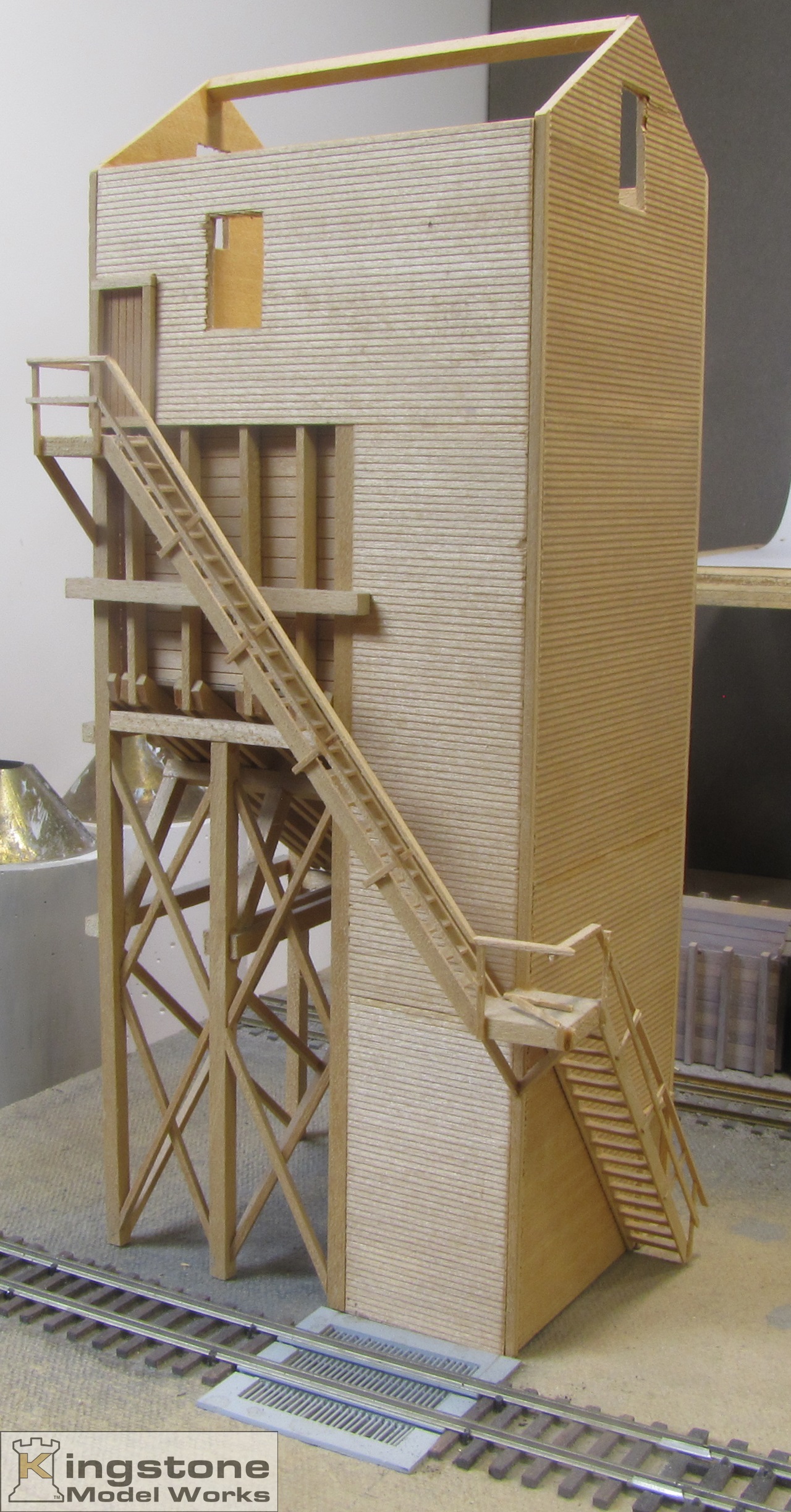

The stairs are scratch built. I didn't like the casting that came with the kit. I used a fixture I made up to do the stairs. The had railing is 1" X 2" scale lumber.
The dumping pit on the narrow gauge line. I cut out the Homasote, lined it with styrene and added copper wire breaker bars.

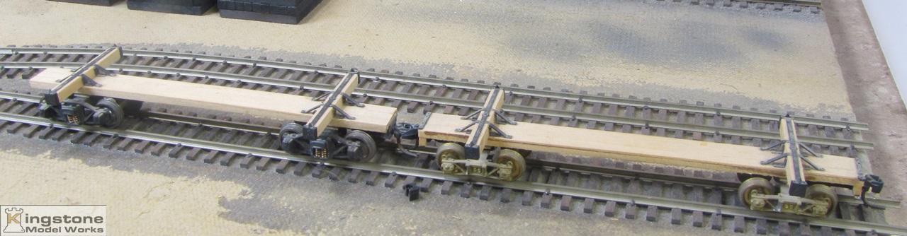

Two log cars. I don't remember the name of the kit manufacturer. The one on the left has "Central Valley" HOn3 actual sprung trucks. The one on the right has brass trucks from an un-known manufacturer. I think I have two more log car kits hiding in a cabinet some where.

Quick update on those log cars. The company that produced the kit is/was Scotia Scale Models in New Brunswick, Canada. The car represents a 30' standard gauge Russell log car. Mmmm......... they look and work pretty good in 3 foot narrow gauge too!

20 years Bernd. It is time you got back to work on this little gem of a module.

You have the makings of a nice module, Bernd. Painting the coaling tower, now that it's been assembled, will be a challenge.

Looks like the bin would need to be closer to the dual gauge track to service the locos. Coal could auger from the pit to the tower to put the chutes in reach of the track.

Great looking start to a fantastic looking diorama setup, if not used on a layout, it sure would make a great conversation diorama. I'd like to see progress on what you have started many years ago Bernd. Also, I sure miss those cigar cedar wraps that were once easy to obtain for "0" dollars, that made into excellent modeling shingles.

I'm astonished that you started this diorama twenty years ago too! It has the makings of a fine stand-alone piece, like Frank mentioned.
In your above statement, regarding painting structures before assembly, that is not always true, especially for me. One example of that is your small train shed, with what looks like stain/weathering powders? If I want to stain/paint to make the look wrap-around from front to corner and beyond, I would stain/ paint after assembly, to have the color flow from one side to the adjoining side. As in the look of your building. on the other hand, the coaling tower is another story. Like George mentioned, it would be difficult to stain/paint, especially after the stairs are glued to the building. Also, in a challenge that you were doing building the station structure, I think last year, I thought you had mentioned that you hadn't built many wood structures. From the ones seen here, you are good at it. And I must say, your workbench is mighty clean. I will continue to watch this unfold.

You have a golden oldie there, certainly worth the effort to complete. I’m interested in watching the scene develop.

Thanks George. I've been thinking of giving it a spray paint job. It should get into all the nooks and crannies. We'll see.

The bin is not glued down yet. It will be positioned correctly once I'm ready to permanently mount it to the module. I still need to add the auger portion of it.

The sand shed and the tool/crew/yard shed was assembled and then painted with Floquil paint. The stains around the bottom are thinned Floquil paint. The drying sand shed is the same deal. I had not yet heard of using powders for staining. The water tank was also sprayed with Floquil black. The Campbell look a like sand tower was brush painted with thinned Floquild brown. So that's the extent of painting the buildings. All were assembled before painting.
As I said in a previous post I'll give the coal station a coat of brownish/black paint. I would assume that creosoted wood would be used in a building like this or did they actually give it their RR paint scheme?
