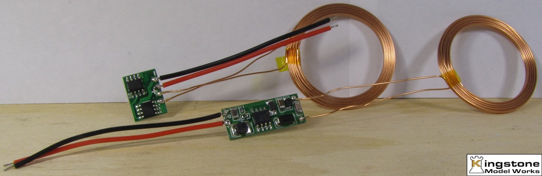

In a previous forum I used to visit a discussion about wireless charging mention a vendor selling wireless charging boards. The vendor is the Robot Shop located in Swanton, Vermont. They have several other stores around the world for our over seas model friends.
I ordered a 12V 600mA Wireless Charging Module ( https://www.robotshop.com/en/12v-600ma-wireless-charging-module.html )
The transmitter is to the left and the receiver on the right. I'll need to dig through my power supplies and see if I have a 12 volt supply. Failing that I could always used a computer power supply since perhaps they'll have a ripple free DC current.
The one spec that needs to be considered is the distance from transmitting coil to receiving coil. The specs are Transmit-receive distance: 1-20mm or .039 to .787 inches. It looks like it would work for mounting the receiving coil under the fuel tank of a diesel.
I'll report back when I get it set up to see how this charger works.

Posted - 07/12/2018 :  3:49:07 PM  Show Profile  Visit Bernd's Homepage  Reply with Quote
The kit I ordered from the Robot Shop has no specs on wattage. Dave (d10ng)mentioned the Robot Shop on Freerails in his post on Wireless Charging and posted a link to the kit. This is all new to me. My main purpose is to set up a fixture for testing so I can understand how it all works. I do recall your post on the Hudson engine.
I did a bit of research and came across the Wireless Power Consortium and learned about the standards. What Qi is. Also learned an interesting fact about wireless and Litz wire. I've heard of skin effect and high frequencies before.
I'm using Tenergey 1.2 2/3A Ni-Mh size batteries for my first experiment. Using 10 for 12 volts. So I need a 12 volt charging system, at least for now. I'm wondering if 6 volt motors would work for this application. I do have three steamers that use 6 volt motors. They were an easy motor swap. The 12 volt motor in the steamers are the same size Pololu uses in one of their reduction drives with 6 volt motors.
I'm not looking for performance I just want to prove battery power is a viable option. I understand that I'm dealing with electro-magnetic fields similar to AM radio and understand the higher the power and frequency the more interference with home appliances. I took a mail order radio course to satisfy my curiosity of how radio works.
I see in your post in Wireless Charging your coils are much smaller. Where these purchased or home made? You mention using a 13mm X 24mm rectangular coil for a transmitter. I've seen transmitters using three coils so you don't have to be accurate with the placement of the receiver. Have you given any thought to that? Would it be feasible to make one's own Tx and Rx circuit boards and how hard would it be to design your own?

DanT
Posted - 07/12/2018 :  11:53:26 PM  Show Profile  Reply with Quote
You are beginning to appreciate the complexity of this subject. I also use the 3W system since many boards have mini USB connectors allowing me to power the Tx board with USB outfitted "pocket juice" batteries or my PC if I'm near one. I can also use a standard cell phone wall charger. The coils in the photo are mainly from eBay. A prototyping kit was given to me by a company in exchange for sharing test results. I do have fine stranded and insulated bead stringing wire from a craft store and some coated transformer wire from Radio Shack to experiment with. But I think there are enough coil manufacturers out there now, so will probably not make my own coils.
I thought about the multiple coil approach but my test setup works on the basis of LED's on both the Tx and Rx lighting up together when EMF coupling is achieved with a pair of coils. Re making your own wireless charging boards, way too complex for me. The R&D has already been done by thousands of engineers over many years.

Posted - 07/13/2018 :  4:23:39 PM  Show Profile  Visit Bernd's Homepage  Reply with Quote
Just finished up soldering on some longer wires to the wireless charging boards. Hooked up one end to a computer power supply on the 12 volt circuit. Hooked a volt meter up to receiver and turned the power on. Surprisingly the magic smoke stayed in the chips. Transfer of electricity was surprising. At about .250" distance I was getting a little above 10 volts. Now to build a jig to better position the transmitter coil and receiver coil for better control of the distance between the two coils.
