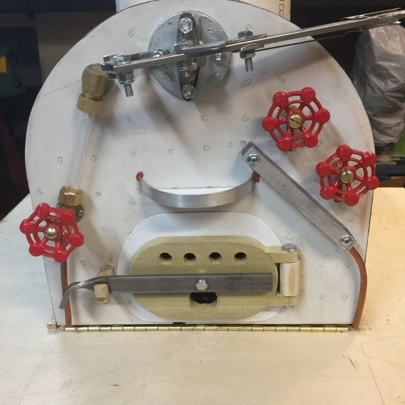

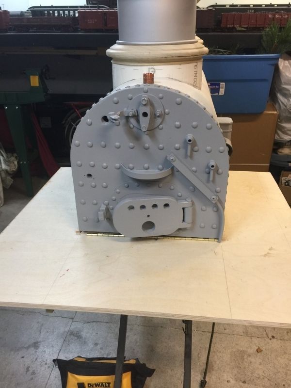

Well took a siding in my progress. The firebox door really bothered me. I keep thinking of boiler in the basement of some horror movie. I looked up some more back heads and found some that had a rounded portion of steel behind the door so I did that to hide the rectangle tin box.Added some more crazy eyes for rivets.
I checked the firebox fire and it actually looks better this way. Will do another video later.

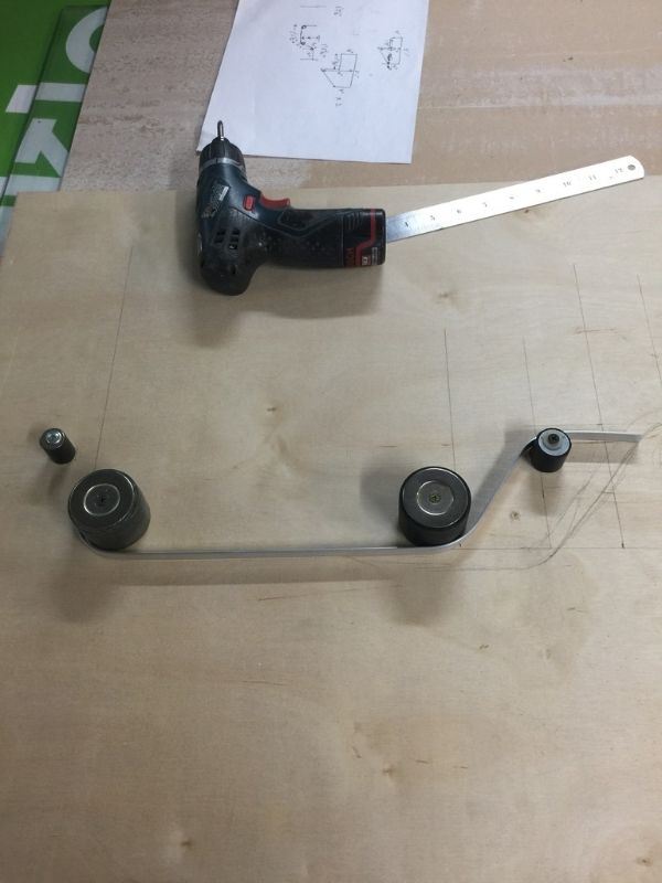

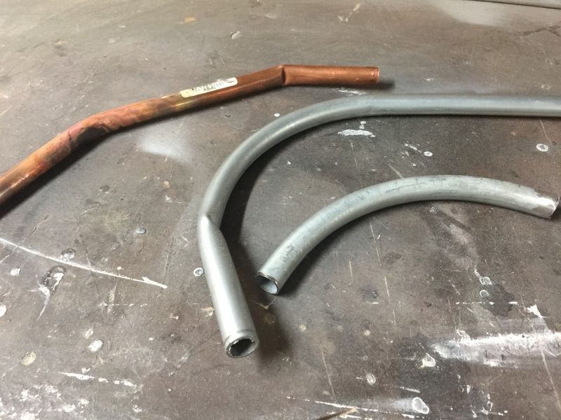

Ok, back on track. I have been trying to think of a way to bend brass tubing for the injectors and sand lines. Off for my 3000th trip to Lowes, you might want to buy stock the rate I'm going. I picked up a conduit bender and a couple of pieces of conduit. Welllllll, Not good! the bend is not sharp enough for what I need and when I tried to fudge it, Kink city. So I tried copper with heat, kinky again. Here are the fruits of my labor. Maybe a little Bondo? LOL I will be returning the 45 dollar bender, what a waste.

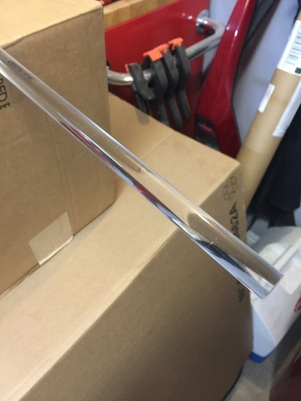

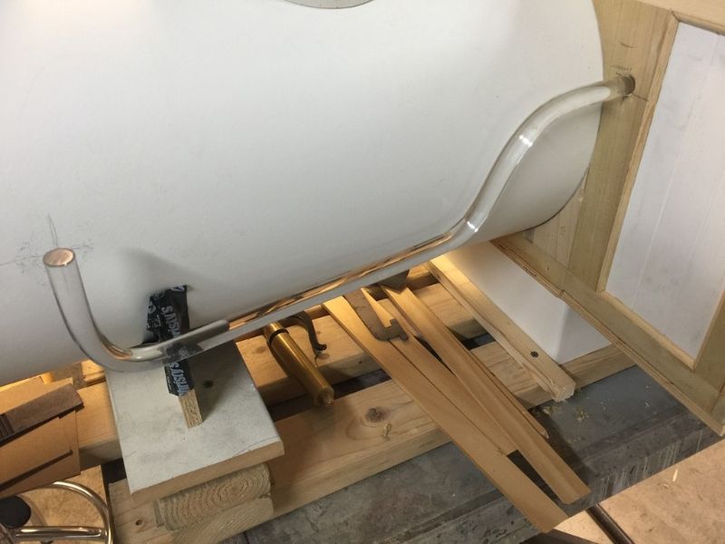

Well I sure wasn't going to invest in Brass tubing and destroy it also so I had to rethink the material. I remembered back in Junior High, believe me that is not something I really want to remember but, I took a plastics class. In the class we messed around with acrylic. I thought I remembered something about bending with heat so I looked it up. Sure enough you can do it really easily. So for my next experiment I decided to try and bend acrylic and then just paint it. I purchased some 5/8" rod, made a jig, stuck the rod in the oven at about 400* waited until it started to bend down then quickly pulled it out and placed in the jig. I felt like I was in a baking contest with perfect results the first time. Here are some pics of the plastic the jig and the finished rod. Not painted yet, going to wait until all is done. Oh and my wife doesn't know I used her oven so mums the word.
