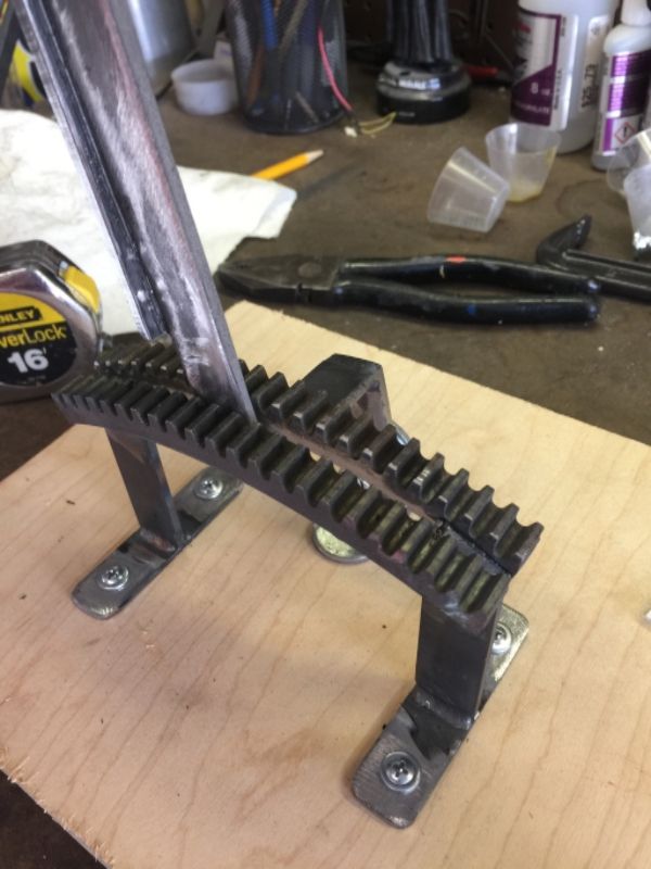

I found some 3" scale rail in Oxnard CA. It is 1 1/2" tall. Perfect height. For testing I will just use wood until I can save up enough for the rail. I was going to use steel bar stock thinking it would be cheaper but the price is about the same as the aluminum rail.
Ok now for a public service announcement. MAKE SURE YOU ARE HOLDING TIGHT TO THE GRINDER WHEN TURNING IT ON!!!!......ooops, almost a Hara Kiri.

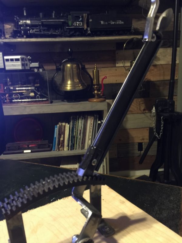

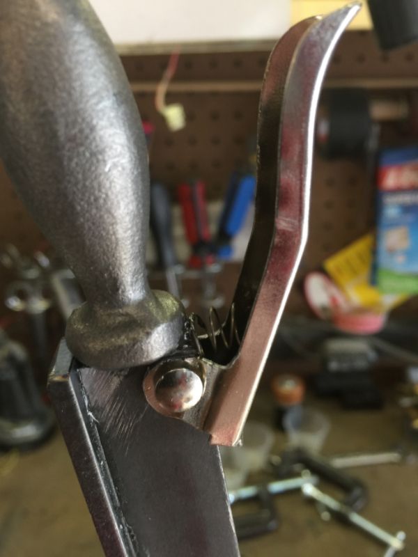

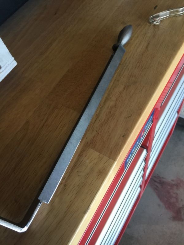

I have pretty much finished the cutting and welding for a bit. Last metal project for the engine will be the johnson bar. Remember the flywheel ring gear earlier? with a little cutting, bending, welding and JB welding I have a johnson bar. I mocked it up on scrap wood. I will be wiring and hiding micro switches for the forward and reverse switches. The knob is form a crank for something. Used one on the throttle also.
Posted - 02/27/2017 :  11:51:52 AM  Show Profile  Visit Frank Palmer's Homepage  Reply with Quote
Mr. Johnson would be proud!

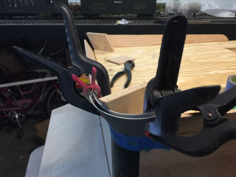

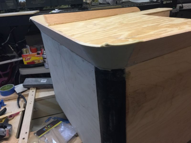

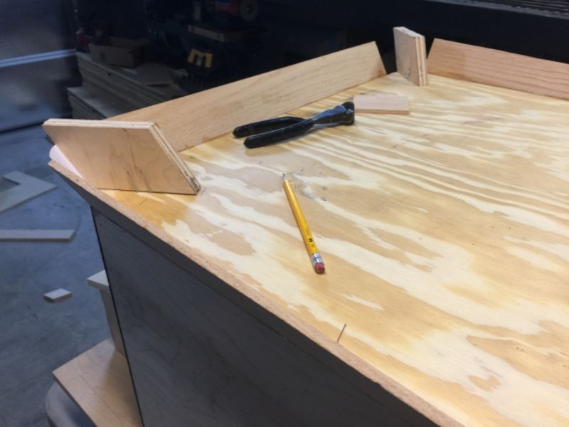

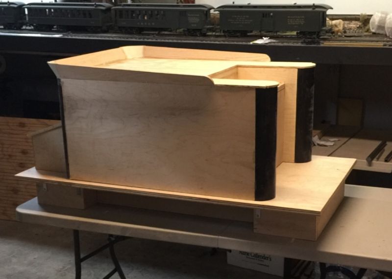

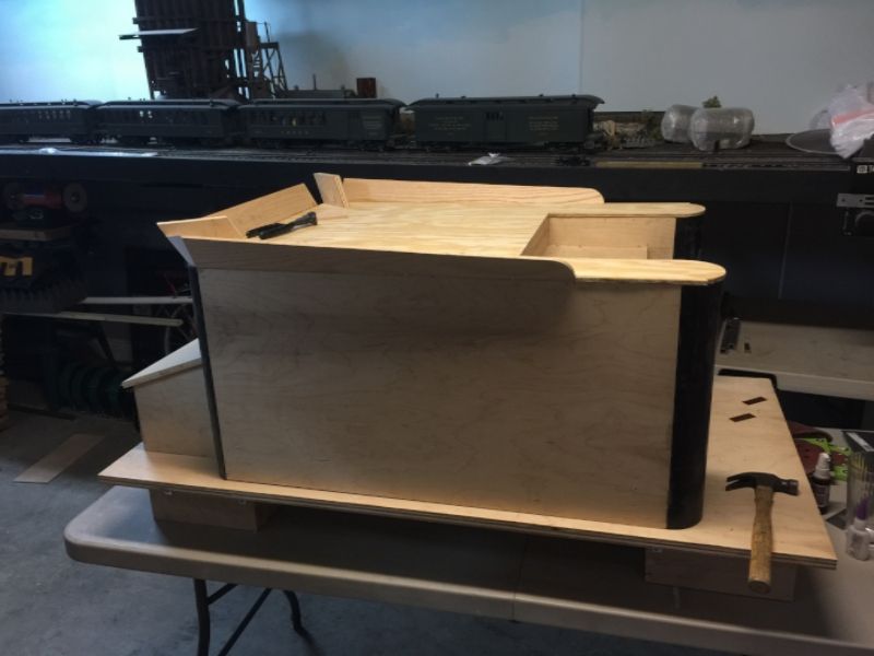

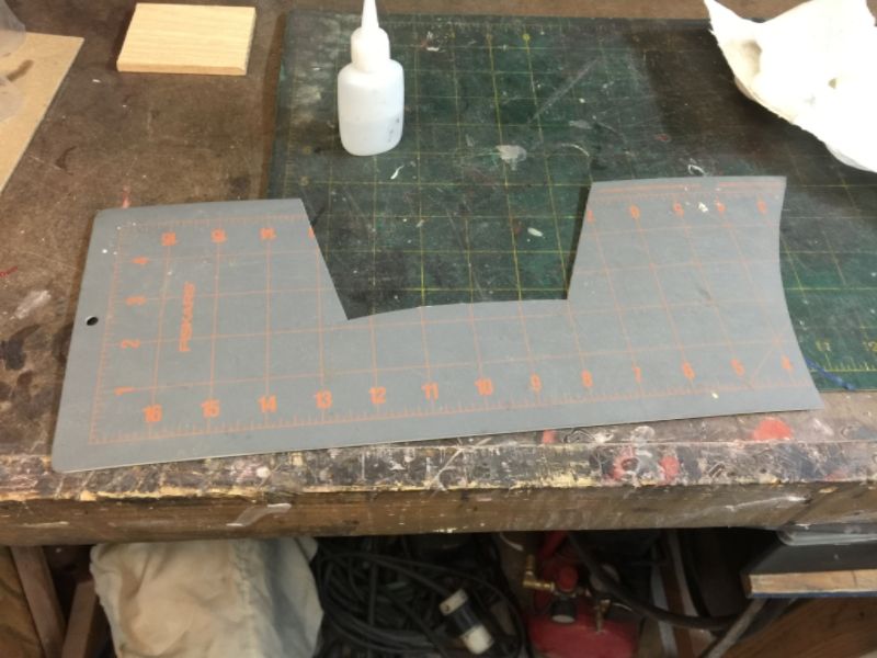

Went out in the garage AKA Bill's Creative lab, to figure out how to do the tender flare. While looking at the tender something was bugging me. I went back to the drawing and realized that I had made the tender 1 inch too tall. You might say, Really? Yes it's one of those things that bug me like crocked pictures. For some reason I have a built in level and size perspective. I measured the picture and didn't take into account the base and subtract it. Well that put a damper on the evening. As I pondered how I was going to take an inch off without screwing up the level and the corners I decided I would use a level as a guide for the saw. It worked great until I got to corners were the old hand saw came out to finish. Problem solved now back to the flare. I decided to use Oak because of its strong qualities. I am going to cover with fiberglass anyway so it didn't matter about the grain. I found some 1/4" oak strips at Lowe's. First I placed a piece of 1/4 ply on the top leaving it a little long on the edges that didn't have the flare. Where the flare was going the board is in a 1/4" I glued and pin nailed (my new favorite tool) the flare at an angle using angled blocks of wood to make sure they were all the same. What to do with the corners. I was thinking of making a pattern with paper then using several layers of plastic. Then it hit me, why not make them out of resin. I found a sewing cutting pad my wife had, she won't know, What do you think?
I cut it to wrap around both inner and outer sides of the curve. Mixed up some resin and poured. What the hech, the resin is disappearing. Oh crap forgot to seal it up really good at the bottom. As I watched the resin disappear I could only imagine where it was going. finally it set enough to stop on the bottom so I finished topping it off. Once dry I went looking for the resin. It had puddled in the corner at the bottom attaching the tender to the floor. Man that stuff really sticks to wood when you don't want it. I finally got it free what a mess. On the next one I sealed up really good with hot glue, no problems. Still need to sand them off but pretty good results.

Posted - 02/28/2017 :  10:28:16 PM  Show Profile  Reply with Quote
Pure genius! I think you nailed it. Or should I say 'glued it'? Either way, it looks great.
As for the few boo-boo's, at least we know your human and make mistakes now and then!

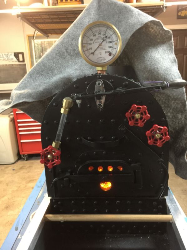

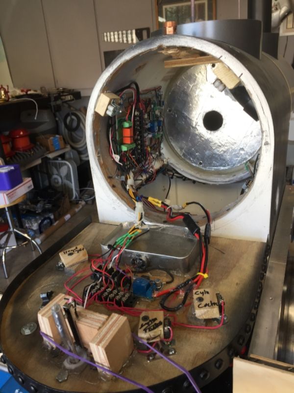

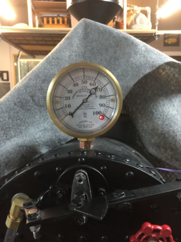

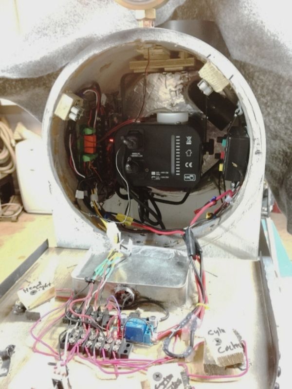

Well not much fun stuff to report this time unless you think of wiring as fun. Finished the locomotive electrical. Sound, wiring, voltage regulators, relays and sensors. And with a little bit of thought and magic, steam cocks that dump steam along with synced sound and a simplified smoke puff out of the stack. It was late at night with garage door closed, couldn't see anything but smoke. I'll post a video once I finished painting the cab and frame and it's all put back together. oh and there is a red blinking light in the gauge that tells me when the smoke fluid is low
Posted - 03/13/2017 :  5:59:32 PM  Show Profile  Visit Frank Palmer's Homepage  Reply with Quote
Yep, looks UL approved to me. All fired up and no place to go!
Country: USA | Posts: 4389 Go to Top of Page
Posted - 03/14/2017 :  1:44:10 PM  Show Profile  Reply with Quote
Whoa, he's not only a mechanical genius, but an electronics wizard too? And what is that, a real fire in the fire box??? Looks good!

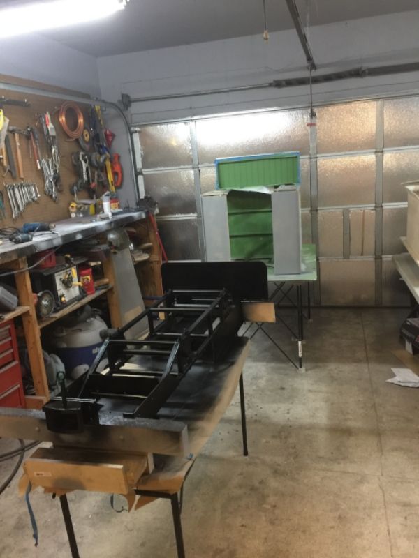

The garage is now a paint shop. The two things I really hate, body work and weight loss.
