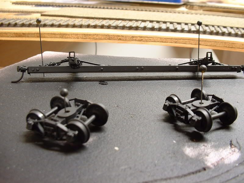

Next, I pin the trucks and the frame to a piece of foam.
This way I can move it in any direction and not worry about
dropping or losing anything.
Now paint everything Flat Black. I use an air brush and either Pollyscale or Modelmaster paint for this.

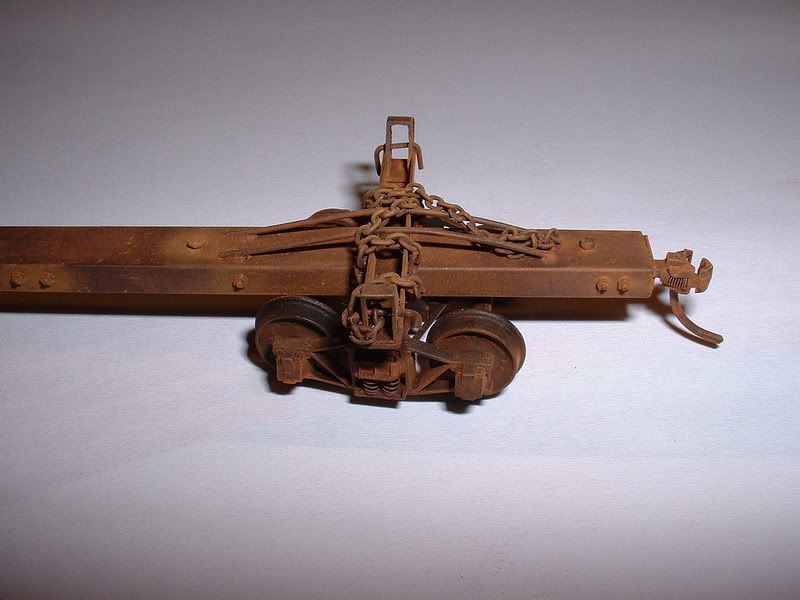

Here only the center frame is done to show the effect.

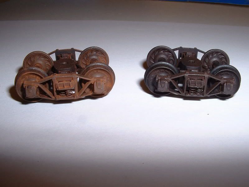

Here's a pic of the trucks before and after the first powdering.

Here's a shot with the center done.
Here are the trucks, the one on the right has the Dark rust and dull coat, the left is the same only it has the next coat of Medium Rust applied.

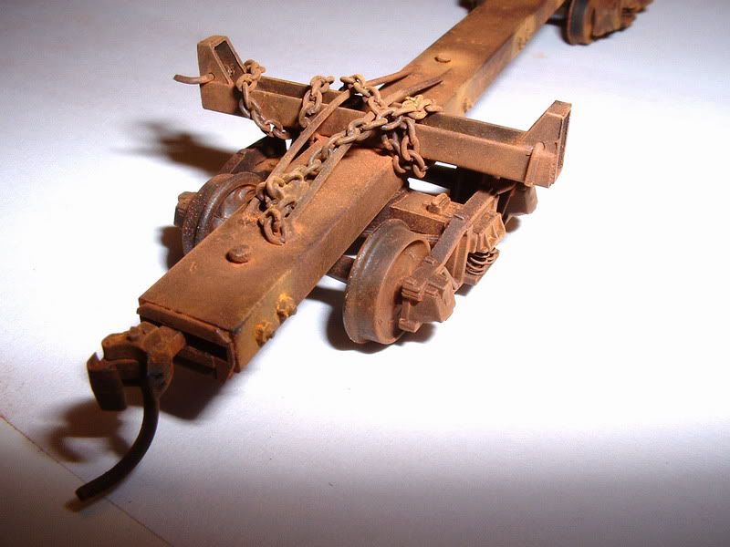

Here you see one of the trucks with the Light Rust on the left side only. Light rust has also been dabbed onto the NBW's and nail heads here, and brushed onto the chain.
I don't Dull Cote at the end because, as I have said, it really grabs the powders after the one coat. As you handle the car, some of the color will wear down a tiny bit, and, I think, it looks even better. If you like the stronger color, it is nothing to just tap a little more on later.

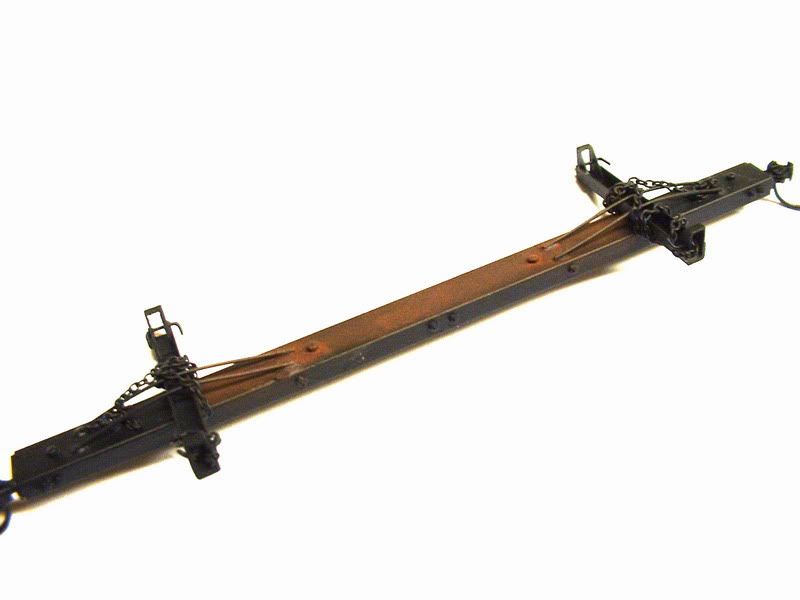

First I go over the entire car body top and bottom with the Dark Rust powder.
Don't forget to do the trucks too!

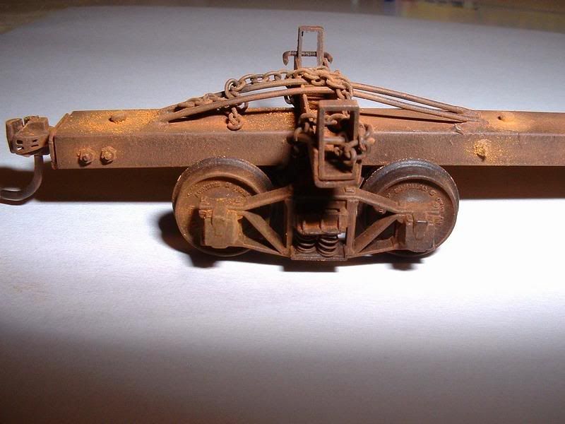

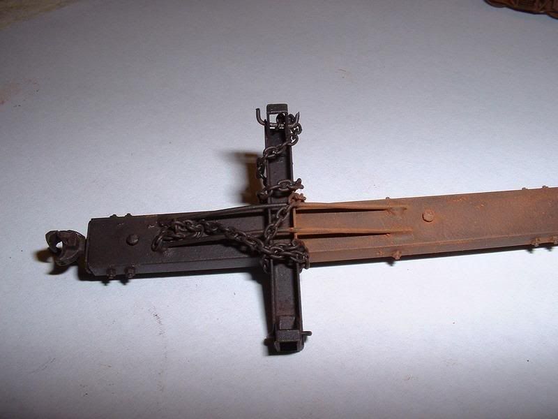

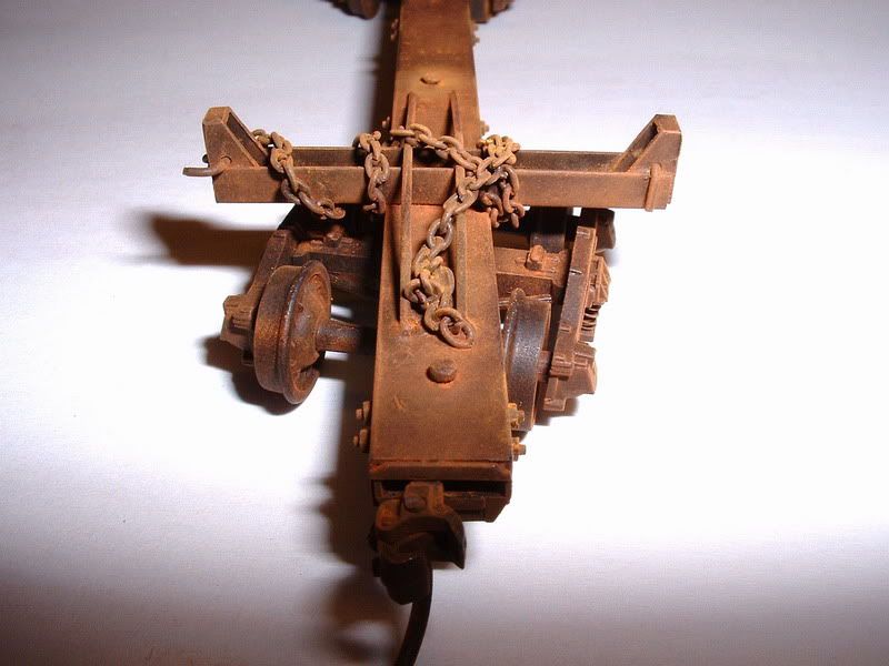

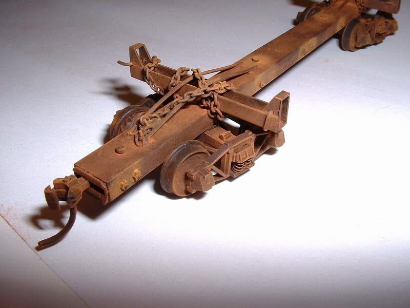

Go over the whole thing with the Medium Rust powder. When you apply the powder around the NBW, and the chain and log bunks, use a jabbing motion with the brush. Kind of like a birds head, when its pecking at the ground for seed. This will push the powder into the nooks.
