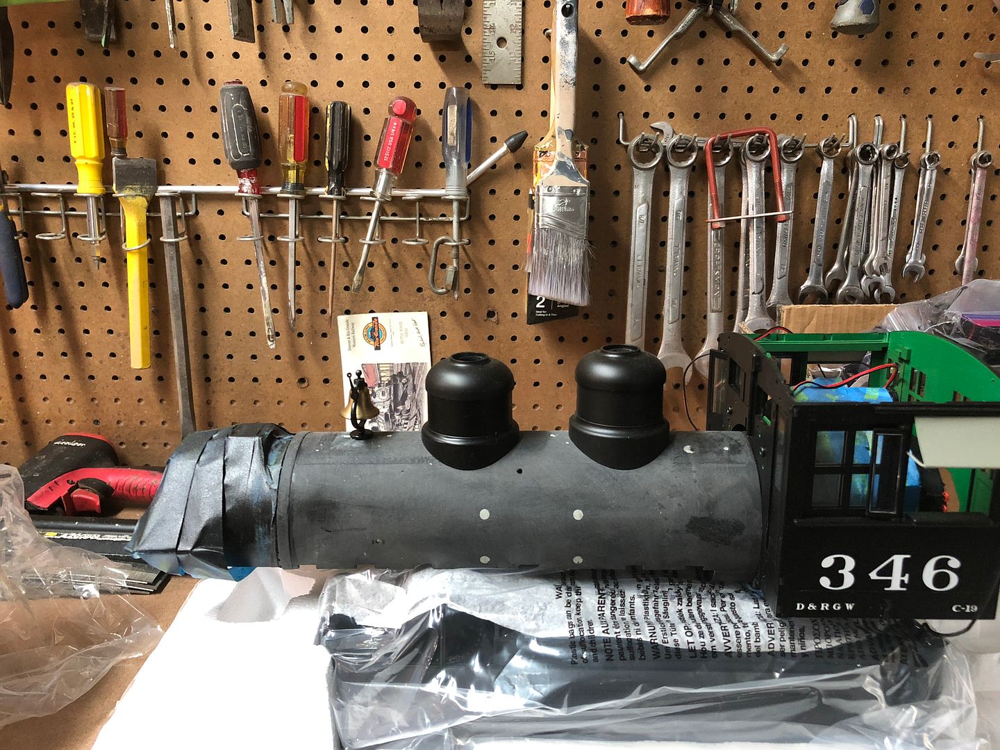

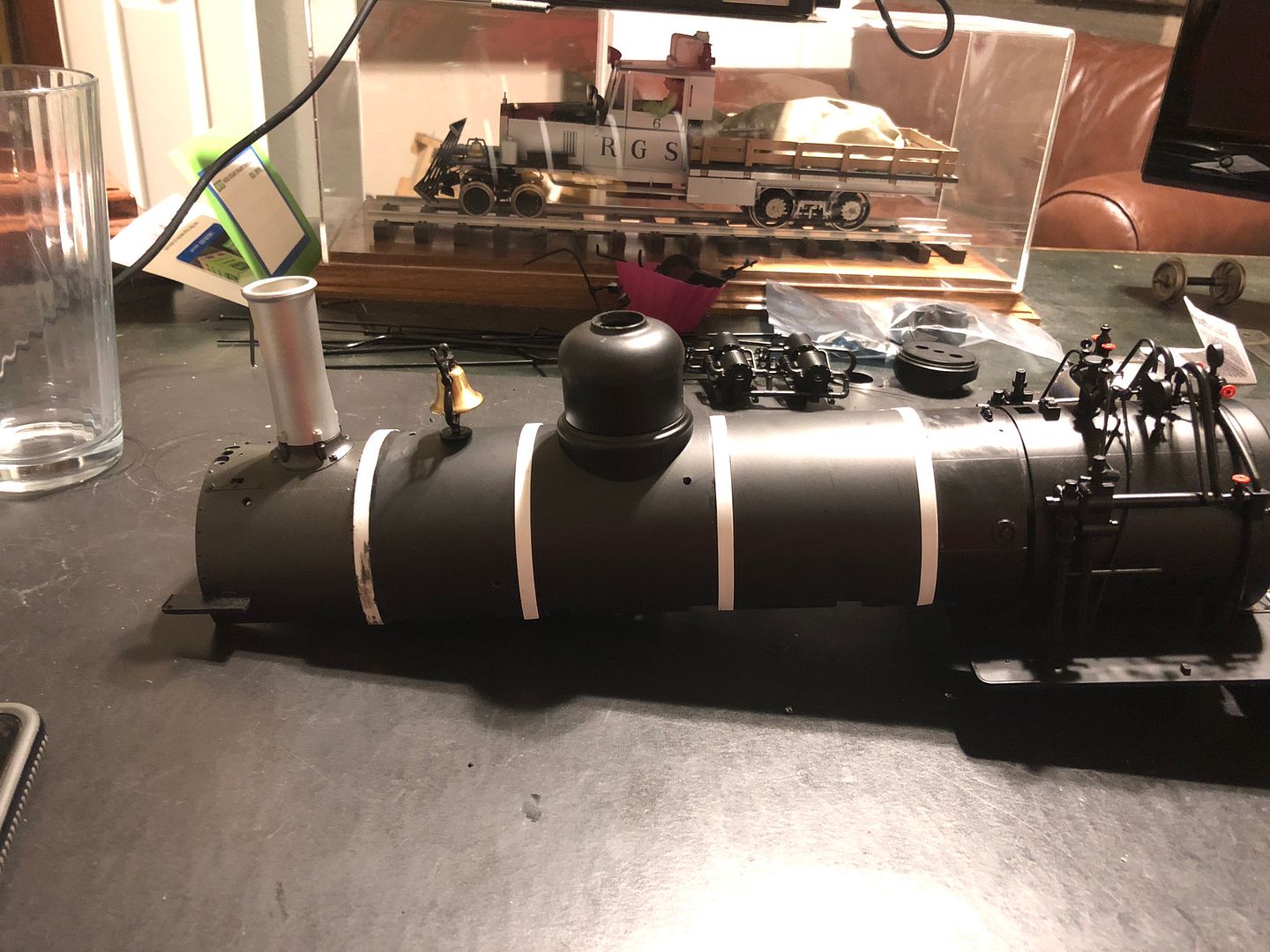

    Well I'm back after 2 years of pain, ride on engine build and back surgery.Im starting with a undecorated Bachmann C-19. First was the boiler. I sanded and fill all the bands and holes then covered the boiler in a wrap of plastic and plastic bands. Don't mind the cab, It was from an extra boiler will use the correct metal one.
    The domes where from a mix of Connie and C-19 to get the right size and height
