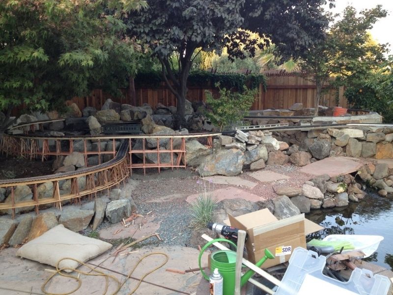

    My friend down the block started a renovation of his Garden Railroad and asked me to help with building some bridges. little did I know it turned out to be a total of 75 Plus feet of trestles. I wanted to try something new this time so I opted to use Split Jaw PVC road bed. First I made a template then started cutting Redwood fence boards down. I think my neighbors are glad that part is done. On each bent I added to the top a 1/2 inch block so that when finished I could put a venire of red wood over the PVC roadbed to hide it. I also cut ties to slip in between the stock track ties to make a wider more appealing look. The curved trestles were first with a grade of 3%.

            I was impressed when I saw the picture of the curved trestle in the first picture, then I started scrolling down and saw the other pictures of your bridges and I was blown away. That's some very beautiful work. :up:

                      Wow, nice work! You must really crank out those trestle bents, to get so many done in what appears to be a short time span.

                          All I can say is ambitious. What method are you using to anchor the bent bases? And are you building the bents one-off for a specific location or are there runs where they are the same height? 'Gotta love those koi ponds, mine is my little bit of relaxation. Just curious.
