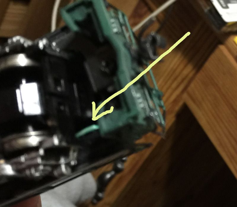

    I'm late here, but if it is an Atlas RS-3 follow these steps;
    1. Remove the bottom handrail (the one that is attached to the cab and frame where the crew enters the cab). Just remove the bottom part of this handrail. Leave the top part of the handrail in place on the cab.
    2. Repeat Step 1 for the other handrail at the back of the cab.
    3. The final handrail that must be removed from the cab is the straight handrail that enters the cab from the long hood.
    4. Remove the cab first. Hold the frame with one hand. Using the thumb and one finger of the other hand, hold one side of the cab at the bottom of its front and rear walls. Pull the bottom of the cab on this side outwards just enough to clear the tabs of the cab from the tabs on the frame.
    5. Repeat step 3 for the other side of the cab. Once both sides are clear, the cab can be removed.
    6. The long hood has a tab on the bottom of the front nose. Be careful that you don’t break this tab. Hold the bottom of the frame with one hand, and lift up with your pointer finger at the back end of the long hood. Be careful that the handrails don’t break while you are doing this step.
    I may not be any help to you, but for the speaker in my Atlas RS-3, I cut out the exhaust hole from the shell and installed a Detail Associates HO #229-2702 Air Grill. Drilled a 3/4" hole into the top of the locomotive weight and dropped in a Soundtraxx 3/4" speaker.
    The sound is great. I tried the speaker with face down into the hole and face up. Both ways seemed to sound the same. Ever since MRC started mounting their speakers face down into the speaker boxes, I always test both methods on my installs. This RS-3 install I went with the speaker face up. As you know, as long as the speaker pressure is less on one end, the sound will work just fine on the opposite end of the speaker.

  • BurleyJim
    started a topic Atlas/Kato RS3
    Atlas/Kato RS3
    Anybody remember how to remove the shell on this one? I'd like to drop a decoder in this rascal, but the shell is a little persnickety.
