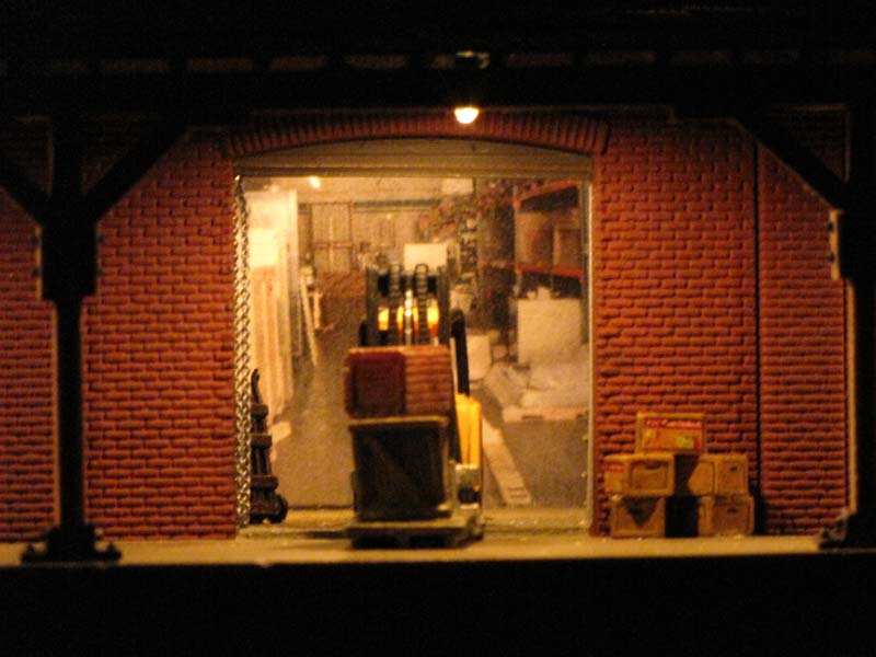

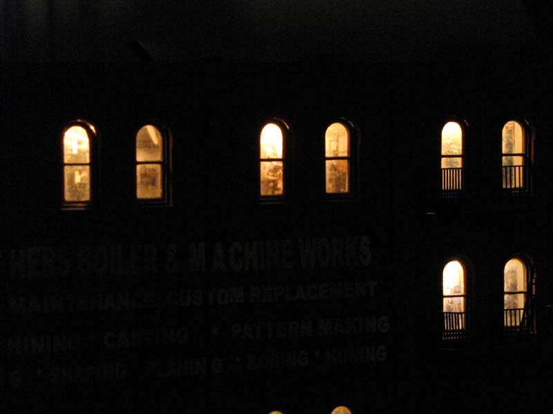

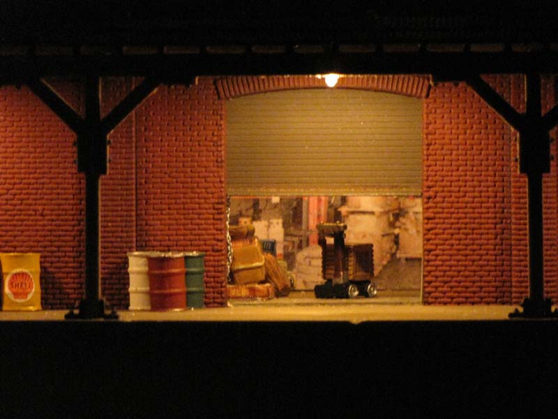

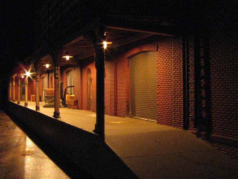

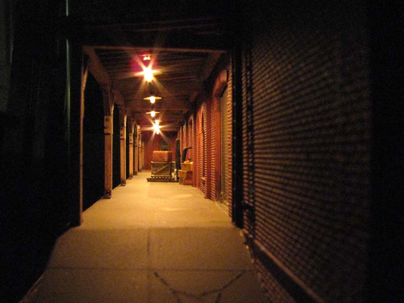

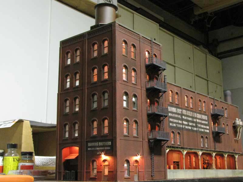

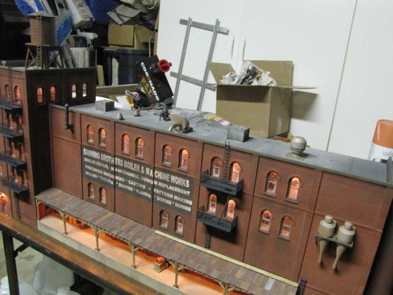

    Here's an HO scale building I made a few months back. It was built primarily from a DPM Designer Bulk Pack of wall sections and windows. As it sits against the backdrop, the rear wall is just Plastruct 0.100" ABS solid sheeting.
    It was named for a buddy of mine in Vegas - Jesse Banning - who owns a shop dedicated to building 7-1/2" gauge ride-on locomotives, and who built the welded steel boiler for my 1/8th scale coal fired 4-4-0.
    Each door has a 1.5" deep styrene shadowbox behind it with a printed photo on the back wall. Each window has a similar shadowbox, but only about 0.75" deep. Photos were culled from the Internet of actual machine shop interiors, so there are milling machines, lathes, drill presses, raw material racks, etc.

                Thanks for the replies. First time I tried the shadow boxes. I really like how they turned out. There will be more of them in future buildings.

                            One question....with the shadowboxes, how did you do the lighting? Is there an LED for each window/door or is the shadowbox open at the top?
