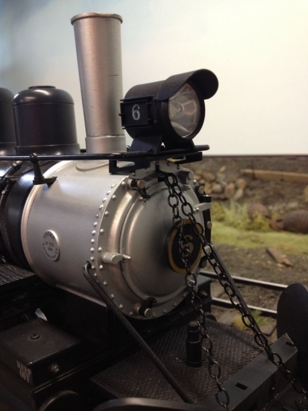

    I replaced the smoke stack and found a Bear Trap arrestor on e-bay and will put that on once it makes it across the pond from Germany.

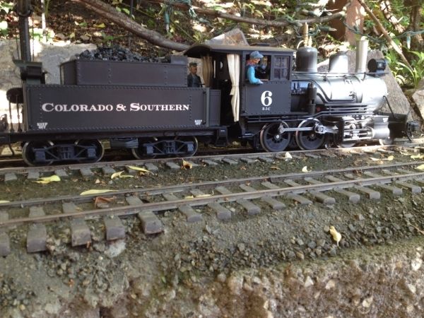

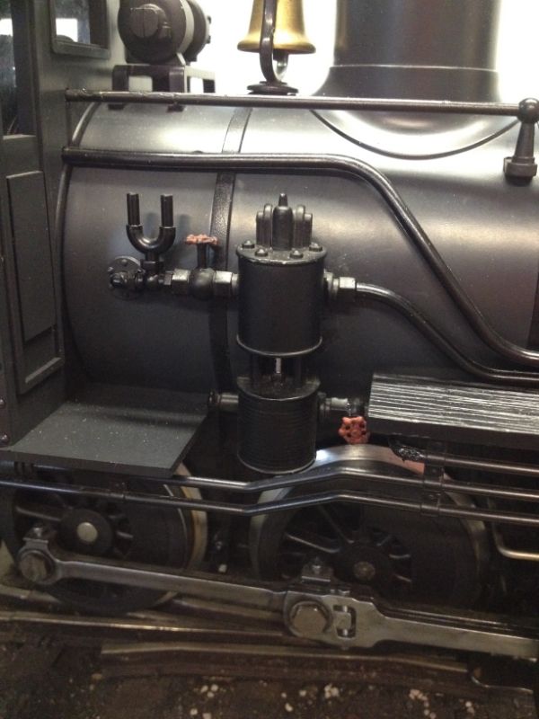

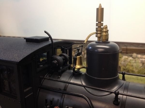

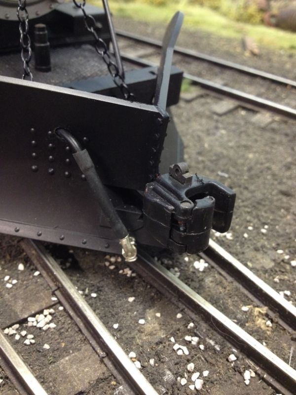

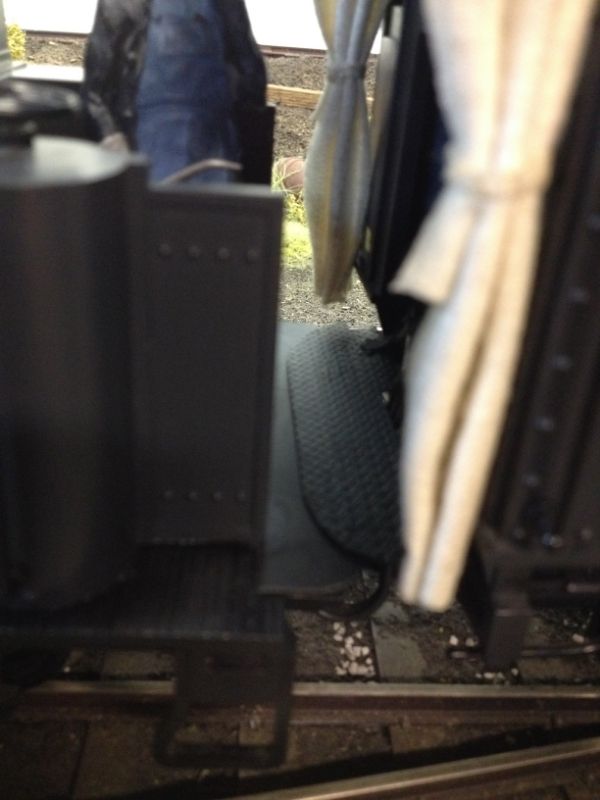

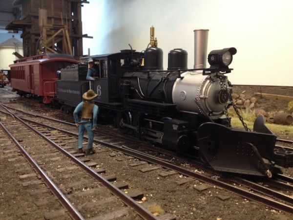

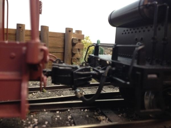

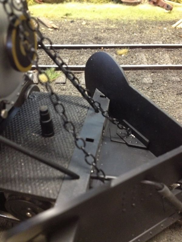

    Replaced the air compressor, the pop valves, whistle, generator, number plate and Bell. I had forgotten that the plow is attached to the lead truck to make tight turns so at first I couldn't figure how it was suppose to be attached. Out came the dremel, a cut here and there plus the removal of the cow catcher leaving the pilot beam then another cut here and there on the pilot beam and it fit. The addition of an accucraft coupler and air hose with glad hand finished it off.
    The brass hand rails, boiler bands and the numerous gold plated plastic wheels and levers all over the place had to go. I painted the handrails and bands, removed all the toy looking gold. I painted the arm rest pad along with the outer rim on all the wheels. I dirtied up the rods with ink and alcohol wash to give it a more metal look. The bright orange yellow re-railer was given a coat of black paint and will probably get silver, haven't decided yet. A real coal load in the tender along with the addition of tender to engine plate. I found I could bend the wires down and through the horn loop coupler on the tender and still negotiate my turns.
    Added some figures and I am pretty happy with the results. Now it can join the rest of the roster. If I ever get enough nerve, I'll weather my locos.

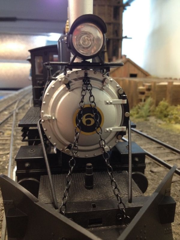

            The smoke stack was missing and the tender had lost its coal bunkers somewhere down the line. I found a flare top off one of a battery powered loco. I striped it down and repainted it made new domes using a K-27 sand dome and a brass replacement steam dome made for the mogul some years ago. I added an air tank form PVC pipe, new compressor, bell, number board whistle, pop valves and classification lights form my scrap box. I used the Connie tool boxes and added extension boards for the coal load. Off course new engineer and fireman. I found the C&S logo and used Microsoft Publisher to make the words around the logo to match the original. Sent the file to Stan Cedarleaf to make some white decals. The smoke stack turned out to be a piece of curtain rod and the Bear trap was made form scrap using sprinkler pieces along with an O gauge C-16 smoke stack bottom and styrene. The pipe for the Bear Trap was made with aluminum tubing that I filled with salt and caped both ends to bend with out kinking.
            finished it off with new couplers, air hoses and Glad hands.

                I'm fascinated how much better the original Mogul looks with that large head light! Could you please tell me the part number for one of those lamps?
