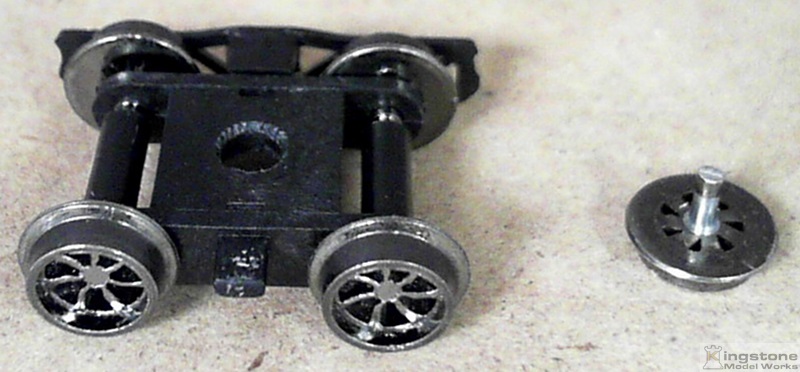

      Excellent points James. What would really be helpful is a close up in focus picture of the bottom or drivetrain.
      If you are going to go with a 30" gauge instead of a 36" gauge I would suggest looking at N scale wheels for replacement. You can also measure the axle diameter and get some brass or steel rod. Press the wheels off and press them on the new axle rod. The missing wheels could be replaced by using N scale wheels.

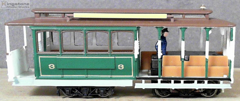

          May have a solution for your wheel problem. It will require getting a Bachmann HO scale trolley/cable car item number 60531.
          It looks like the wheels sets would be a close match. You would need somebody with a lathe at the most to make new axles. You will also need to drill a hole in the wheels to mount on an axle. You could also narrow the trolley/cable car truck to fit HOn3 gauge. That might work better.

            Thanks Bernd and these wheels are 7mm ? they are a close match.
            I have found some flat disc wheels that in N scale that will do the job (for now) and I also found some axles that will work for the rear truck.
