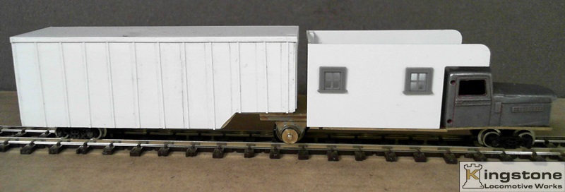

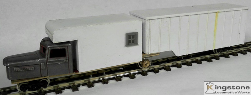

      One minor problem. This truck wouldn't fit on the tracks, more like between the tracks at a 30" gauge.
      Got a bit more done. Got the box altogether and some windows installed.
      A quick check to see if I got the width correct.
      More sides added. Back and front. Not visible in this picture.
      Completed box.
      I didn't like the small window panes, so I cut them out. I'll post that in the next set of pictures. Got to allow the glue to harden first and then I'll add a bit more detail.
      • #48
        I like it better with less windows as well. I think a solid window, no panes would be even better.
        Just my IMHO.....nice unit though. You sure gave it a lot of thought though....When I give a build too much thought, I wind up screwing it up.....[:-dunce]

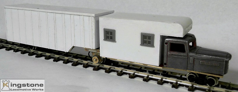

        • #49
          Your right Ted. It does look better with those tiny panes removed.

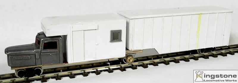

          A work in progress. Added a sliding side door. I'm going to have to paint this with a coat of primer so it's easier to see.
          That's it for todays work (play).
          • #50
            It is looking very good. Like the door. and the window is more realistic....Good work/play, Bernd..

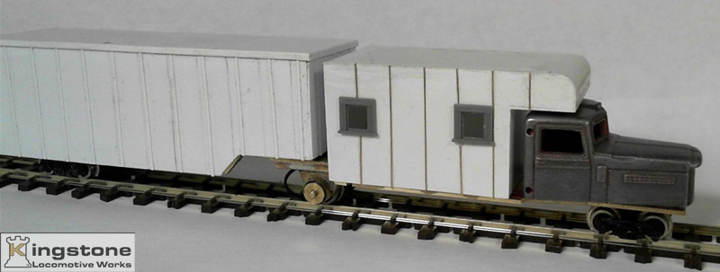

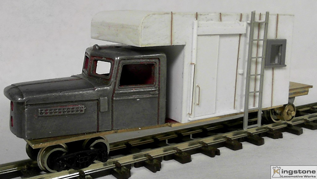

                  A bit of an up-date. Starting to add details.
                  In order to make it look like panel side on the truck body I scribed lines two feet apart and then glued in .008 phosphor bronze wire with acc. Hopefully this will give a raised seam look after painting. Plus I cut out the little pains in the windows.
                  Added .008" phosphor bronze wire as for a door handle (The boys in the shop are going to get yelled at for mounting it crooked)and handrail. Added a ladder to get to the roof. Still need steps and a few other things.
                  Until next time.
                  • #54
                    I can't tell it's crooked......Once painted, you'll never know it.....What's next????

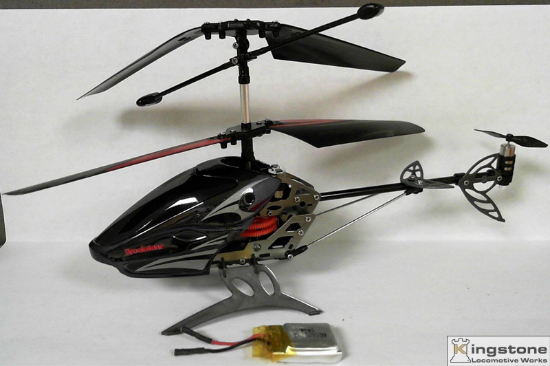

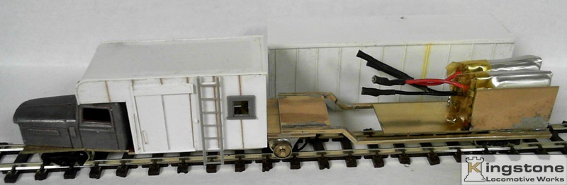

                                My rail-truck project has been setting kind of idle for a while. I figured while I'm waiting for some raw stock to be delivered from a metal vendor for the "2015 Challenge" I'd work on the truck. I'm going to power it with two LiPo batteries out of one of those infrared remote controlled helicopters using a DelTang radio receiver for trains.
                                I made a battery box to hold the two batteries and fastened it to the trailer part of the rail-truck.
                                Here's one of those fly toys with the battery removed.
                                It's 3.7 volt. I'm thinking it's somewhere in the neighborhood of 250 milliamp hours. I'm going to use two in series for a total voltage of 7.4 volts. The motor that powers the truck is a 6 volt motor. It'll work since the motor won't get the full 7.4 volts from the battery.
                                Next I need to make a terminal strip to plug in the batteries and the receiver, which still needs to be ordered.
