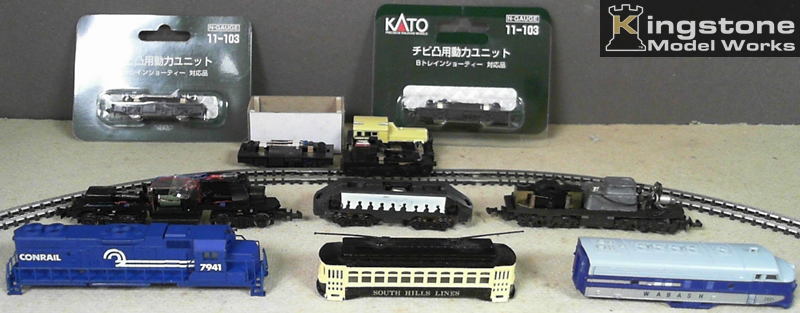

                    Here's what I have available to me at the moment. I did some quick hacking on the modern truck cab. It was a dump truck. It's to modern but it gives me some ideas.
                    Front row from left to right. Bachman GP38 (I think), Bachman trolley, and a Lima F7. The chassis' are behind the shells.
                    Next row back. Three Kato 11-103 4 axle power units. They are going to be used to make three brass electric box cabs. And the WTD Plymouth switcher. It's not a good runner.

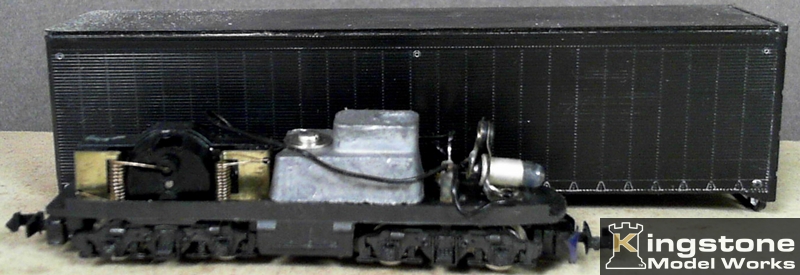

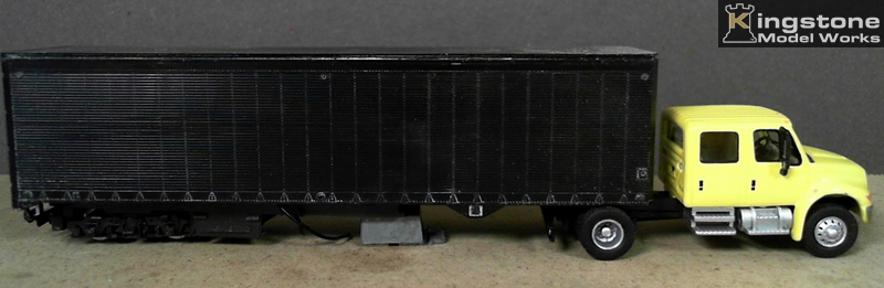

                    This is a 40 foot truck trailer and the Lima power unit. Notice it has only one truck powered using a clock work motor. Runs pretty good. Needs some clean up though.

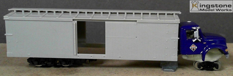

                    I place the Lima power unit under the truck trailer and started to deconstruct an Athearn dump truck just for a visual.

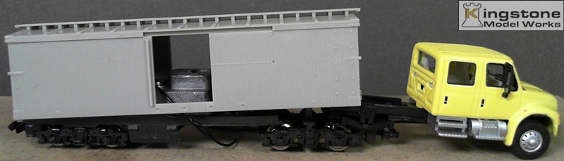

                    This is a Rail Line HOn3 boxcar. Getting close.

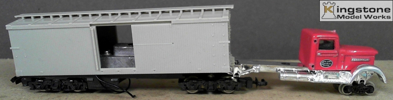

                    Didn't look to good with that truck axle so I removed the truck axle and replaced it with the dummy truck from the Lima power unit.

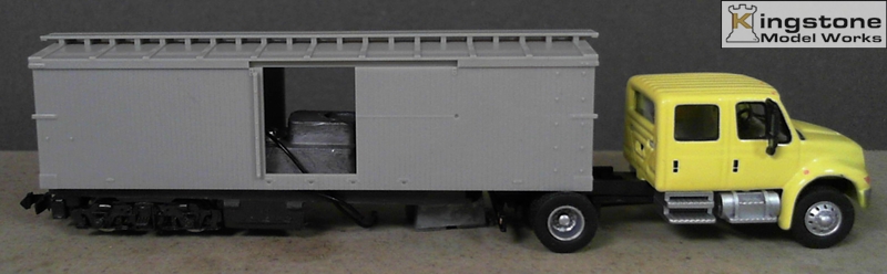

                    I tried it with the 40 foot truck trail and the dummy power unit. Ahhh, no cigar.
                    Deconstructed another Athearn truck for the cab. Used N scale trucks under the front. Definitely no cigar.
                    The one I like the best is this one.

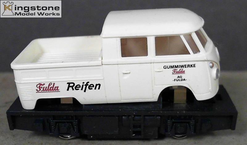

                        Had to test out my VW crew cab bus. Don't think it'll work with this one.

                          I just happened to look up on a shelf in the shop. What stared me in the face but 6 trucks I picked up a while ago that I wanted to do some railtrucks with. So the first one is a bit to long.
                          And I have my cigar.
                          Next step, start trimming up all the parts for a nice fit.
