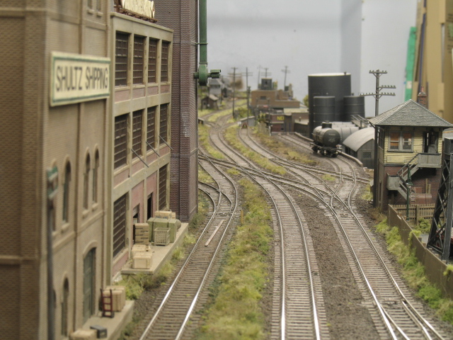

    I started putting the ballast down last night. There is still some tidying up to do with a small soft brush around the turnouts before I can spray on the IPA and add the glue with an eyedropper.

          The ballast is now glued down (with WS scenic glue and an eye-dropper, after spraying with Servisol- IPA)
          I then spray-painted both the ballast and the track with a brown/grey mix, after which I drybrushed the ties with 'tie brown'.
          Now to paint the rail edges.

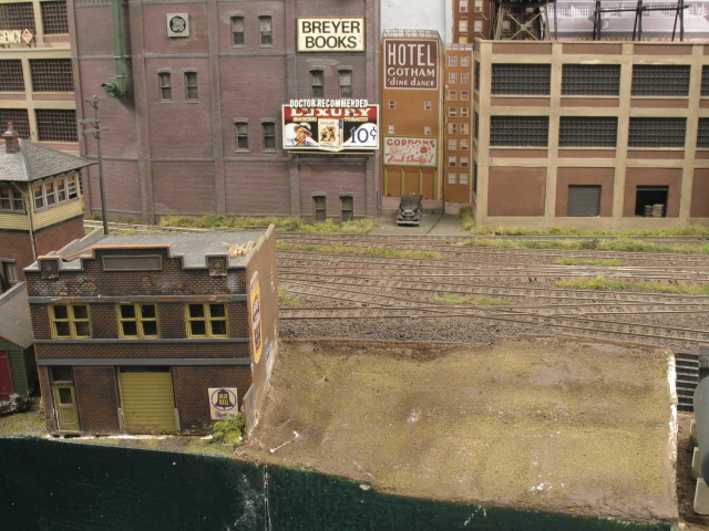

              I've started repairing the scenery that was ripped up in the track realignment and am progressing slowly(for me). I'll be doing some before-and-after photos when the work in done, so be patient.
              First up is the area near the scrap yard. It now includes a Bar Mills house and a rainwater run-off and the area will be heavily overgrown.
              Next up is the area that had been a grade crossing, with the taxicab garage. The crossing has gone and the area is due to be a car salvage/repair lot.
              I intended to build trestles for the tank car track but time was against me, so I plumped for industrial arches to carry the track.
              The tanks themselves have all been repainted black and will be repositioned once the arches have been repainted.

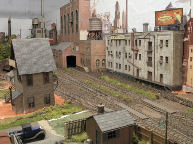

                The team track is almost complete having had the fence re-erected and a new crane ready for installation
                While everything was progressing nicely, I thought I'd do one last piece of demolition work and reduced the size of the power station so I could increase the white warehouse to accommodate 2 freight cars at once.
                So, to finish up, here are a couple of overall views showing the progress so far.

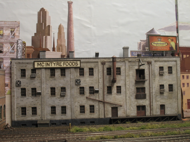

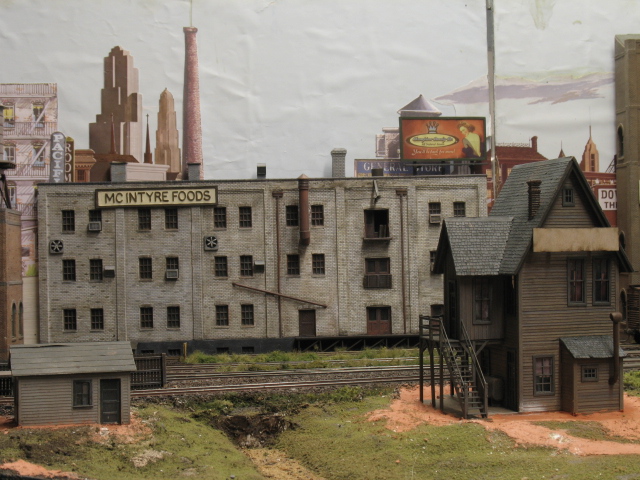

                            I have been working on extending one of the industries to accommodate at least 2 freight cars, and building up the scenery at the front. The old building at the front is a Bar Mills kit.
                            Now for some trees and bushes
