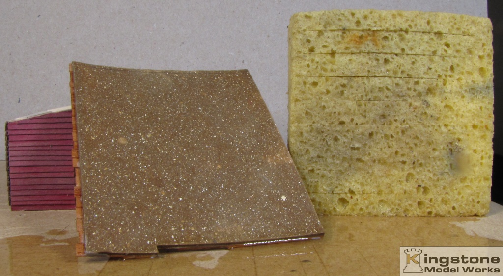

      Finally after two weeks I've got the shed roof shingled. Of course a problem had to rear it's ugly head, it's call Warpage.

      What to do? Well, I wet it down good.
      Click image for larger version

      I guess when I glue the roof down I'll have to squeeze the excrement out of it again.
      Looking to do the rest of the building's roof with a different sub-roof. Maybe plastic and use ACC to glue the shingles down. That's the update up to now.

        I know you didn't ask for advice, but if I may make a couple of suggestions. . .
        1. I think most of us attach the subroof to the structure before applying shingles. If glued down well, the subroof does not warp as you experienced.
        2. You need good glue surfaces to attach the subroof to the walls. The top edges of the walls are often not enough. Gluing stripwood along the edges of the side walls will help. Also, you can run stripwood near the top and bottom of the roof area parallel to the other two sides. Hard to explain but you get the picture, I hope. You can see what I did on my current depot project. ( https://railroad-line.com/node/40211/page36#post1032701 ) I might be adding more bracing along the lower edge for glue surfaces.

          Thanks Mike.
          I always like advice and don't mind getting it. Here are some better pictures of the roof project on the sheds. I did brace them with 1/4" square lumber.

          The reason I didn't glue the sub-roof down first was for the ease of being able to apply the individual shingles easier. Guess I'll have to take the not so easy route and glue down the sub-roof on the main building. I'll add some more bracing also.

            Yes, shingling is very awkward when the subroof is already in place.

            Bernd, a suggestion: Can you lightly mist the underside of the roof and then put it under weights to dry and hopefully de-warp?
              Dave,
              That's what I did to get it to the less warped state in the picture. I'll clamp back down when I glue in place.
              • #69
