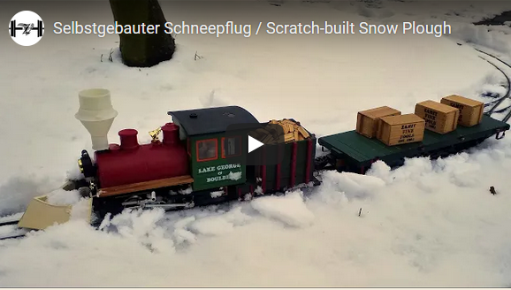

And now, I'm finally ready to go. Since it's just above freezing point, the snow is already quite sticky. On the one hand this leads to a nice effect when the snow is split and ploughed up, on the other hand the wet snow puts up quite a lot of resistance which the loco can only just cope with.
(Click the picture above to go to Youtube: https://youtu.be/Of-ZgAAUe6g)
Fortunately the track is negotiable right away, no frogs have to be cleared from ice afterwards. And with the battery-powered loco, I don't have to worry myself with dirty tracks. So the flatcar is quickly picked from the store and attached to the loco.
Underway on the cleared track with the flatcar.
