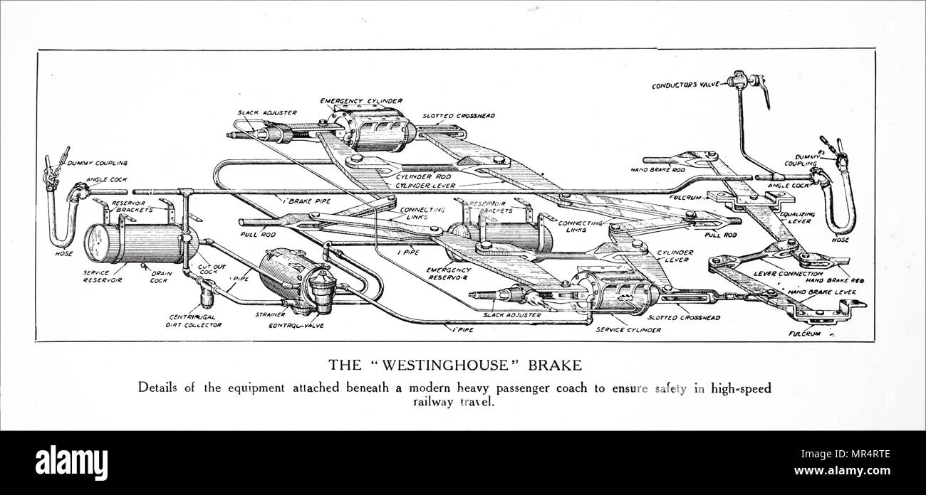

Now in 1900-1930, the Westinghouse K series was pretty common. This diagram shows Westinghouse brakes for a passenger car, but it's a good image overall to show the parts of a brake system.
Now one problem you have for -working- brakes on a model is that a lot of the components of an air brake system will not be of any use. In O Scale, Bernard Kempinski has done brakes for his American Civil War (1860s) era cars. See https://usmrr.blogspot.com/2010/06/working-brakes.html
I hope this helps!
