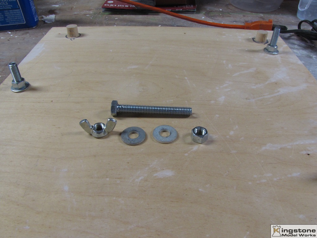

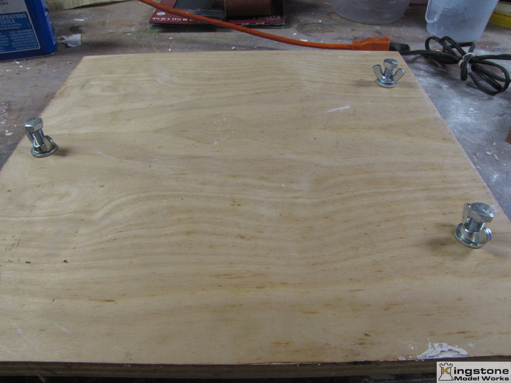

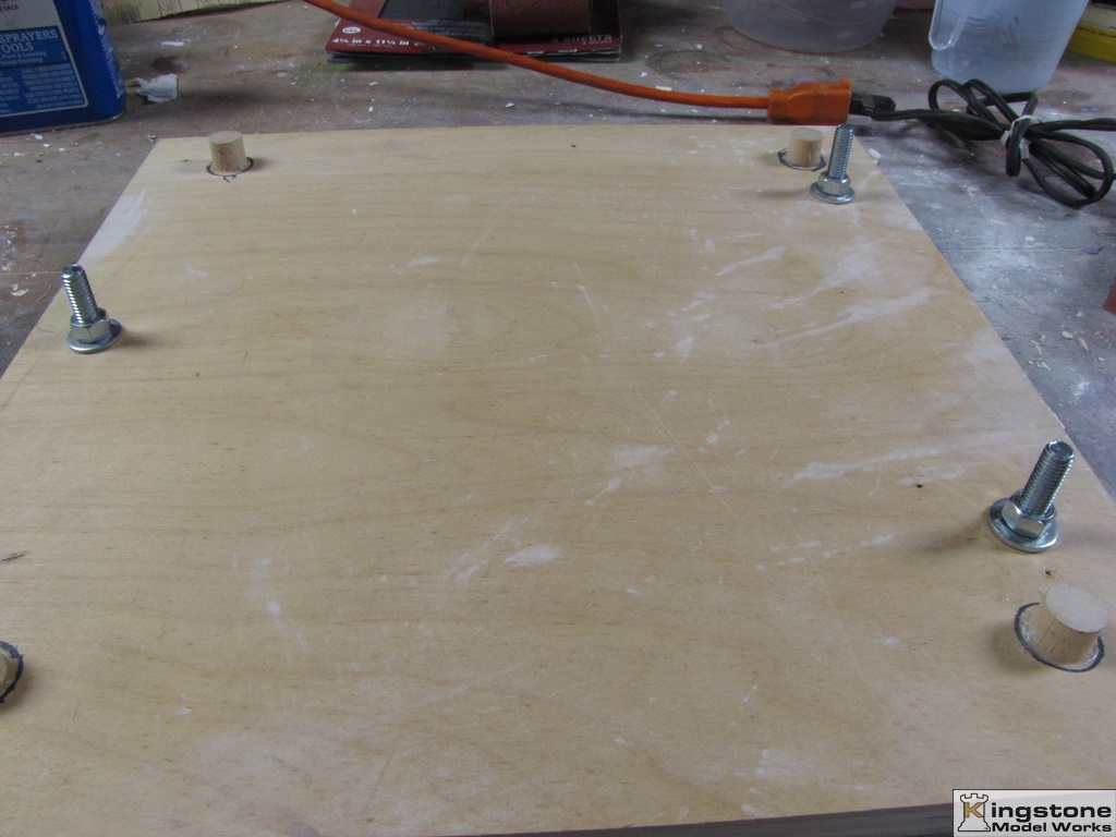

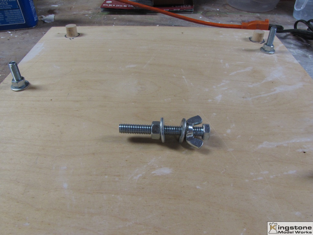

I made a slight improvement to the shaker table. Every time I set something on to shake the bubbles out, the material would shift to one side of the mold. I had to put a shim under one side. After not finding that same shim the next time I needed it I decided it was time for a slight improvement of the table so this is Ver.1.1. Now I can adjust the level both ways by just turning the wing nut.
The parts for one adjustable leg. 3/8" bolt, two washers, one nut and one wing nut.
The sequence of the assembled leg.
The top side with the legs installed.
The bottom side.
Everybody understand the three leg principle of support so you get no rocking? Four legs would be to hard to adjust the level. Remember the three legged milking stool? Same idea. Except your not milking a cow.
