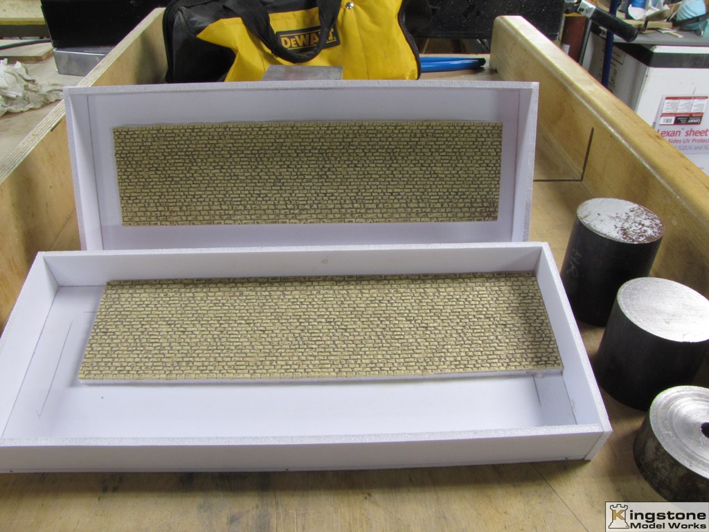

Ok, so yesterday was Friday the 13th. (11-13-2020) I should not have done any modeling. Mind you I'm not superstitious but I had some bad luck. I proceeded to glue the last two master molds into their mold boxes, placed weights on them and figured I'd be all set the next day. Well, the next day:
With those three pieces of solid round steal on top, the mold had shifted itself during the night. The other one turned out OK. It's solidly glued to the wall of the mold box and bottom. What to do? If handed a lemon make lemon juice. I needed to find out the volume of the box in order to mix up the silicone rubber and the white glue I used should release if soaked in water. So I got a half gallon milk cartoon filled to the brim and poured the water in the mold box. I discovered the mold box isn't 100% water proof, but at least I got a good idea of the volume needed of silicone rubber mold compound to mix now. I dreaded having to make another box just to get a volume. I know I could have measured and calculated the volume, but this is more fun. So the lemonade should be ready soon.
More to come once I get the mold UN-STUCK.

Ok, I got lemonade.
After soaking all day in water the glue finally let loose enough to be able to pry up the mold from the base. A quick clean up and drying everything up. It was glued back in and pinned with six straight pins so it could't move. Tomorrow will tell the tale.

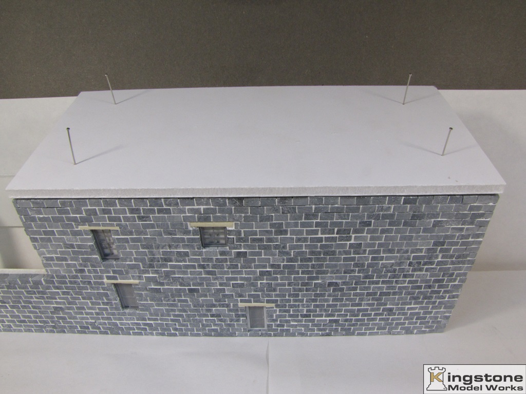

Next I made a floor for the upper part of the structure large enough to extend over the block work of the front and side wall. I used four pins to pin it in place when assembling the walls.

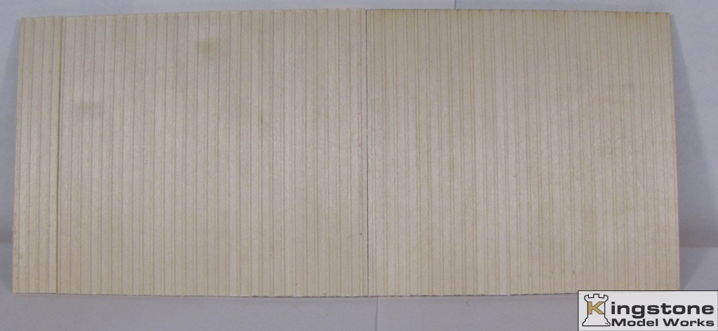

Then the board and batten siding was cut to fit the chip board. Thatís the 3M Adhesive paper.

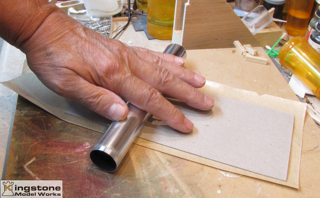

I cut a piece a bit larger than the wall to be trimmed to wall dimensions later. To get good contact of the adhesive I used a piece of pipe to roll the back of the chip board.

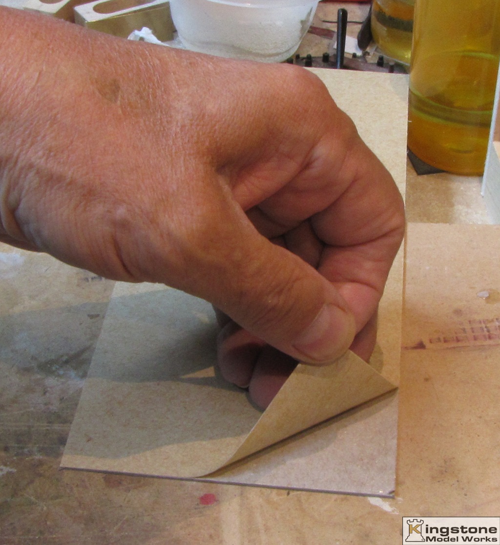

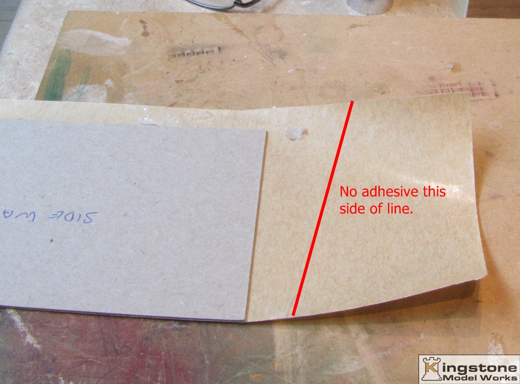

About half way through trimming the tape to size I noticed it wasnít sticking to the chip board. Come to find out there is no adhesive in the area toward one side to make pealing the paper off easier.
So I cut a new piece. Pealed back easily from the edge leaving the tacking substance on the chip board.

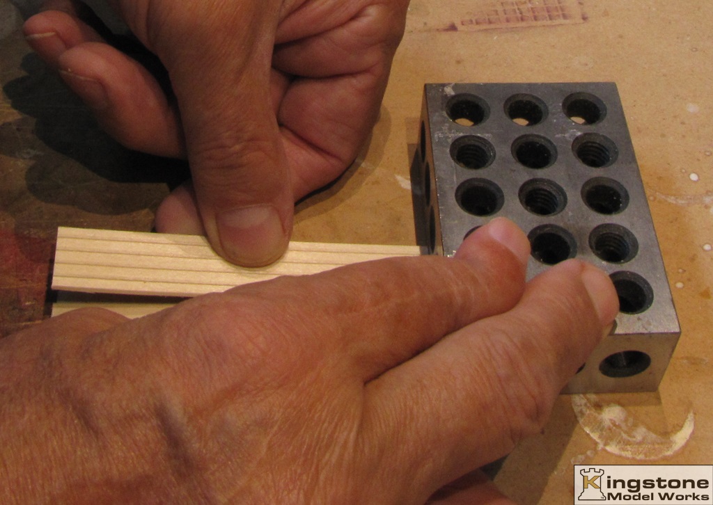

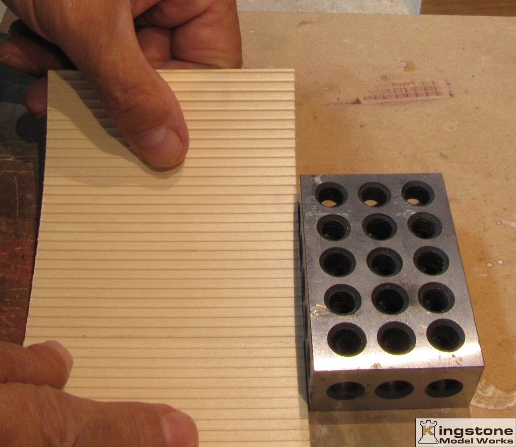

Next I used two 1-2-3 blocks to help align the board-n-batten to the chip board. Unfortunately I didnít get the second block into the picture. The 1-2-3 block formed a small square so I could get the wood positioned accurately the first time.

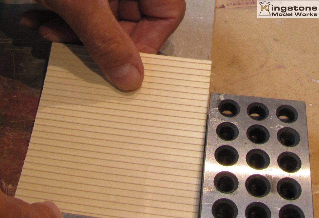

Again I used a 1-2-3 block to help position the second piece into the proper alignment.
And finally the last small piece.
And hereís the first wall.

Bernd, I like your use of the 1-2-3 block to align the pieces before the adhesive grabs it.

Goerge,
Any straightedge that's thicker than the two pieces you want to glue together and hold in position will benefit from this method. BTW, I'm liking this adhesive tape method of combining two different materials. It's a lot neater than glue.
