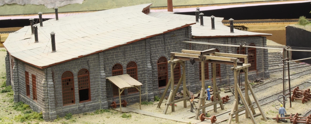

Number one is scratch building the rock crusher for the quarry part of the layout and building a roundhouse like the South River Model Works stone roundhouse. There is one on E-bay for $1350.00. A bit too rich for me.
Being the DYI’er that I am I want to make my own molds to cast the walls for the roundhouse. When I got back to looking at the rock crusher building I wondered if it would be feasible to use limestone block to build the bottom portion of the building instead of poured concrete. I’ve already designed and cut out parts to cast the foundation of the rock bins.

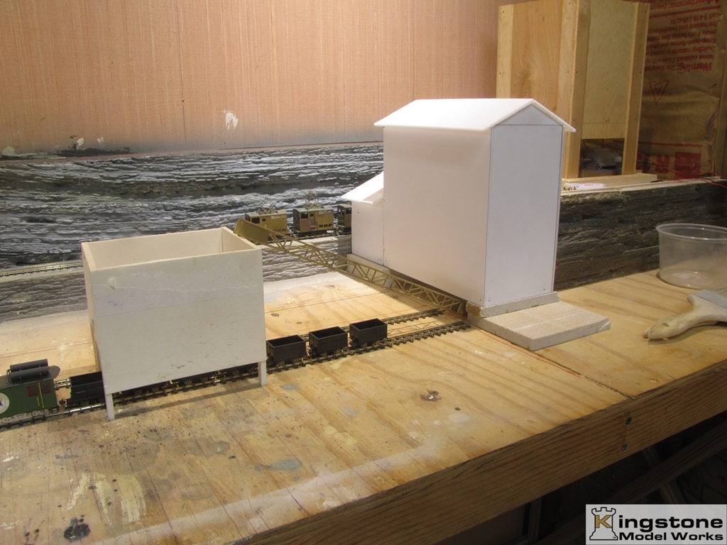

Here’s the mockup I made of the crusher. It will be lengthened about as much as the ceiling tile sticking out under the right side.

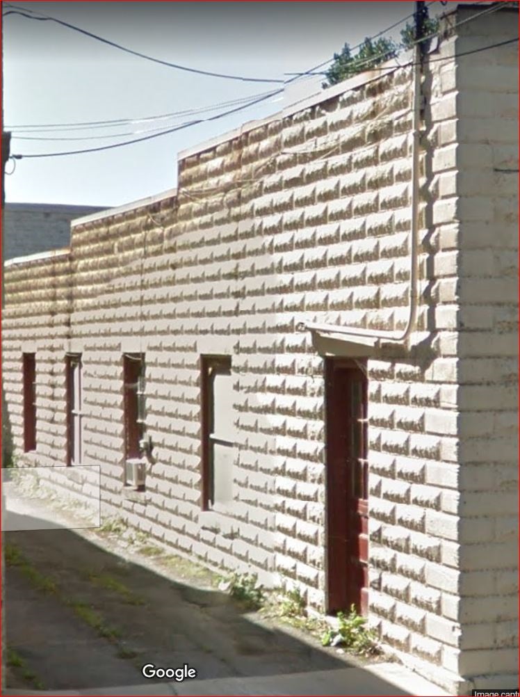

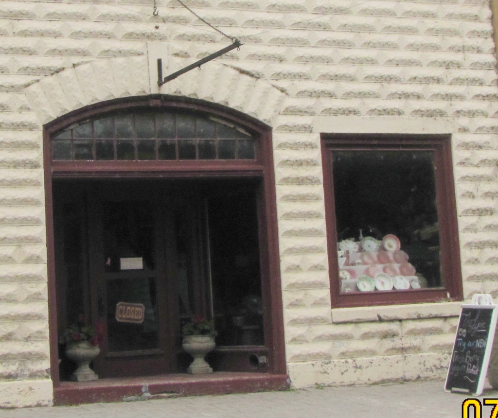

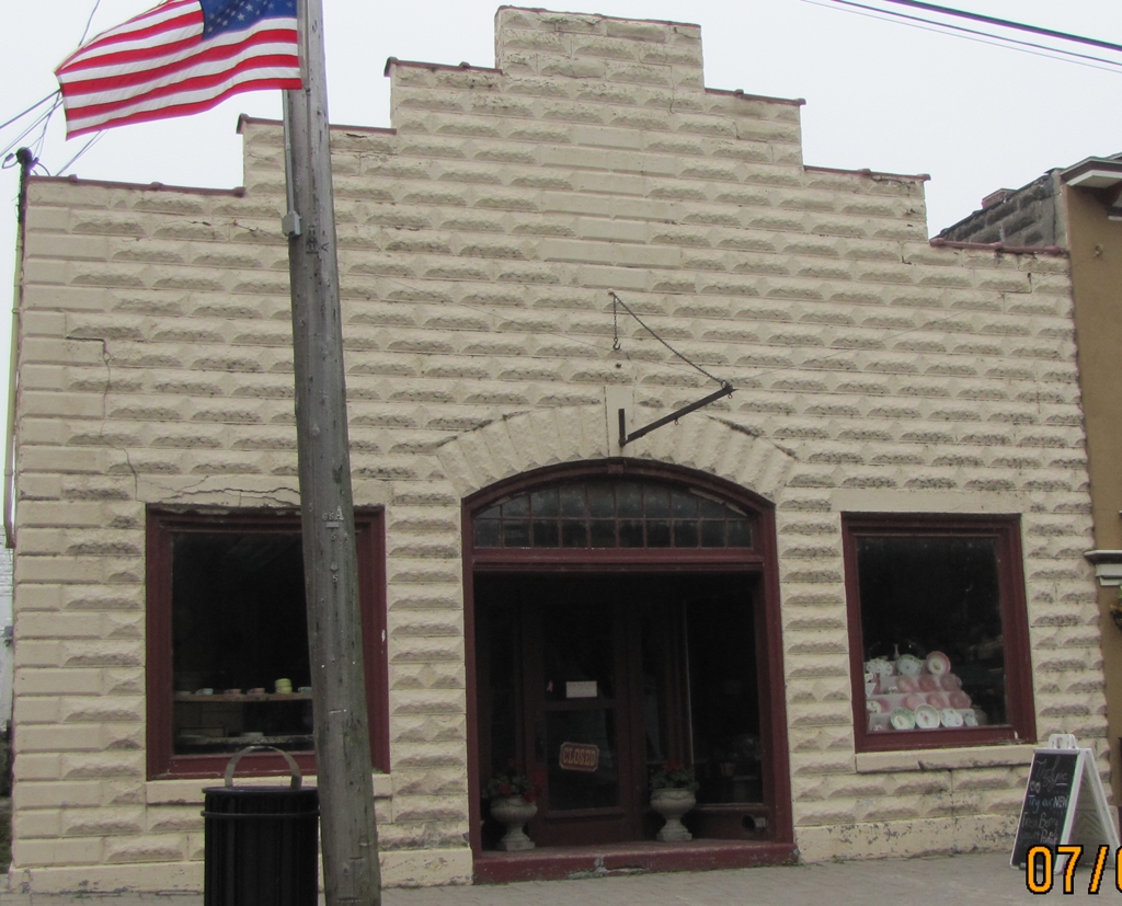

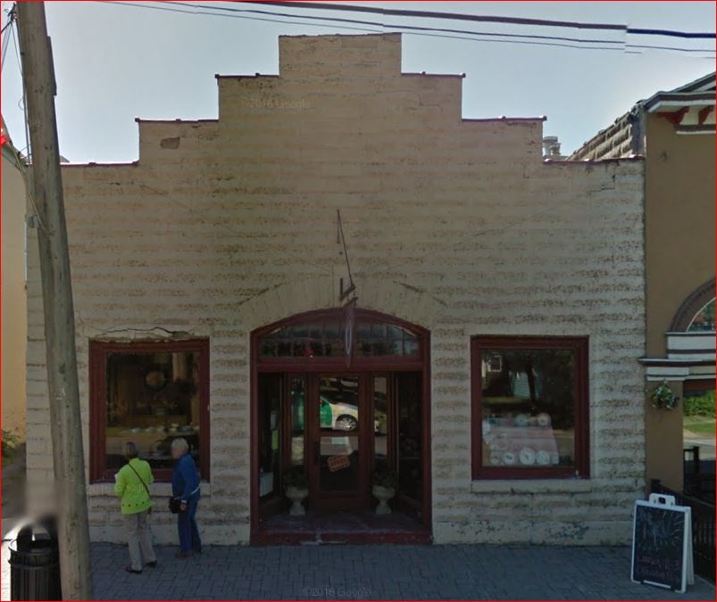

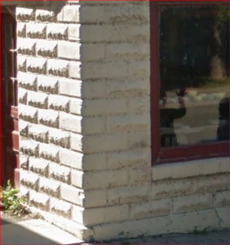

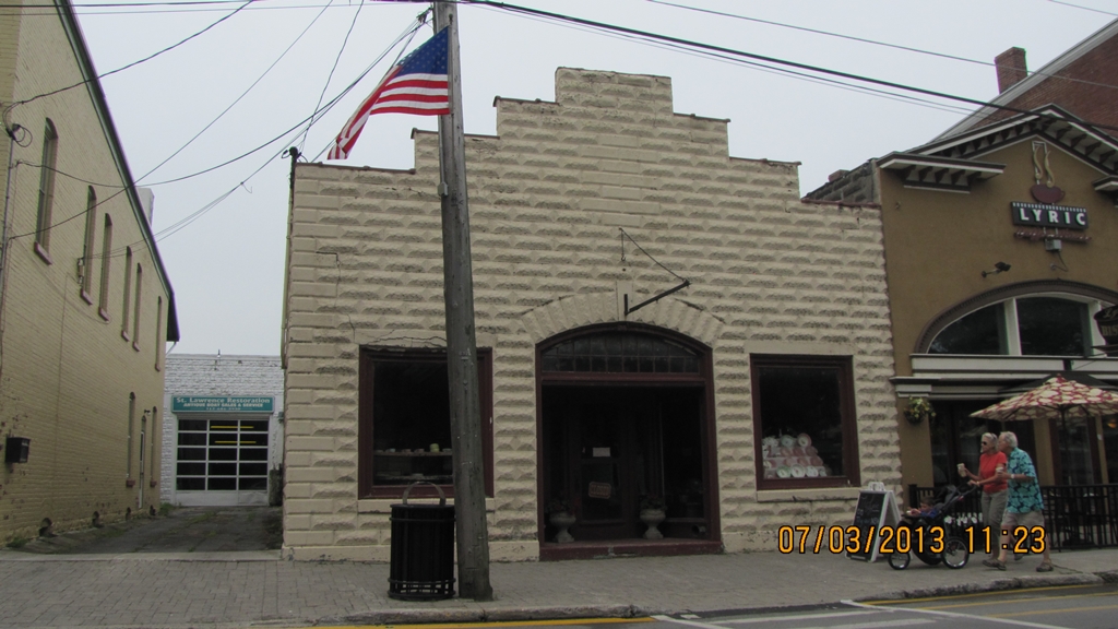

The stone work I’d like to copy is presented in the next four pictures. I found this place up in Clayton New York, about 12 miles south of our summer home in Alexandria Bay. These a Google pictures. I had taken some with my camera but can’t find them right now, so these will have to do.
The corner stones are a smooth surface.

From the regularity of the blocks I would guess they are cast concrete, not stone. Or, is that what you meant by stone?
If you made one and made a rtv rubber mold you could cast innumerable identical blocks.

Looks like a great project. Mike is right, they are cast stones. You could carve the master for
one stone or crinkle some aluminum foil to get the roughness, pour some plaster over it, and
cut one stone from that. Once you have that one stone (plus the smooth corner stone), then you
can make a rubber mold and cast as many as you need from plaster or resin.

Like Michael and Bob, those look like cinder block 'stones' rather than the real thing. There was a nice article (by Michael Tylick?) in the MRR magazine years ago about casting them. He pointed out that because each block is identical is has quite a different look to a stone wall. Are you modelling in O or HO?

Yes, you are right they are cast concrete. I am looking for that texture on the surface. I believe it will be had to create in HO scale. I’ve already played with a couple of pieces of plaster I had laying around. Cut it approximately to and HO scale block and then broke the end off. The outcome was nothing I was looking for. For the crusher building I’m going to go with limestone blocks. I just need to figure out a size.
BTW, I did finally find the pictures I took. It was only the front of the building and I now remember why I took them. It wasn’t so much the texture or what they were made out of, but the size. I never did get to measure them. Anybody got any good guesses?

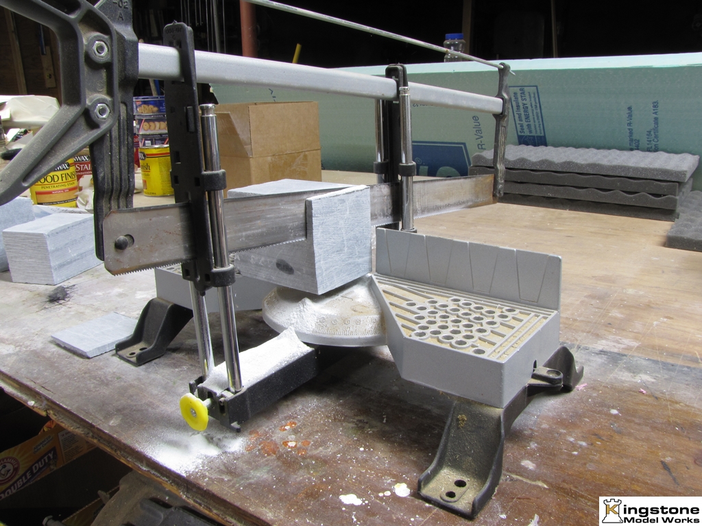

Now here’s what I have in mind for the bottom half of the rock crusher building. I’m going to go with cut limestone blocks with smooth sides. I’ll leave the rough looking block when I eventually get around to doing the roundhouse. BTW here’s a pic of that roundhouse off the net.
As for how I’m going to make the blocks. When I started the quarry line I wanted to have a pit where blocks of limestone were being cut and loaded onto flat cars. My idea was to use soapstone. The material that was once used to make sinks back in the day and is still used in wood fired stoves today. The material is workable with plain steal tools. It’s soft, but won’t break very easily. Here is a pic of a piece being cut in a hand powered miter saw.
So I close with that picture for now. I’m going to see what can be done to make scale blocks for the crusher building.
