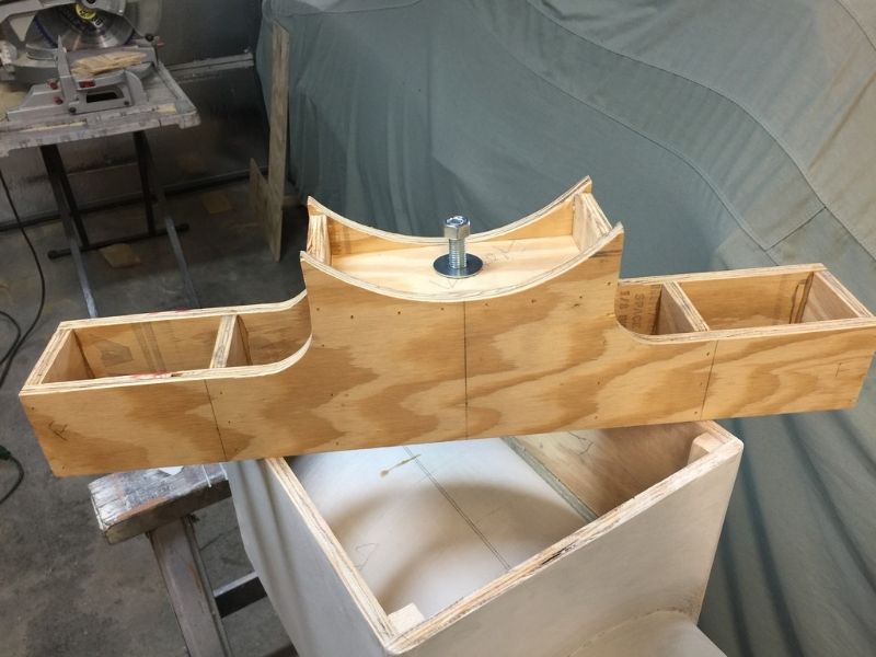

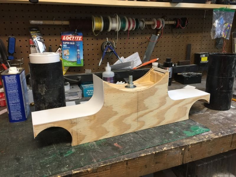

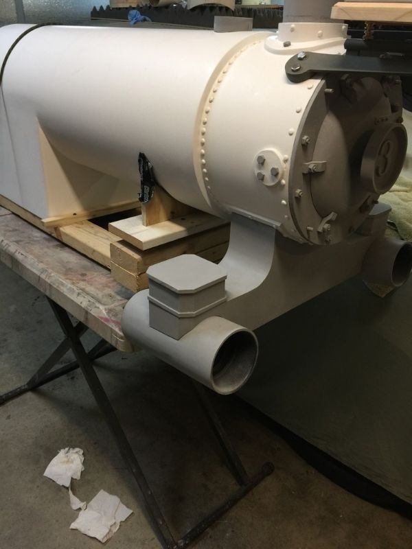

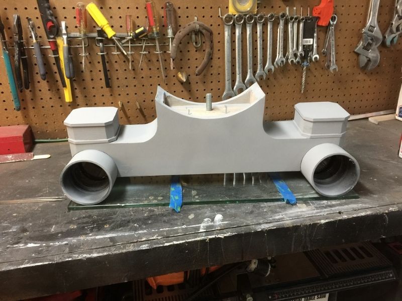

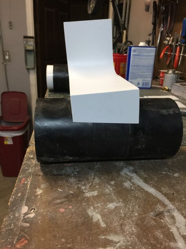

Another weekend and another post! Getting excited now, really starting to look like an engine. This weekend I worked a little on the cylinders and the saddle. I used plywood and plastic along with some ABS couplers glued together for the right diameter and size.All was skim coated sanded and primed. Still a lot of filling to do and resanding along with Gelcoat.

You got a lot done and man, your work is fantastic! Its really starting to look line something.

It must have been tricky cutting the saddle to fit the angled cylinders, but you got it done perfectly!

Thanks Mark. Ray, Tricky does not describe it, more like a real pain. It was allot of cut and sand until they fit then if you look at one of the pictures I have it on a piece of glass shelving. That helped me make sure everything was true. My first attempt was pretty funny, the cylinders were pointing outwards on the front. It still needs some fill here and there but overall I'm pretty happy with it.

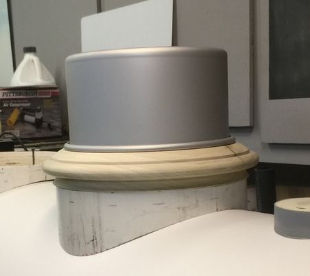

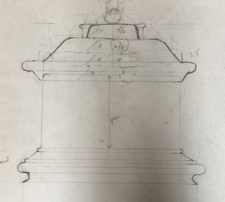

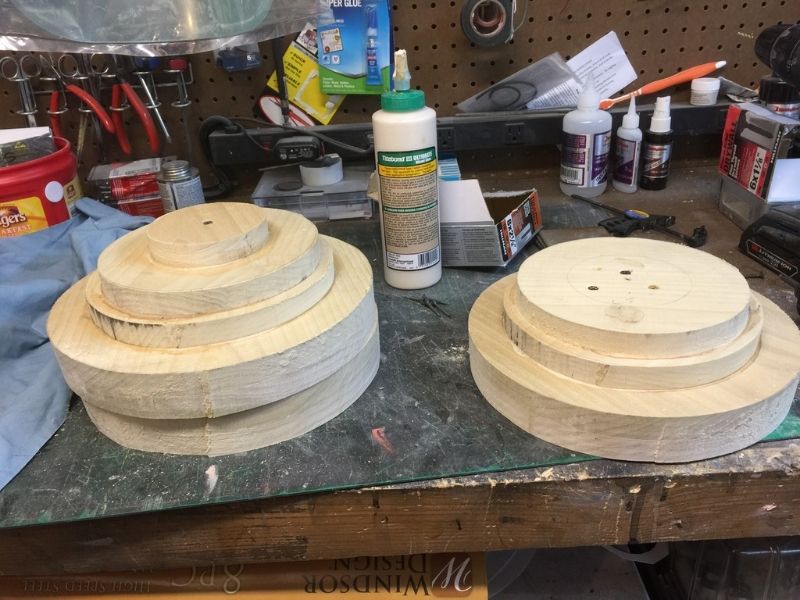

Here is a picture I drew up for the domes.

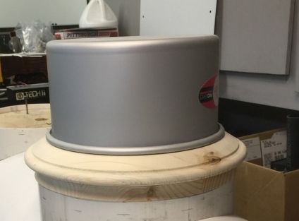

I cut out some circles with my jg saw. I used pine as a test then I glued several poplar together. Much better wood to turn. First atemp with pine.The center part is a cake pan.
This one much better!

Cake pan, wow a My-T-Fine dome indeed. It is really coming together.

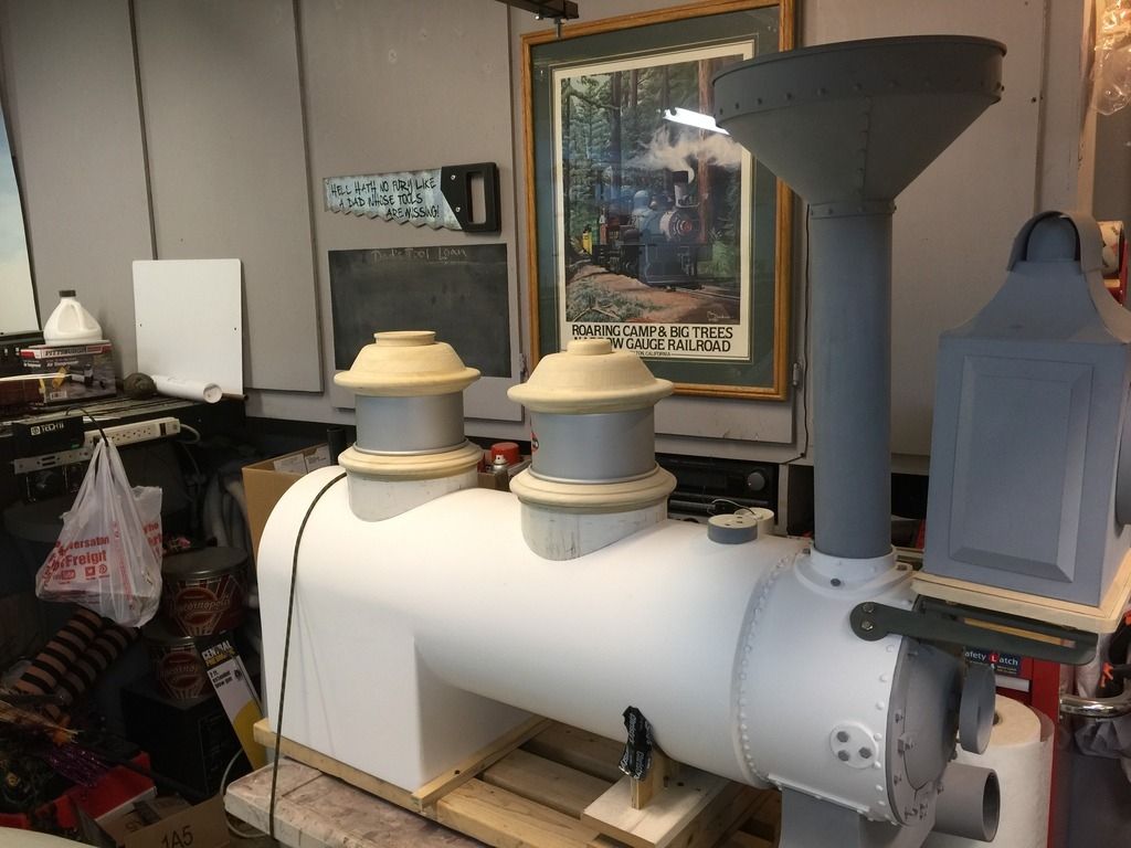

Here are the tops. I did however change the sand dome top a bit. will show later.

This is getting to be unbelievable. You are a wonderful and innovative craftsman.

Thats amazing, a little of this a little of that, some fish eyes stir it all up in a pan and voila. A locomotive fit for a kid.

I'm am just constantly in awe of how great this is turning out!
BTW, I also like that "saw" sign on the wall!
