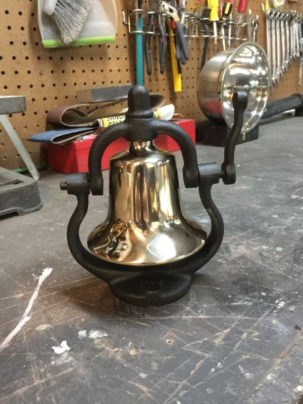

What a GREAT WEEKEND!!! Wife went to Santa Cruz so I had the whole weekend to play build. Friday the bell arrived, what a beauty! Perfect size. Found it in two places one the web, but the best price was, Idea Stage promotions LLC. they had it for large quantity purchase for companies but will send you a sample without a custom plaque on a wood base to see if it is something you would like. The price is about 30 bucks less. Thanks BSH Home Appliances!

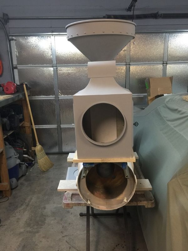

With the bell you might say I am committed to the project now, no backing out now. I started to work on the light base and brackets when I realized that I had made the headlight too wide, well basically Tooooo big! Here it is prior.
And after the shrinking
I had to take an inch out of the middle which meant that the bowl I was using for the reflector was to big now. Lucky for me since my wife was gone, well you know.

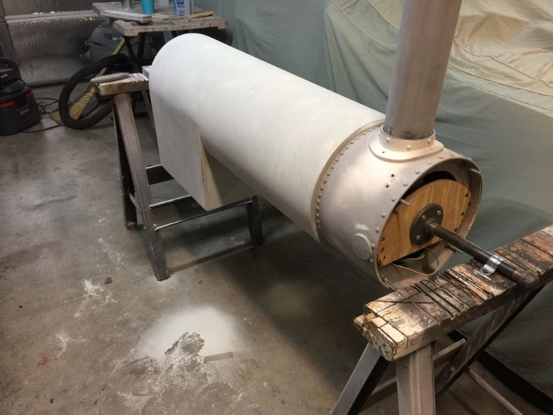

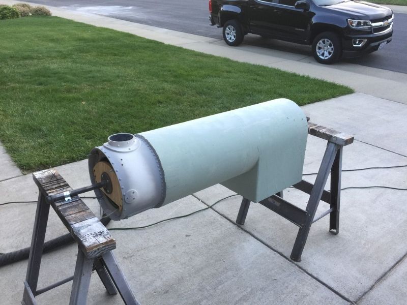

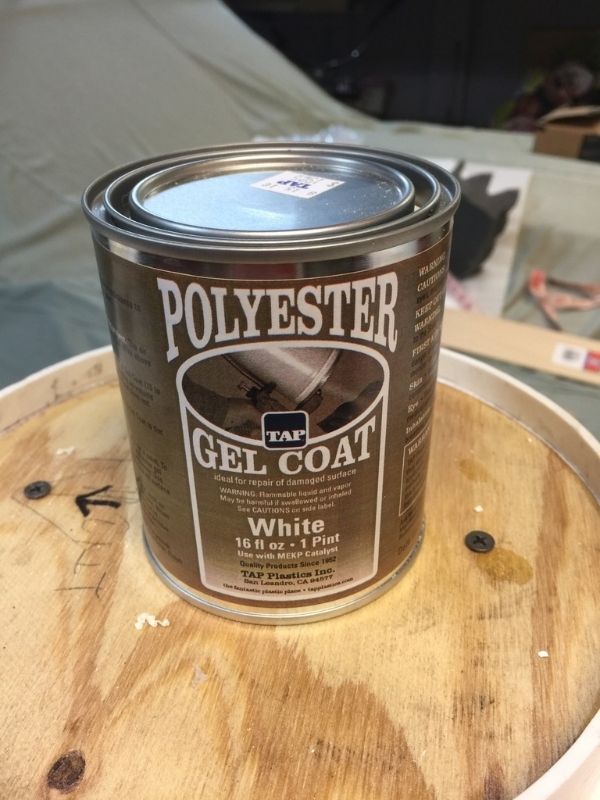

You will notice in the last light picture that the smoke box changed from grey to white. This is the Gel coat. it is used to repair boats, usually after repaired with fiberglass. It can be used by itself so it becomes a great sealer and can be applied light or heavy with a spray gun.

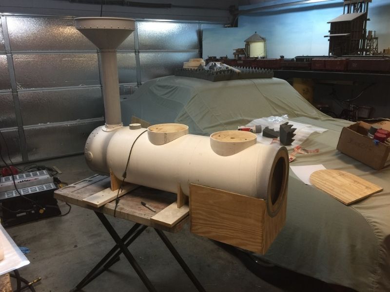

Because I wanted a good coat on the smokebox I had to remove all the eyeball rivets so as to be able to sand it smooth once we sprayed it. I redid them after and will coat again when the boiler is ready for a final Gel coat. It turned out to be a good idea because my son and I decided rather than wrap the main boiler with plastic we were going to gel coat and auto body putty to get the lines out of the cardboard tubes. I built the firebox on the boiler, made the bell stand and positioned the dome bases.
As you can see, I don't have much room to work with. Anyone interested in a custom 1968 RS Camaro let me know. 555-1234. Ok that was my Saturday.
SUNDAY, SUNDAY, SUNDAY!!! Remember those radio commercials? I was waiting for my son to help with the fiberglass and putty so I decided to work on the fun stuff like wiring and effects.

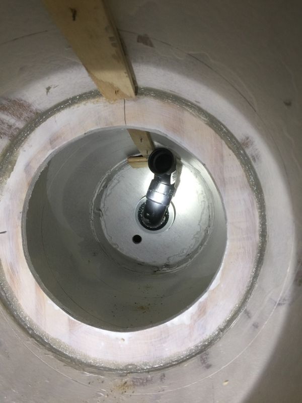

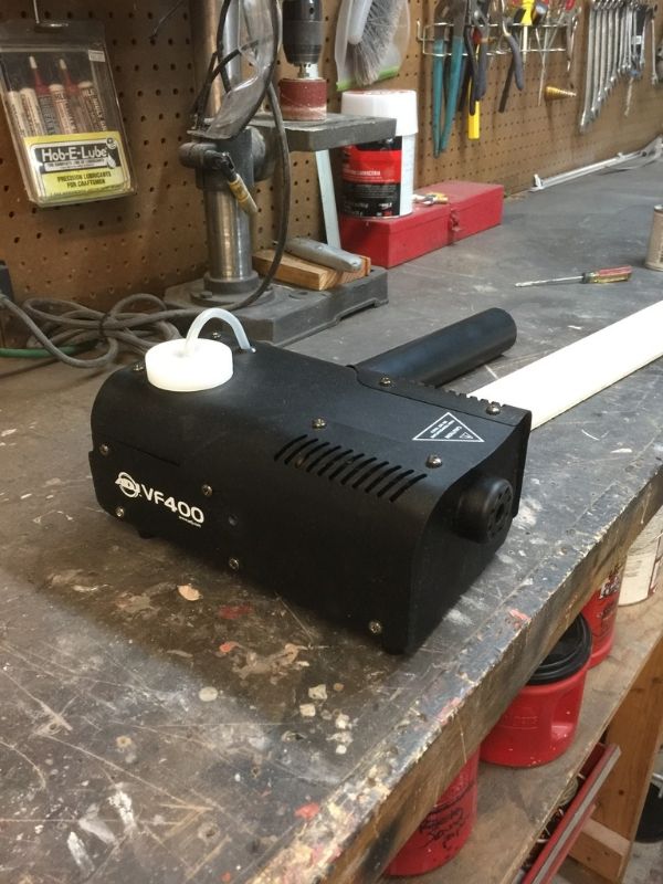

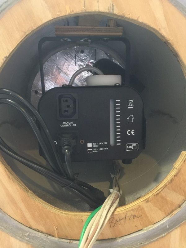

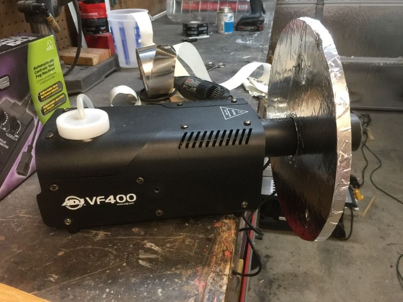

After watching Ty's video on making smoke for smoke stacks on his layouts, I came up with an idea to be able to have continuous smoke from the fogger. Who knows if it will work but in theory it will. Inside the boiler i sealed it up with the stuff advertised on TV that they spray on a screen door on the bottom of a boat and it floats, I know you have seen it. I have no idea why I had a can on the shelf but it worked to seal the inside. If you look down the boiler you will see the smoke stack pipe. The small hole is for wiring. Now in Ty's box he had a fan in the box, my bilge fan is actually in the smoke stack pipe.
Here is the fogger.
This picture shows the unit in place. I know what you're thinking, hey that runs on household current of 120 volts AC. Yes it does.

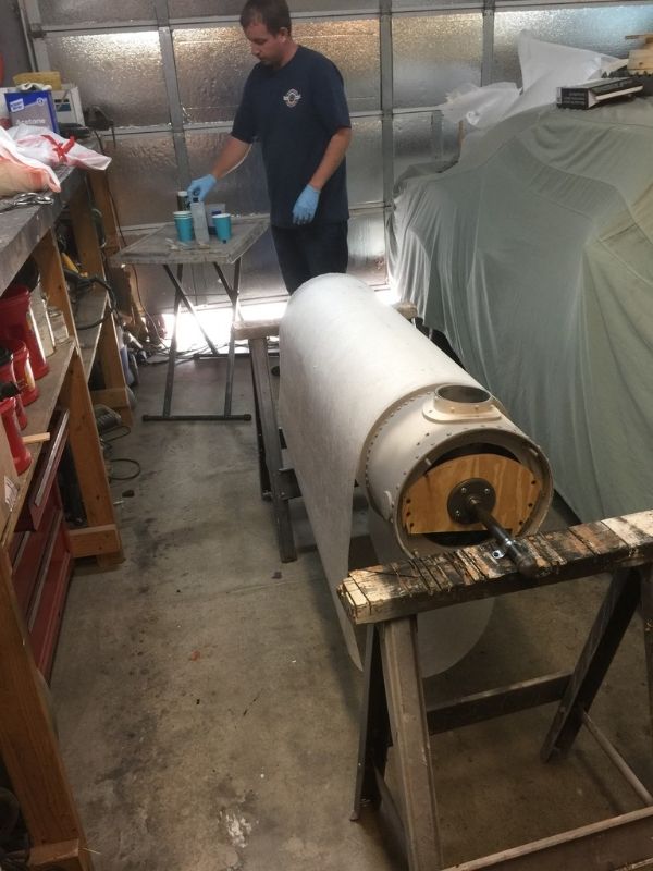

About this time my son arrived. We wrapped it in a really light sheet of fiberglass. I can only describe it like a dryer sheet but fiberglass. So that we could work on it easily, I made a rotisserie of sorts. Hey I bet I could cook a pig this way also!
Once dry, we skim coated it with body putty.
Sanded, made a huge mess and wha la.Ready for Gelcoat and paint!
