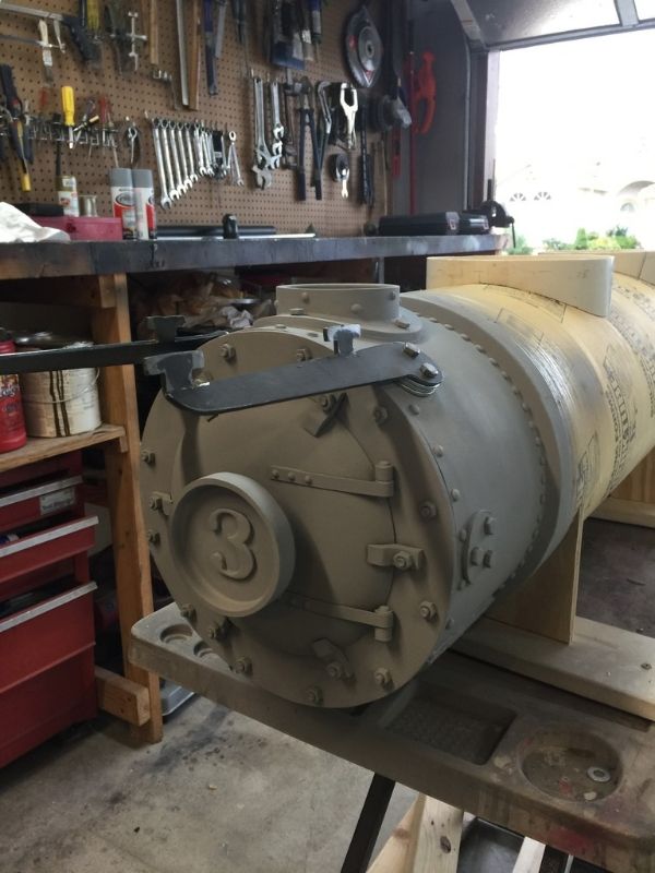

Smoke box front clamps made from castings made from wood, a bolt and a nut.
Ever seen these?
They make great Rivets
Bondo time for the boiler!

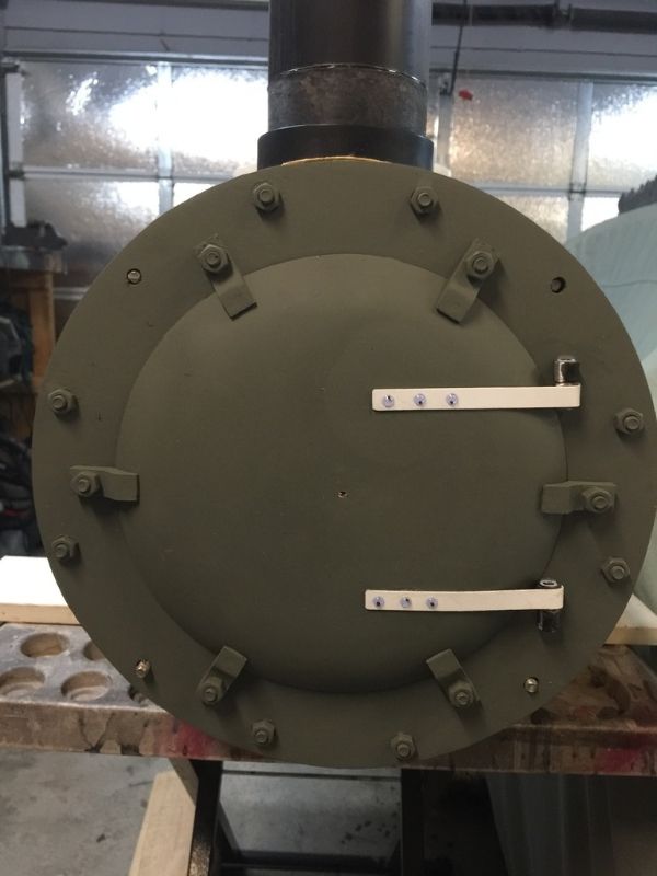

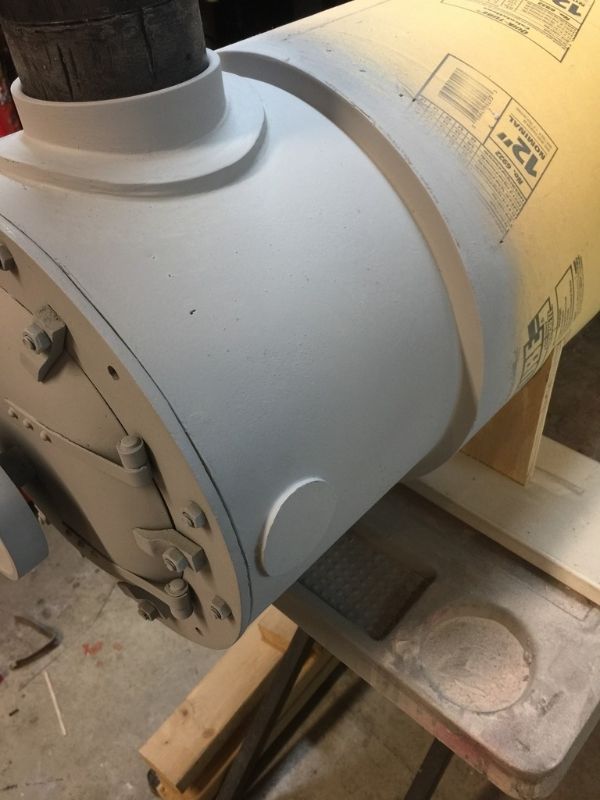

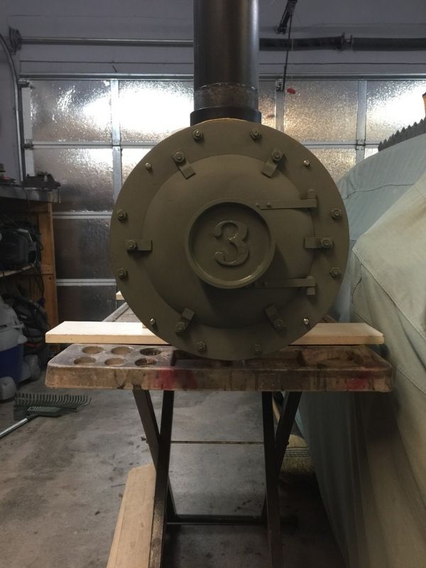

I only made castings for the smoke box clamps. It was easier to cast the bolt with the clamp than just the clamp with a hole. If you look closely you will see that the bolts around the outer edge of the smoke box front are bolts and nuts. You will also see a few holes with no bolts. this is where I fasten the smoke box front to the smoke box. I have added studs there, not shown in this pic. This also shows the bondo job to smooth out the layers of the boiler and the smoke stack ring.
I finished the angry eye rivets on the smoke stack as well as the smoke box and primered them.I also had my son make me some brackets for the head light. I didn't feel like trying to grind them out. it would be more work than the whistle lever, beside this is a family affair. You will also noticed I started the domes. Waiting on some cake tins.
