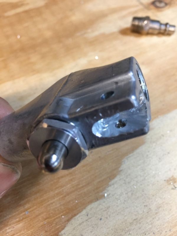

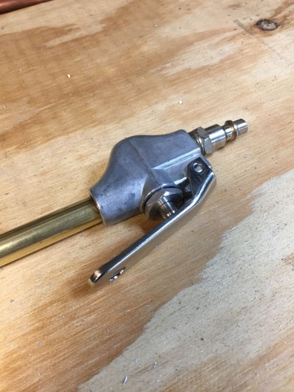

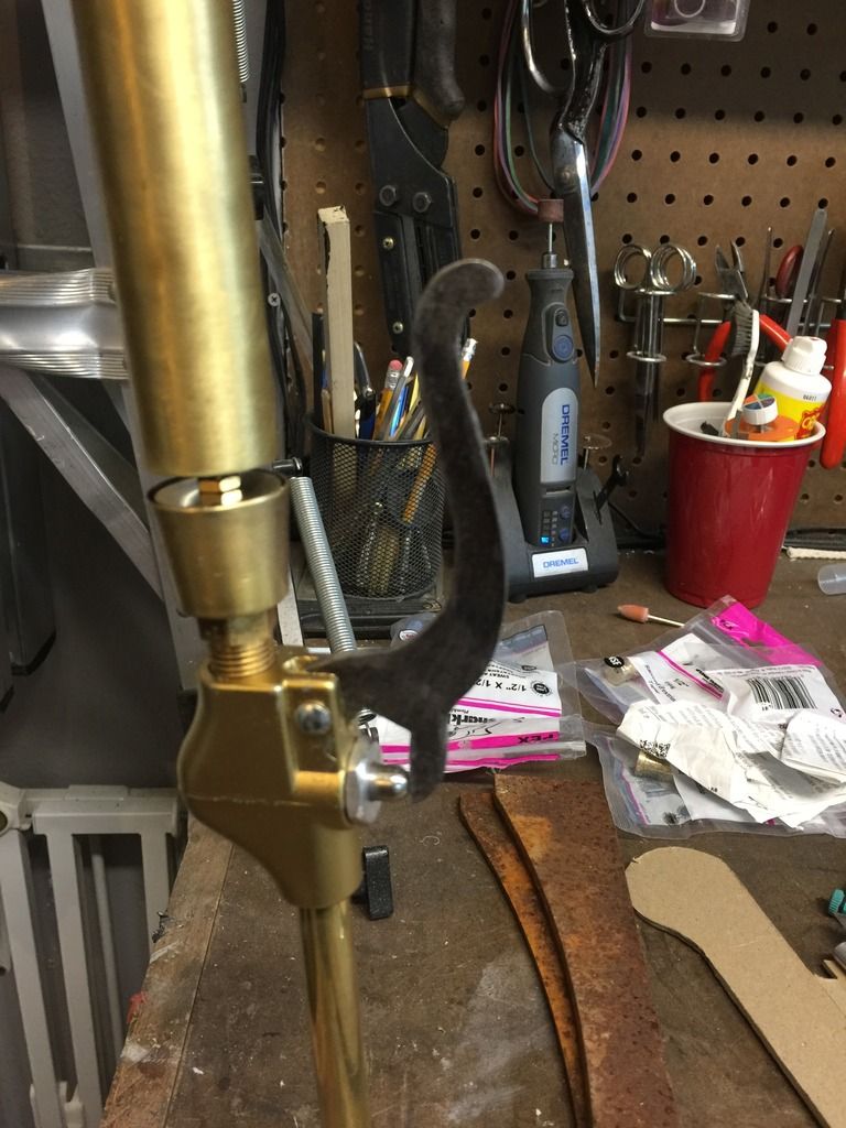

I had some time to finish off the whistle valve. I used a shop air gun and removed the lever.
I then ground a notch in the gun so as to put a lever for the whistle.
The lever was drawn out on matt board to get the right size and shape. then I used a scrap piece of 1/8 steel bar and cut, ground and filed to match the drawing. total cost of the valve, 6 bucks. Sure beats the real one for 69. I might dress it up with a nut on the opposite side of the valve pin. Tried it on my air compressor, only needs about 20 psi for a good tone. Higher psi and it becomes a screeching banshee.

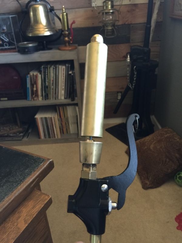

I tidied up the whistle with a few nuts and repainted the valve.

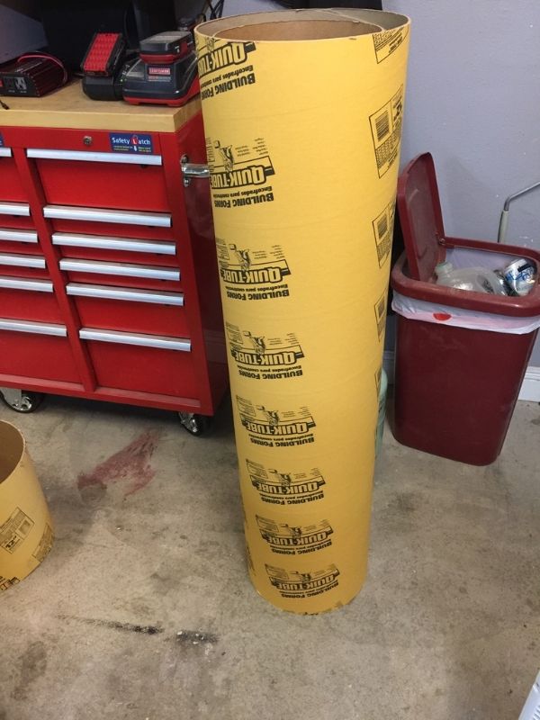

before I start with the boiler, let me explain what kind of person I am. This will give you a better idea of my mind set. Besides being obsessive compulsive and just plan loco, (notice the play on words), I like to look for things that I can use for projects, mainly model railroading but not limited to that. I think I am the only person that will say yes when my wife wants to go to any type of store. It doesn't matter. from Ross to Joann's, Michele's Target or basically anything that might have something I might need at a latter date. This also applies to hardware stores like Lowes, Home Depot and Ace. For example, how many times have you walked through Lowes building dept and seen those cardboard tubes for concrete footings?
Welllll,that brings me to the boiler.

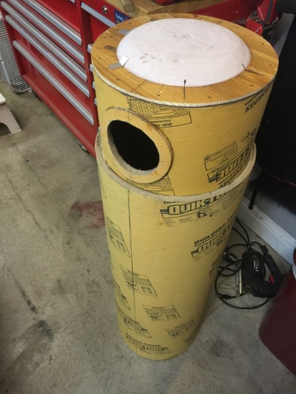

Just so happens that they sell a 12 inch tube which is perfect for the size I need. So off I go to Lowes. As I am looking at the tubes I notice that there are about four tubes inside each other all in the 12 inch section. Im thinking, how can two or more 12 inch tubes fit inside each other? As I pull them down off the shelf I see printed on the side,"12 inch NOMINAL, can vary +-.5 in size " Then I thought to myself,hey this might be a good thing, Buy using several of them I can get a thicker boiler compared to the smoke box. Now I know what your thinking, cardboard? Trust me, you'll see what I have in store.

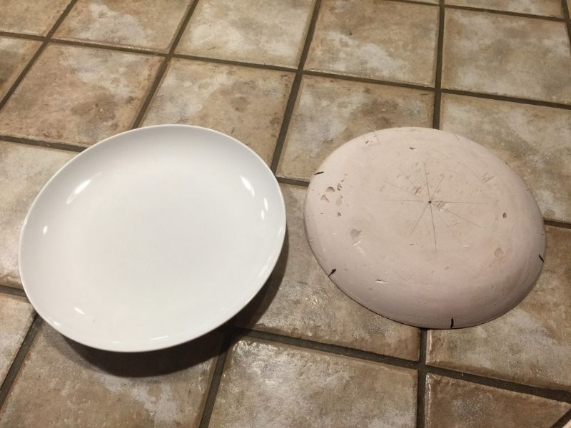

Smoke box front was cut out of an old shelf and the door was made from Bondo formed in, you guessed it, my wife's plate. I'm going to get busted one of these days.

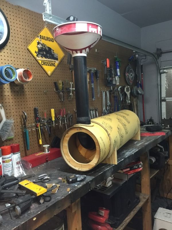

Boiler with supports and tube for Smoke, yes it will have smoke. What steam engine does not?
