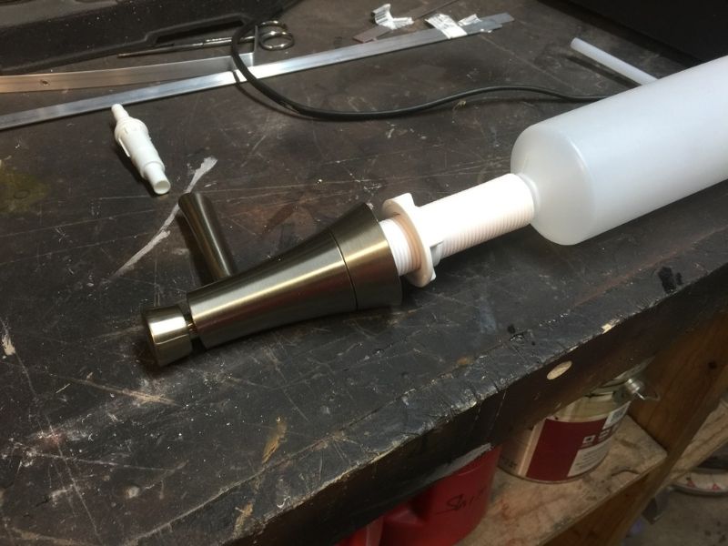

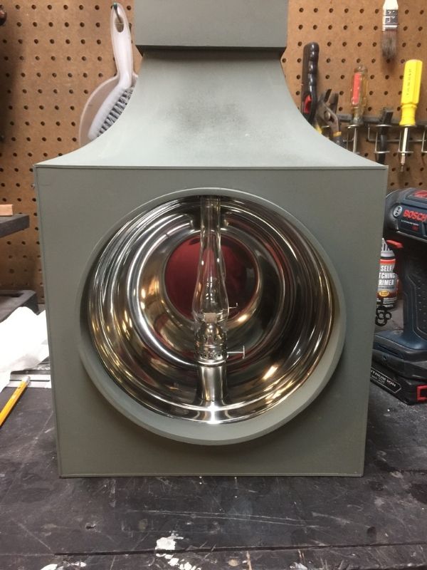

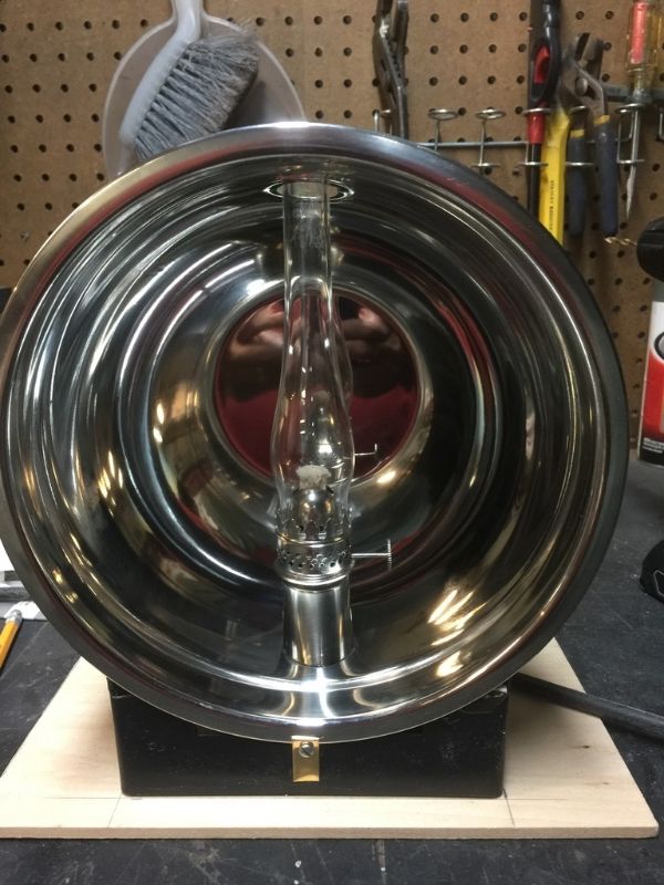

I received the Hurricane lamp parts and finished that portion of the headlight. I used a soap dispenser I had left over from a faucet replacement and used it for the bottom of the burner. All that's left is paint and decoration. I will probably use LEDs for the light incorporated in the wick.

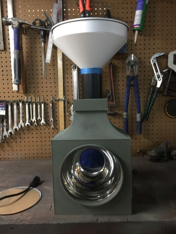

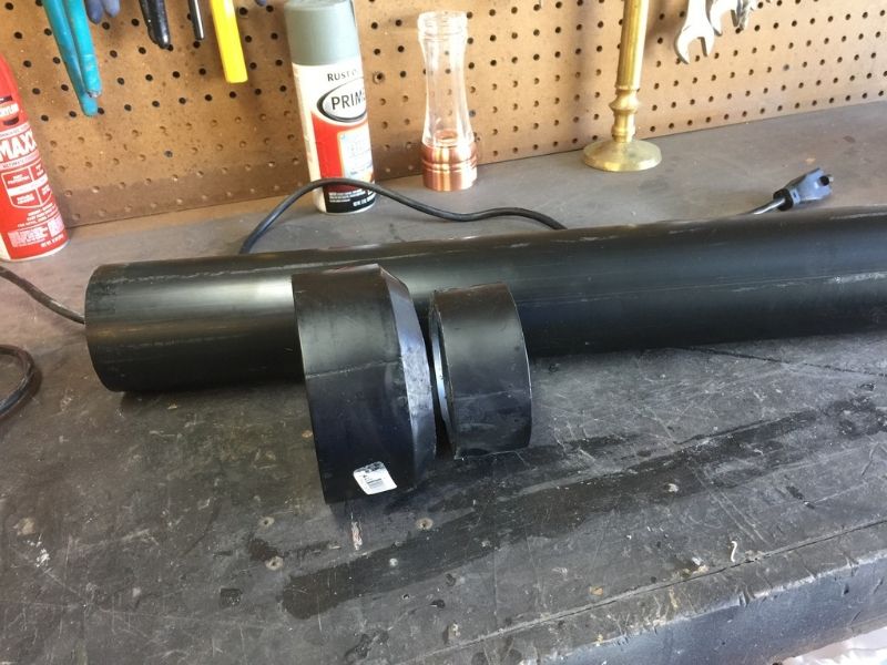

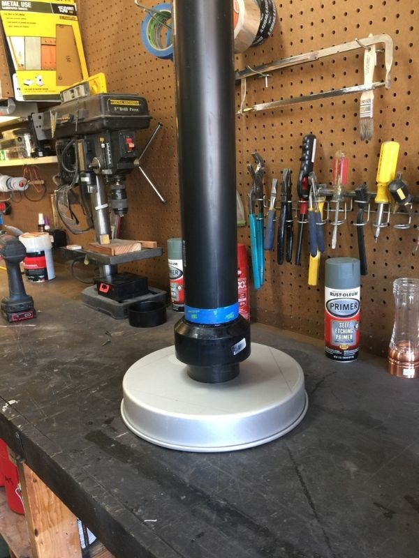

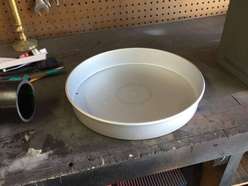

12x2 cake pan, 3 inch pvc pipe, a plastic for sale sign and a 3" to 4 " coupler for the smoke stack. The coupler was cut at the angle and the inside was sanded out to fit the pipe. This was used as support for the bottom of the upper part of the stack. The top cake pan has been attached to the pipe. A hole will be drilled in the center to allow the smoke to exit the stack. it will eventually have a smoke arrestor.There will be a veneer sheet and rivets around the pan to connect to the angled portion as well as one on the pipe to connect to the bottom funnel on the pipe.

I thought of that believe me but couldn't find one big enough to match the drawing. I even looked for metal ones.I finished up the smoke stack today and it is pretty strong. Also since I have the cake pan it will allow me to put speakers in the top of the smoke stack.Going to primer and take some pics.

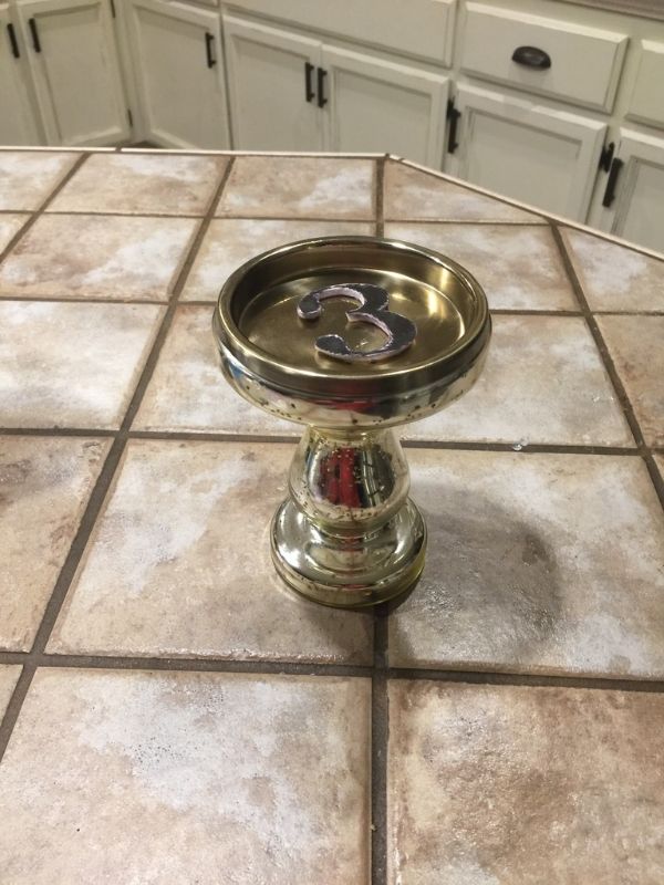

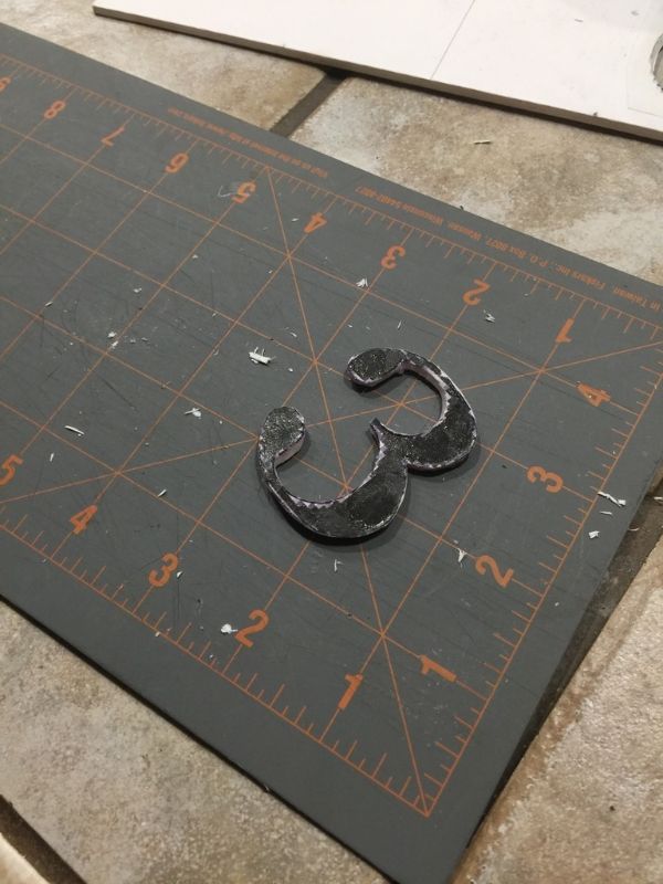

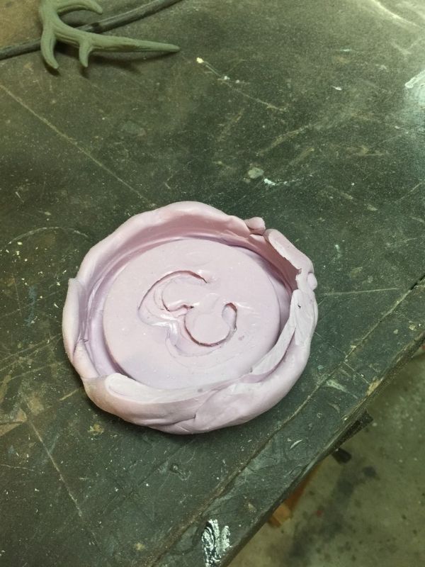

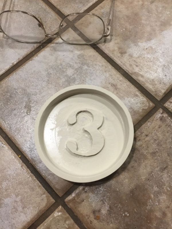

I rummaged through my wife's cupboards again and found a candle holder just the right size for a number plate. First thought was use it. But I left it out on the counter too long and she wanted to know why it was out. So plan B, Id make a mold and cast it. Only problem was I didn't have any mold making compound other than some putty that you mix two parts together and in about two minutes it sets and is ready to cast. however it is mainly used for small part casting this was going to be big. Well I tried it, not very pretty mold but it did the job. I had blown up the number three and put it on matt board and cut it out. I then placed it with hot glue on the candle holder. Made mold cast the plate and with allot of clean up came up with this in a total of about 25 minutes. Allot faster than the regular silicon. It is about 4 inches across.

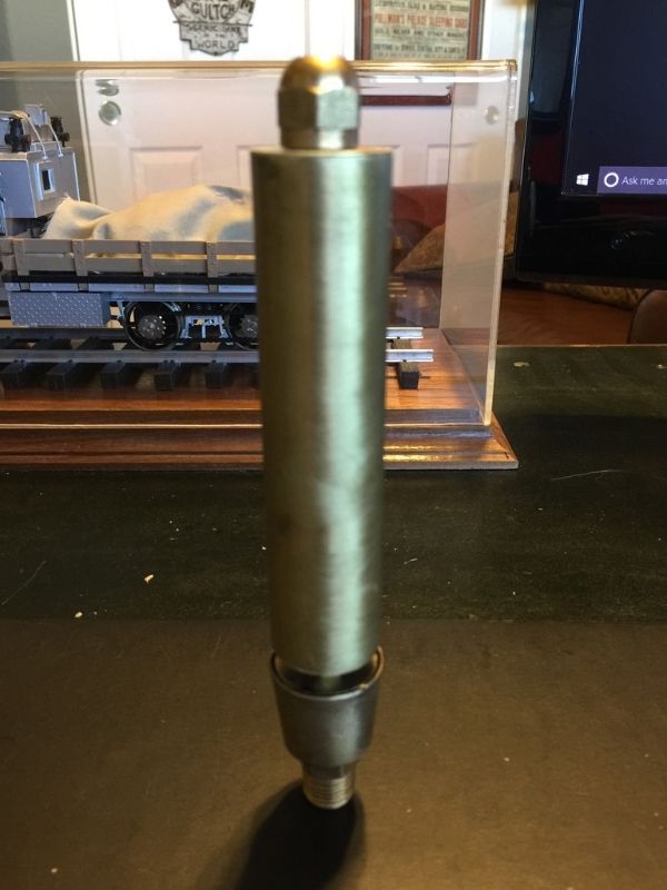

Currently working on a whistle. Couldn't find one small enough for the scale so I decided to build one. It's turning out to be amazingly simple.
Mudhenbill
Posted - 10/20/2016 :  5:11:26 PM  Show Profile  Visit Mudhenbill's Homepage  Reply with Quote

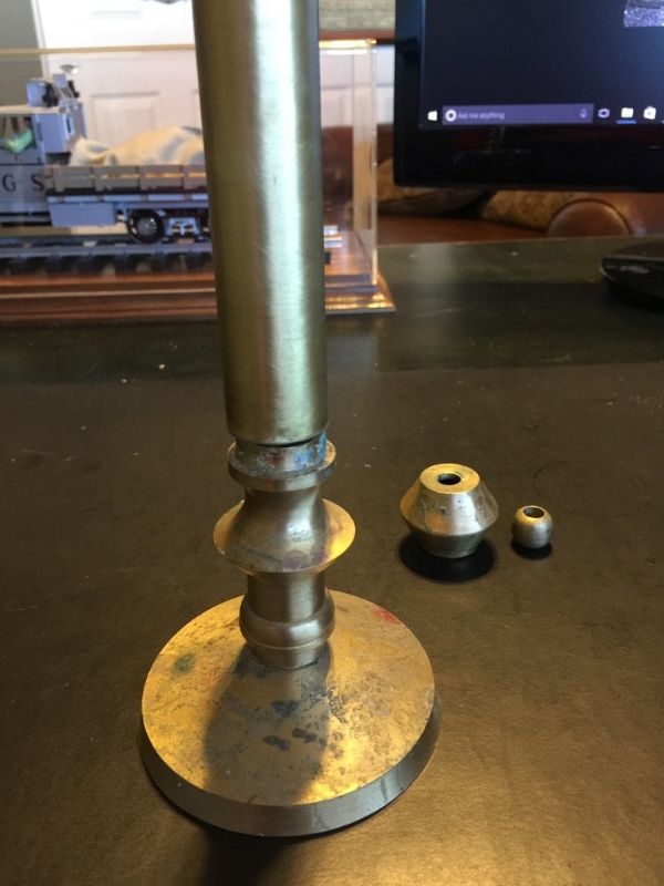

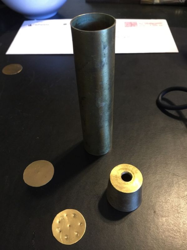

After doing some research on the web on whistles, I came up with an idea to use a candle stick I found while visiting Pagosa Springs Junction.

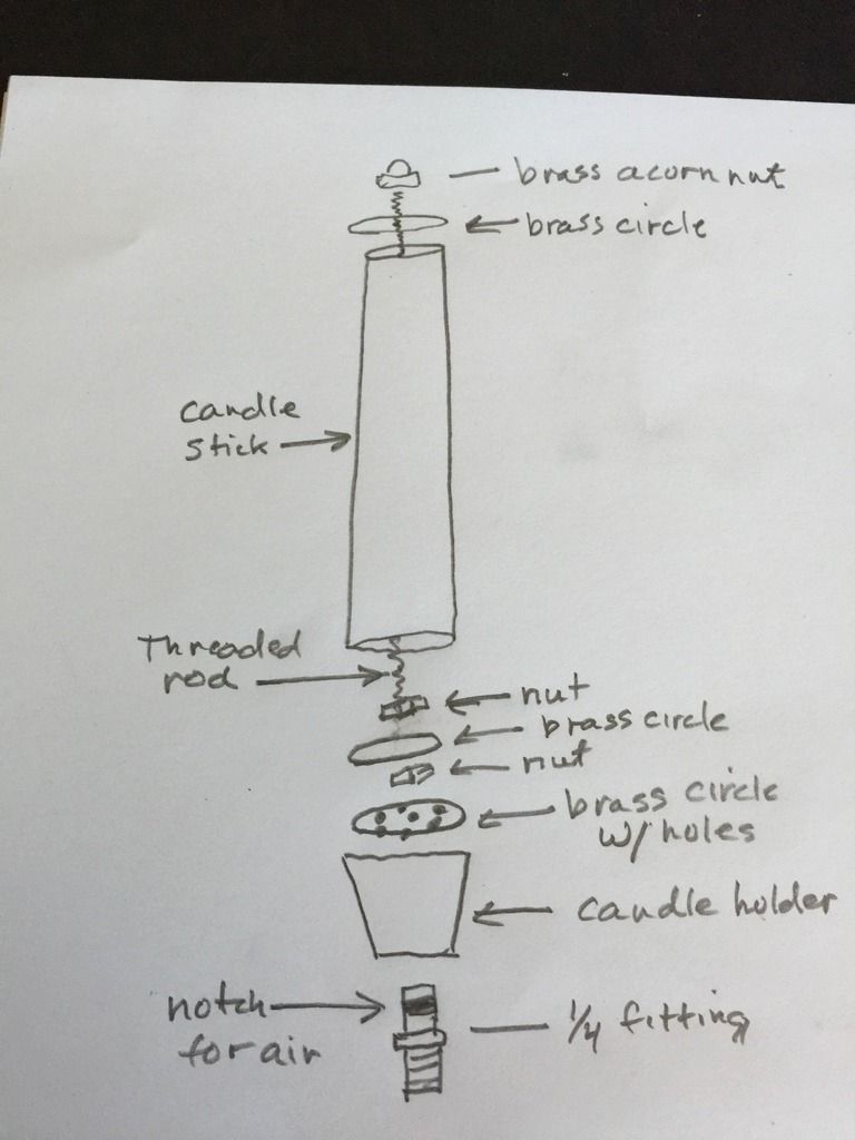

The concept is a single chime whistle using the tube and candle holder. the candle holder was tapered ever so slightly large than the tube. It would act as the bowl of the whistle and the tube as the chime.
The disks will be used for the top, air chamber and the wind way. Use of a 1/4" fitting modified to hold one nut and also allow air out the side of one threaded portion, a threaded rod and a few nuts to hold it tight. Here is a drawing.
All this was done with scissors to cut the brass sheet, a drill and small torch to solder the parts together. Once all put together, I tuned it by raising and lowering the chime, or in this case the candle holder tube. Now when someone says you cant make a single chime whistle out of a candle stick,bet them a hundred bucks and send them to me.I get 60% of course.
