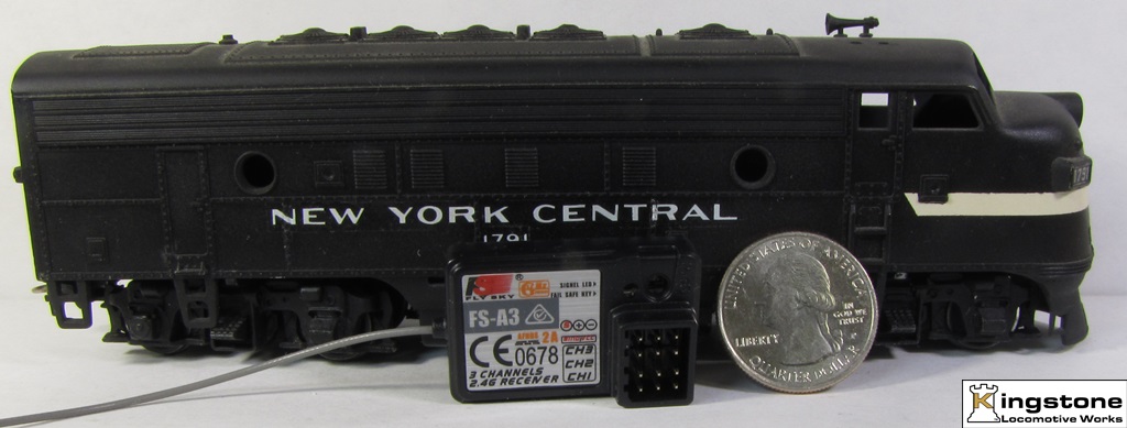

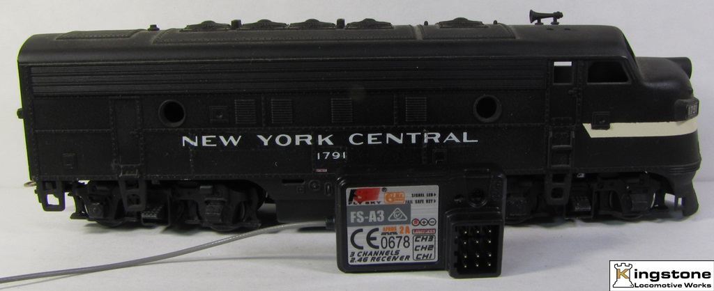

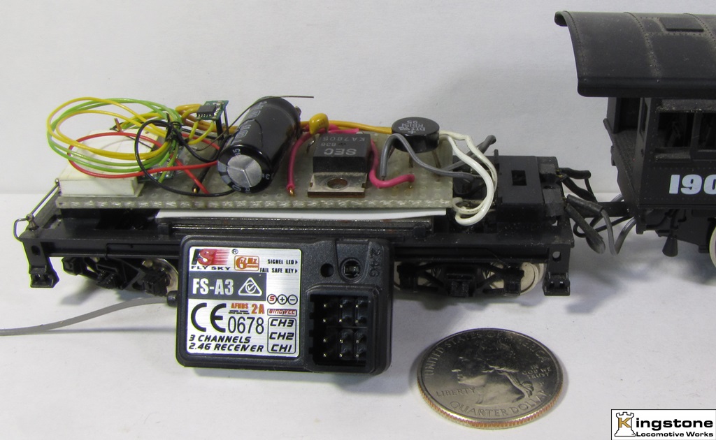

Hi Rickie.
I wasn't aware of the Fly-Sky either until a couple of days ago when browsing the Freerails forum. I checked it out and am going to give it a try. Right now I'm waiting for the Electronic Speed Controller to arrive.
Here are three pictures of the Fly-Sky receiver with some size comparison models and a US quarter.
The Atheran unit the system is going in.
The Atheran unit, receiver and a quarter.
And the tender of a IHC 2-6-0 steamer.
Mounted in the tender is a 5 volt regulator, an ADD2 Deltang board and the RX mounted in a sandwich of styrene.
I think they should work out OK. I'm going to remove the plastic case on the receiver. Should make for needing a bigger space. It will all fit into the shell of an wide-body engine without a problem.
