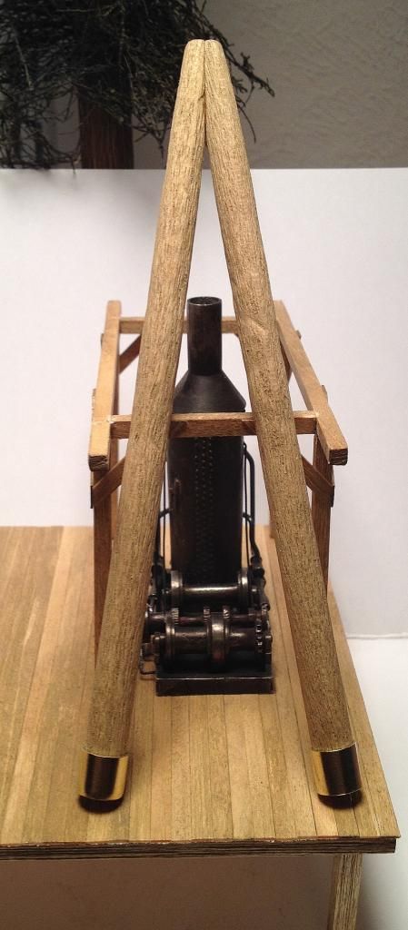

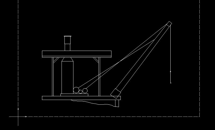

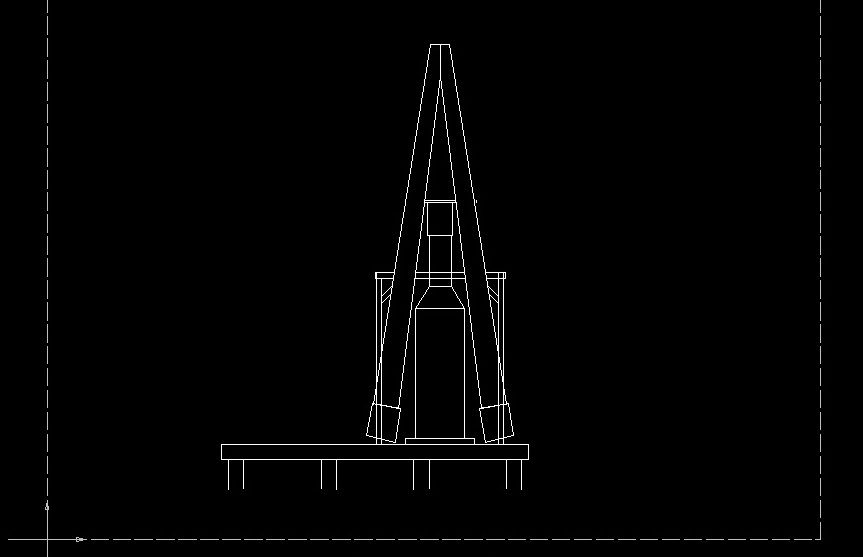

Next I started on something to get the logs off the cars.
It's a scratch/kitbash.
I like Bretts layout of the unloader in the twin mills kit.
Using that as inspiration I drew up a plan and am using a steam engine from a KMP donkey engine kit.
As of this morning I am to this point.
Lots to be done yet.
A start on the booms.
Cheers

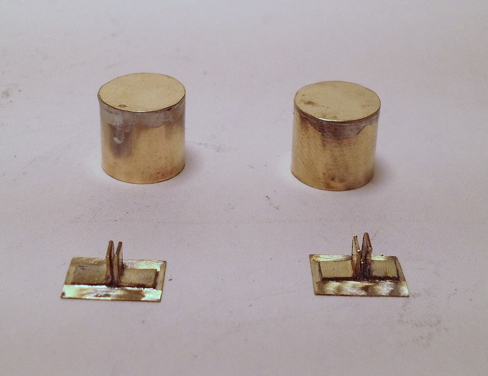

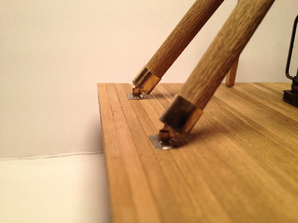

Today was spent on some fiddly bits to mount the booms.
I capped the ends of the tubes and made these mount bases.
Then I made corresponding tabs and soldered them onto the tube caps, and then soldered all the bits together.
They may not be perfect, but I think they look the part, especially from 3 feet away. lol

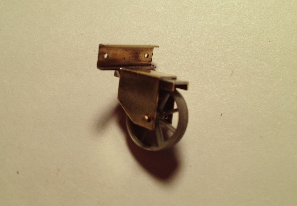

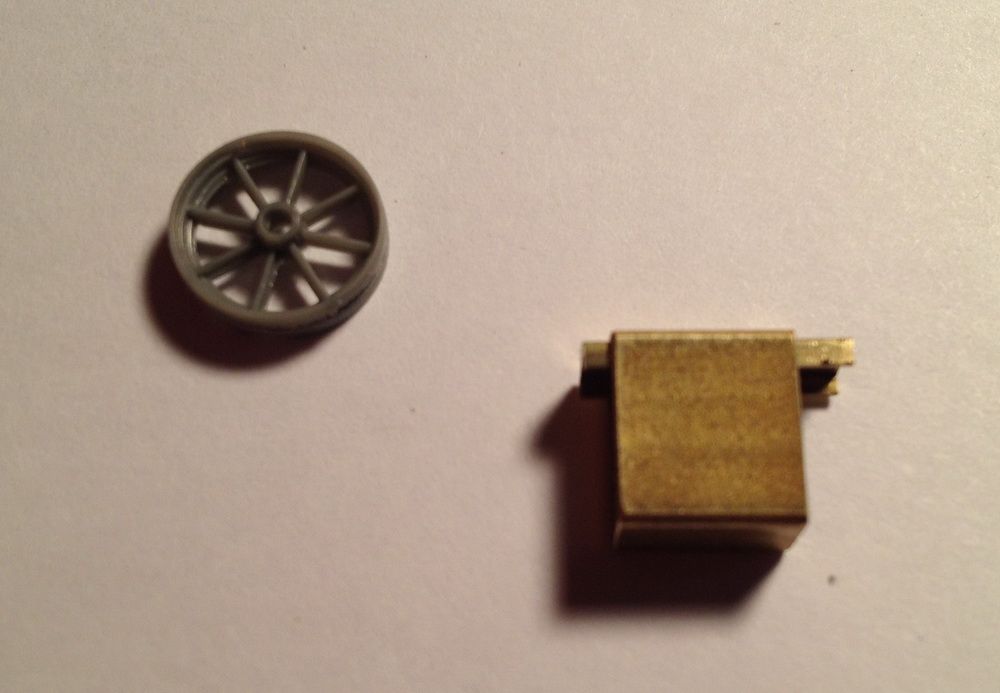

I had planned to use a block for the cable on the booms.
Turns out I did not have one on hand.
As I often find myself doing while I am in the process of building something logger....I put myself in the shoes of the blacksmith.
The boss comes by and says " We need such and such for this and that. See what you can come up with using whats laying around."
So I go to my parts bin and rummage around.

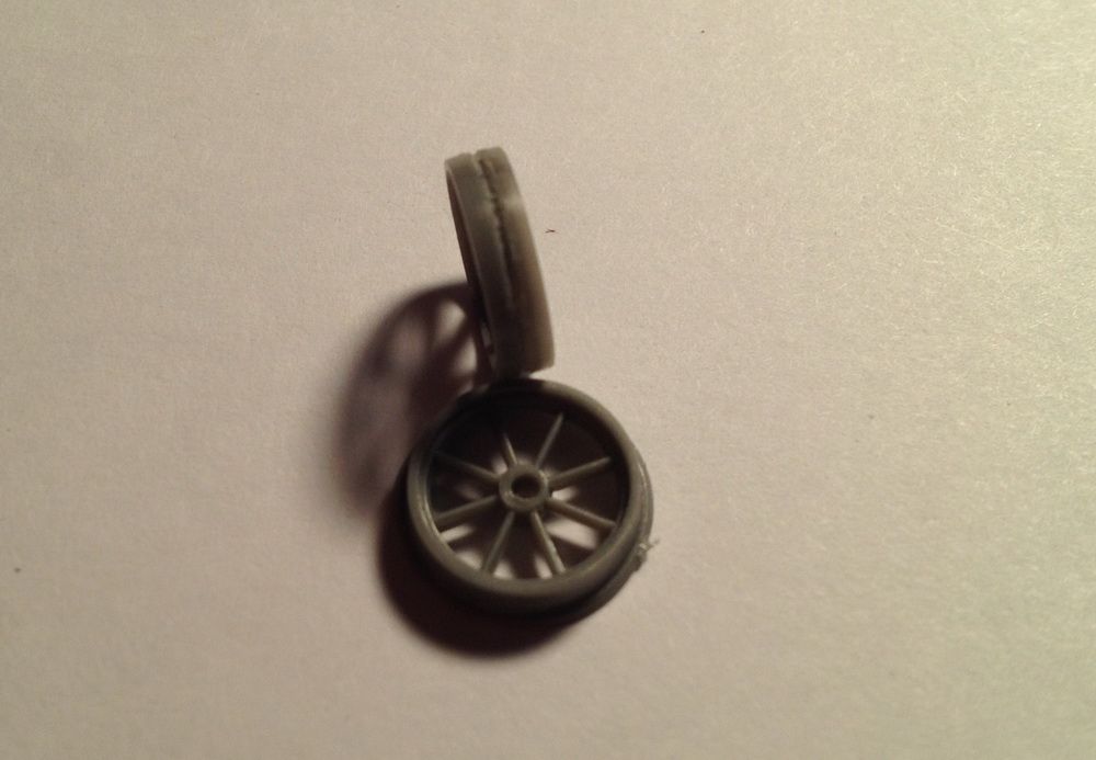

I had some metal castings for the wheel but they were either too big or too small.
Then I found a pack of Grandt line spoke wheels.
I popped a toothpick in my Dremmel and wedged the wheel on that. Using a fingernail file I ran the Dremmel and sanded the flange of and then with the tip of an Exacto blade I made a groove where the cable would ride.
Now that I had a wheel, I needed something to mount it on. I cut a piece of brass tube stock to start with.
While I was cutting that, I noticed a piece of channel cut off from bits I had cut earlier for cross braces on the booms, and saw it fit inside the tube I was using. I slid it inside the piece and liked how it beefed up the look of the whole bit.
Back at my workbench I cut one edge off to make a long walled bit of channel and cut an angled bit off both walls to make the wheel bracket.
Then I drilled holes for the axle, soldered the small bit into the larger bit, and those to one of the cross braces I had cut earlier to finish it off.
I really like how it turned out.
The paint is drying now.
Country: USA | Posts: 1058 Go to Top of Page
