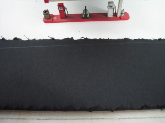

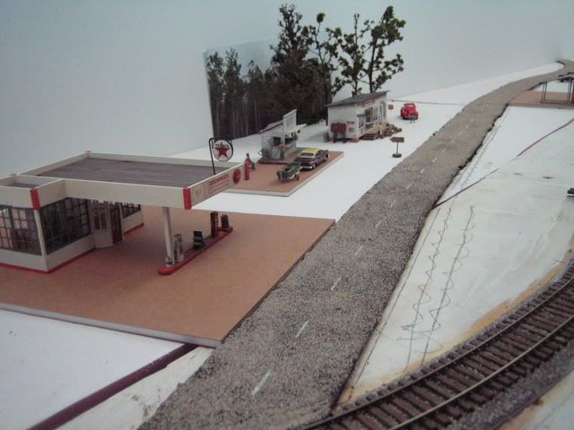

I recently finished a tar and gravel road on my layout and posted photos under my Royal and Edisto RR thread. Here's a short tutorial if you'd like to try it on your pike. First, a shot of the finished product.

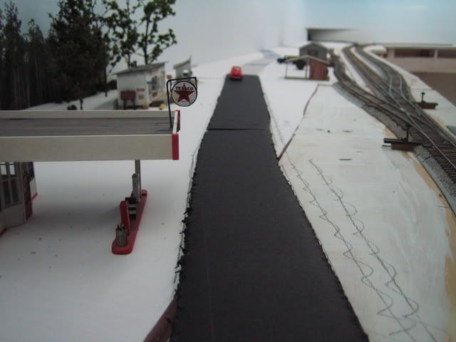

To make a tar and gravel road I started with black foam core left over from another project. I cut it to size with scissors which left a nice jagged edge instead of a clean one the way a knife cut would.
Then I tore off the paper top exposing the black foam center.

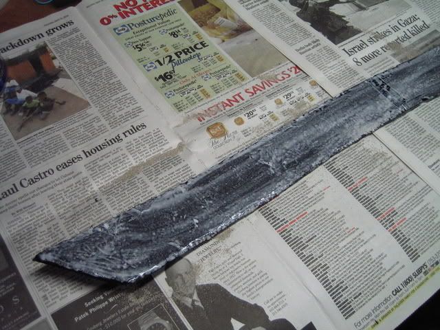

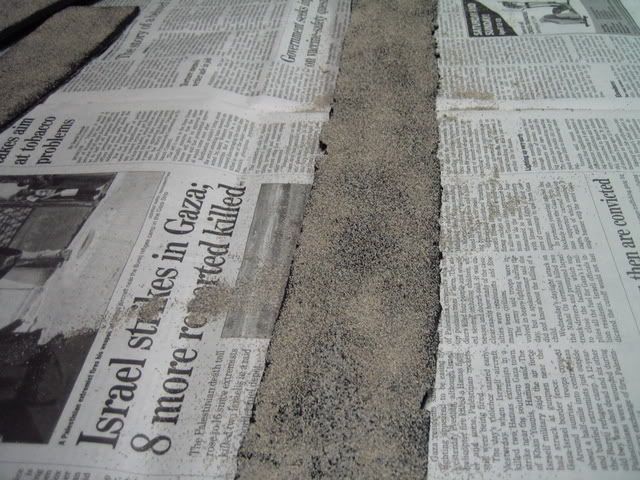

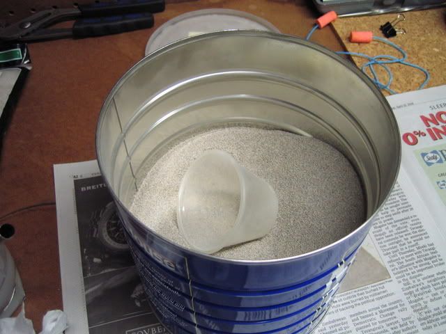

I brushed on white glue and then sprinkled on fine ballast. I made my road at the workbench.
The mixture is 2 parts light gray, 1 part buff and 1 part gray.
Using my fingers I lightly covered the foam surface. In fact, it looks realistic to have a little of the black (tar) show through in places.

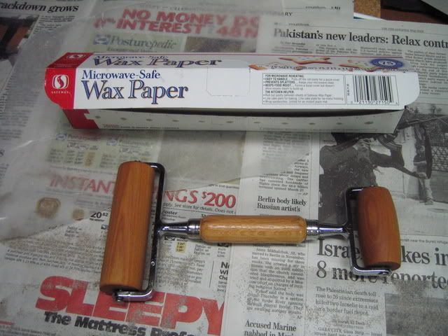

Let this set for 10 minutes or so and then use a sheet of wax paper and a roller of some kind (I used a pizza dough roller but you can use a rolling pin or a large dowel) to flatten down the surface. Since the foam is soft, some of the ballast will get embedded into it.

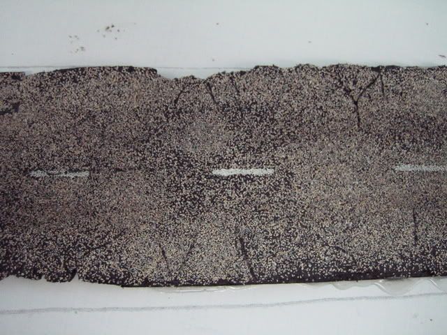

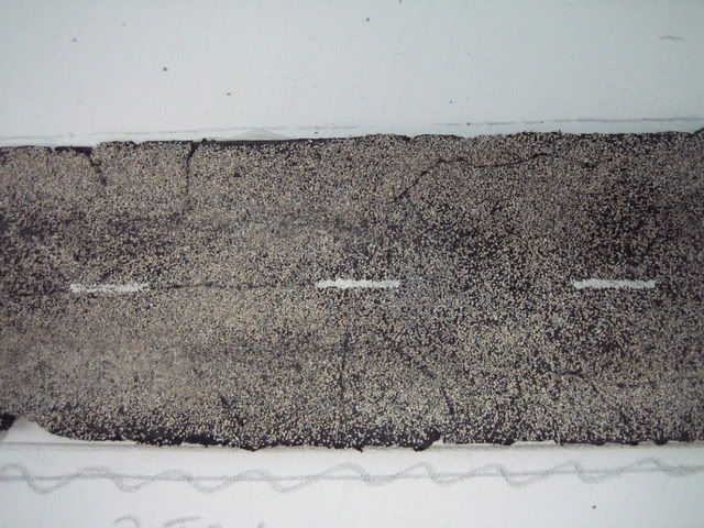

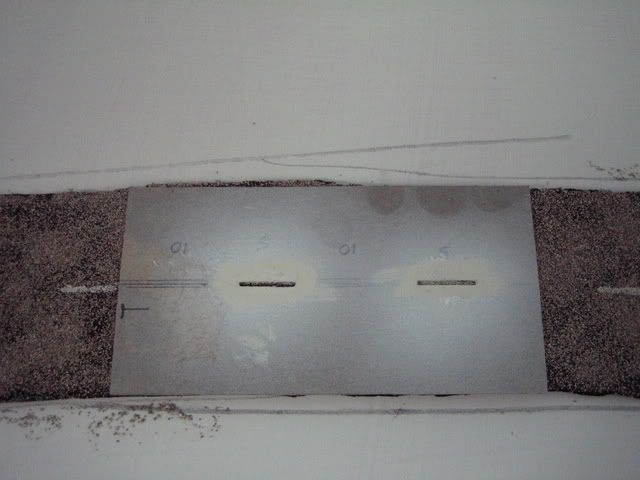

After the glue dried I had to touch up some of the seams with more glue and ballast. Once everything dried I painted the stripes using an off-white craft paint and a homemade mask. (Use full strength paint and a stiff brush to stipple the paint, almost like dry brushing.)
My stripes are scale 5 feet long and 6 inches wide. The stripes are 10 feet apart. I donít know if this is prototypical but it looks right.
I used a fine point roller marker to add the black cracks. The final touch is to lightly brush on some India ink and alcohol to darken the travel lanes.
