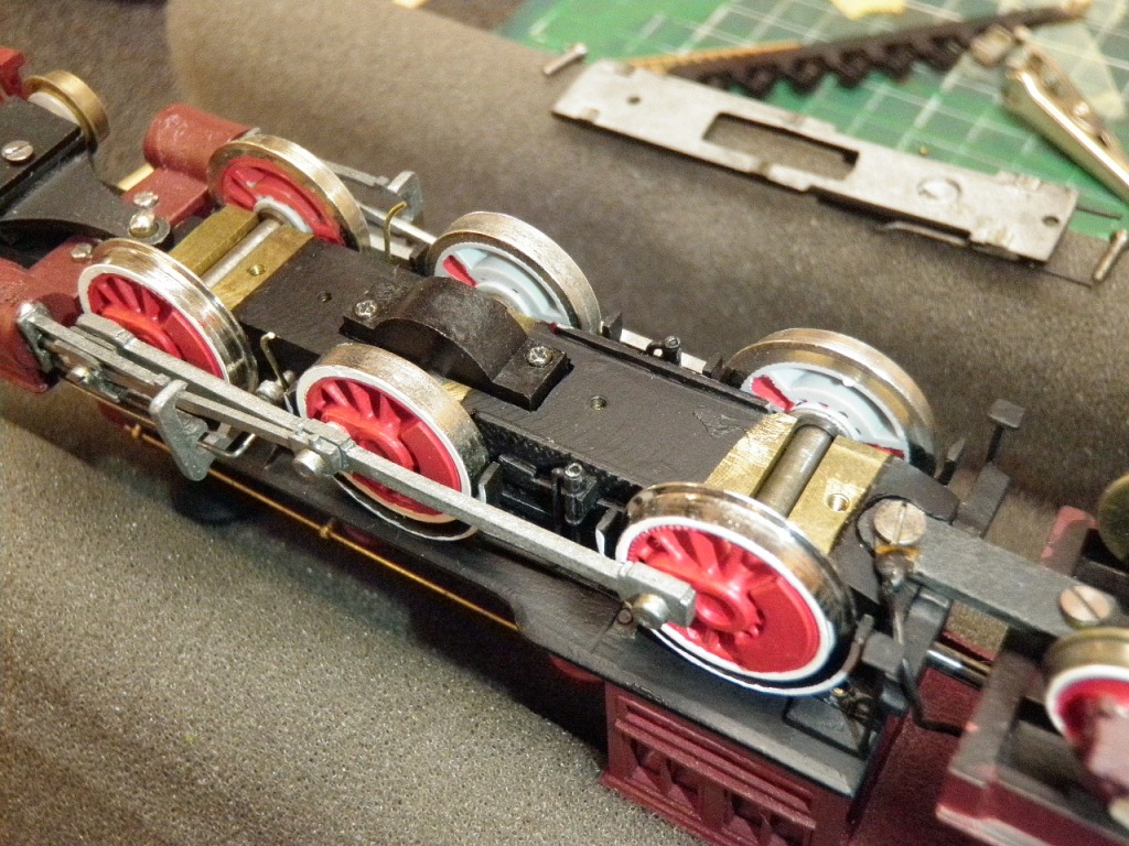

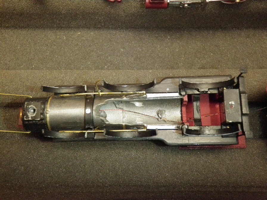

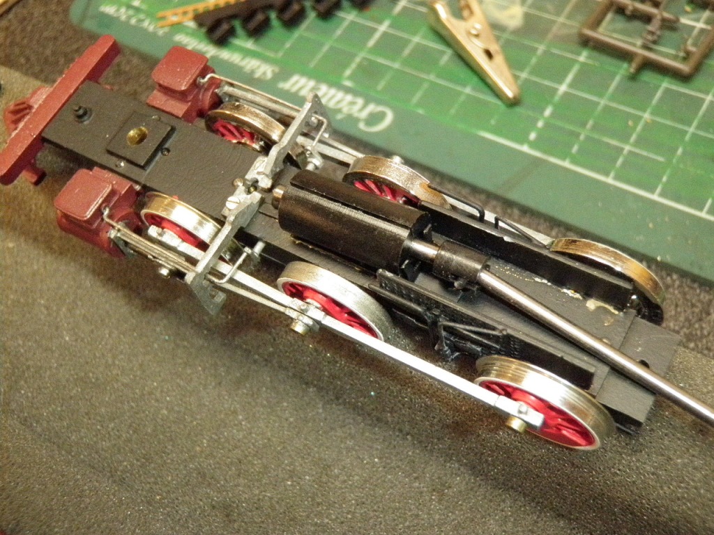

Hello Dave, the 4-4-0 runs very well although it is a bit noisy due to its open gear. It has the open gear with shaft and bearings and a can motor (Sagami I think) that came with the kit. The motor is in the tender. The 2-6-0 also runs well but on this I had to have a new frame made as the one that came with the kit was badly warped. I had the frame done by another modeler here in Sweden who milled me one from brass. It had the same gear configuration as the 4-4-0 but I used a NWSL gearbox instead and kept the motor in the tender.

Hakan, I'd love to see a photo of the milled frame and motor in your 2-6-0, if that's easy to do.

Here are some pictures of the frame. The motor is in the tender and is only attached to the tender floor with a elastic compound.

Thanks!! That helps me understand how the gear tower fits into the loco.
