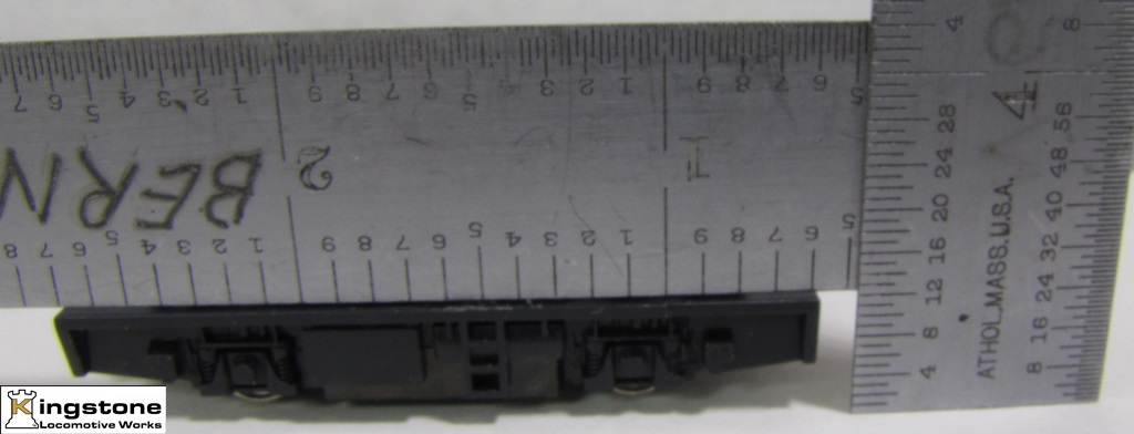

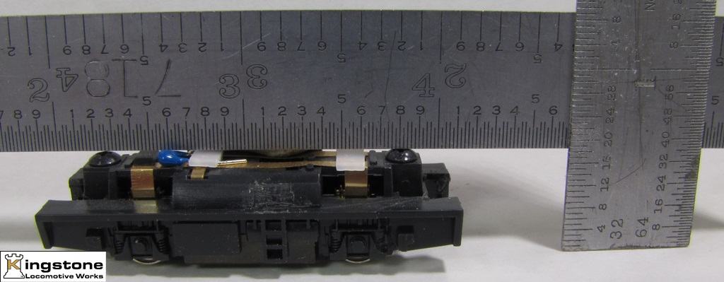

Hi Guys anyone have a Kato 11-103 or 104 mech handy?
I need a measurement as im waiting for mine to come in the mail. Im after the height from rail head to flat deck? Would be very handy right now as im working on some drawings for a hon30 brass boxcab bash

Hi Adrian,
I used that Kato chassis for my HOn30 electric box cabs. Great running units. Can't wait to see what yours will look like.
It looks like you'll need about 5/8". The measurement is from the flanges up. It would be 19/32" from the rail head up. The flanges measure about 1/32" deep. The blue capacitor sticks up over the plastic deck as well as do the two screws.
Hope this helped.

Posted - 06/03/2016 :  07:51:39 AM  Show Profile  Visit Bernd's Homepage  Reply with Quote
After I posted I realized I had the wrong deck. Here's another measurement. The measurement is 3/8". So minus the 1/32" flange height would make it 11/32" from railhead to flat deck.

Hi Bernd' Thanks for that picture! Just what i needed. I had a bunch of space left on an etch sheet and thought i could fit something cool for a little hon30 loco. now that has blown out a little into a full sheet of etchings around this mechanism for a boxcab and 2 other small locos :-)
