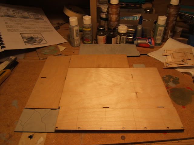

Thanks for watching so far. I added more layers to the foundation today.Again it feels like cheating since all the new parts are of the peel and stick kind.
Then again I doubt you could get such a neat joints if you had to smear glue on the parts and press then together. The instructions warn that the adheisive on the part is industrial and gets stronger the longer you have the parts together, so you had better be sure that you have the parts in the right place before you walk away for the evening! There are more parts to add so these layers don't have to be painted
Next is the floor boards...

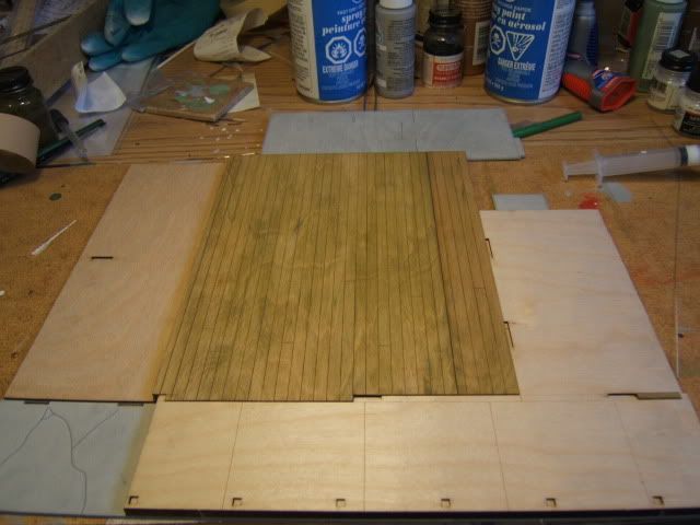

I stained and added the interior floor to the kit.
It was stained with floquil's natural pine. Again it has the peel and stick adheisive on it so it was just a matter of lining it up and placing it in the right place.

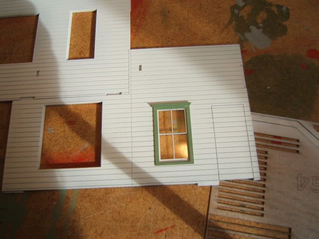

I'm almost finished painting the white walls. Most of the exterior walls are finished with their paint. There are just a few that need a second coat. I've gone through 3 bottles of testor's model master flat white so far. hopefully one more should do it. This is the front wall, completed
I'm going to add the doors and windows before the walls go up, since it will probably be easier this way. Once all the painting is done I hope to move a bit faster o the build.

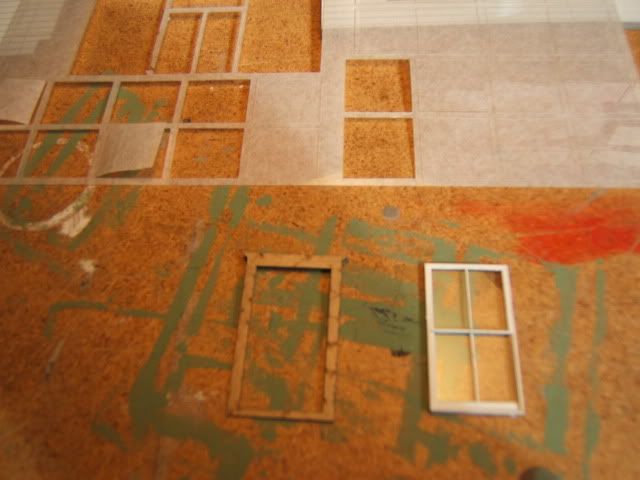

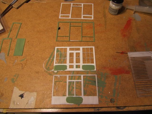

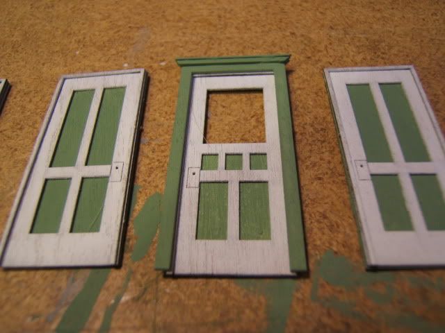

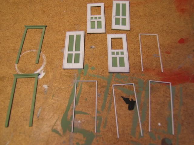

I've been working on the windows and doors the last couple days.

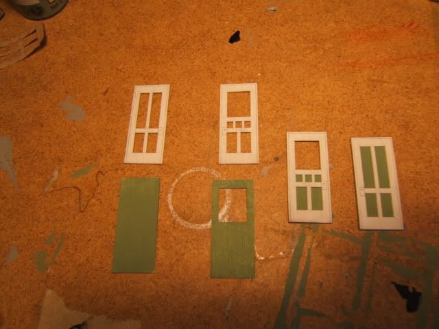

The doors come in 4 parts, the back, front, a very small frame shim and the frame. I painted the back in wedgewood green and the front in white . Again these parts all have the peel and stick on them so assembly was a snap.
The small shim piece is to set the door a bit back from the frame for a more realistic look. I find that the wood in this kit is fairly 'thirsty' and soaks paint up readily. However that allows the grain to show through the white for some un-intentional weathering

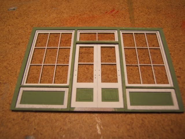

The main front door and window is also made in four parts. I painted a couple parts for effect.
Then assembled them:
The glass (glazing) if also lazer cut and fits perfectly in the window openings. Again no glue required.

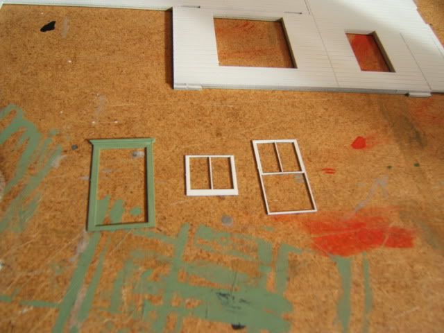

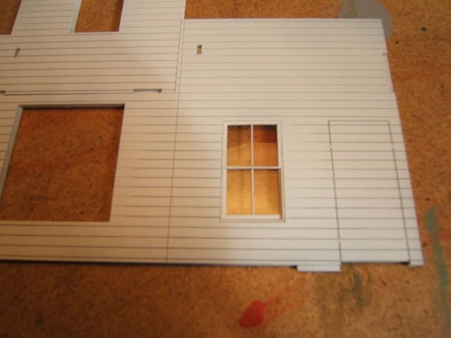

I moved on to the windows this afternoon. They come in three parts.
Again it is all peel and stick to assembly is simple.
Attach the two inner sashes together and add the glazing to each part:
Install the window in the wall openning, it's usually a tight enough fit that it will just stay in by itself:
Add the frame around it and carefully press the window back into the adhiesive on the frame

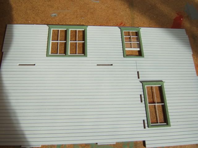

I finished one of the side walls. The upper window is open simply be positioning the lower sash in the open position and trimming the top window glass to size

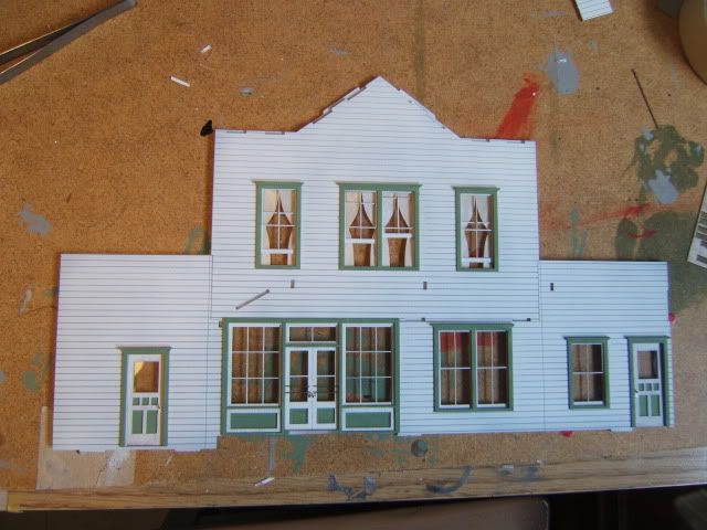

I finished the window and door today.
The front main door/ window assembly was finished and placed in the front wall. I added the lock plates and door knobs to all the doors. The kit also comes with curtains for the upper windows. They're laser-cut as well and fit perfectly.
Next I get to start putting walls up!

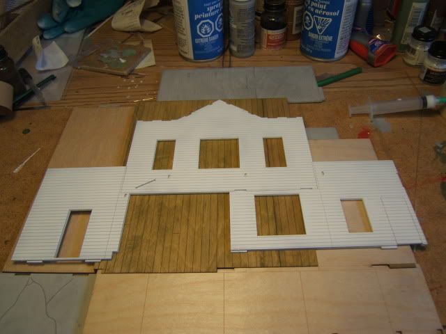

I got the first walls up today
The instructions say to put the front, two sides and the second floor support together at the same time. The eileen's tacky glue comes in handy here because it takes a couple minutes to get everything aligned in the slots and tabs before the glue sets up.
The angled support on the right side is for the bar lean-to that will be added later.

Did the cutains come with the kit?

The Curtains did come with the kit. They are laser cut to fit inside the window frames. They have a slight gloss pattern on them so they don't look like a flat sheet of paper.
