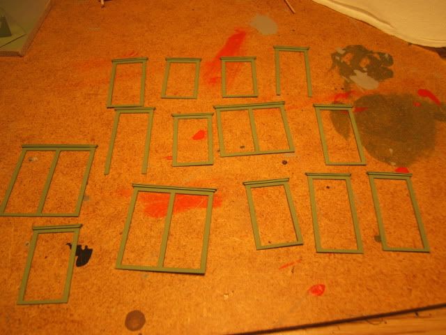

This is a straight from the instructions build with minimal weathering. I'm painting the building white with a faded green trim and window and door frames. The first thing to build is the window frames, adding the crown molding.

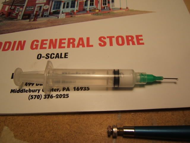

Raggs to riches supplies you with a sringe for the applying glue. I was skeptical about using it at first but the glue appilcation control you have using it is definetly an improvment over my former toothpick method.
After the glue set I primed and painted the frames

Let us know how that glue applicator works out. Are there any issues with the glued drying in that tip?

How that syringe is working for you? Last time I tried using one glue just dried up and I had to throw syringe away.

How do you stop the glue (PVA or whatever) from gumming up the syringe?

So far I haven't had any problems with the glue drying in the tip. The needle part is removable and the instructions state that if the glue does dry in the tip to just remove the tip and ream it out with some wire. As per the instructions I'm using Ailene's Tacky Glue, which gives a decent set time and is paintable when it dries.

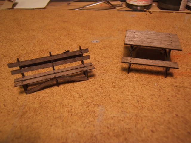

The first first number of steps in the instruction deal with building sub-assemblies that should be painted after assembled. I started with the bench and picnic table. Both were easy builds (After building simular structures in HO)
I used the glue sringe and it worked great, allowing me to get just enough glue on the joints with very minimal squeeze-out. After the glue dried I stained them with Flo-stain Walnut (from my secret stash!)

The bench and picnic table look good.
The trick to keeping the Raggs recommended Aleenes from stopping up is to plunge it slightly a couple times daily when not in use. The tip will stop up quickly if you don't. When its empty, clean it out with warm soapy water. Mine lasted a couple of years.

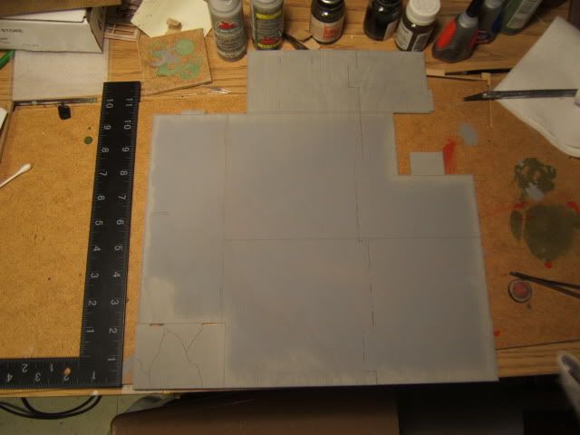

I built and painted the foundation over the last couple days
The foundation come in two parts (I guess to fit in the box!)I primered the entire foundation with grey walmart primer and then sprayed Apple barrel Country Grey on the parts that will be visible on the finished model. The floor will be laminated onto this structure.
