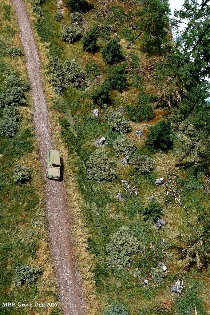

Thank you Bob, Bill, Ted and Frank.
diorama is now completed/finished( with a small country road )
[url=https://flic.kr/p/YQ7TW7][/url][url=https://flic.kr/p/YQ7TW7]jurgmodules28mei2016bklform[/url] by [url=https://www.flickr.com/photos/153065234@N07/]Jos Geurts[/url], on Flickr
and " drone view":
[url=https://flic.kr/p/YQ7TRY][/url][url=https://flic.kr/p/YQ7TRY]jurgmodules28mei2016cbewerkt[/url] by [url=https://www.flickr.com/photos/153065234@N07/]Jos Geurts[/url], on Flickr
Jos

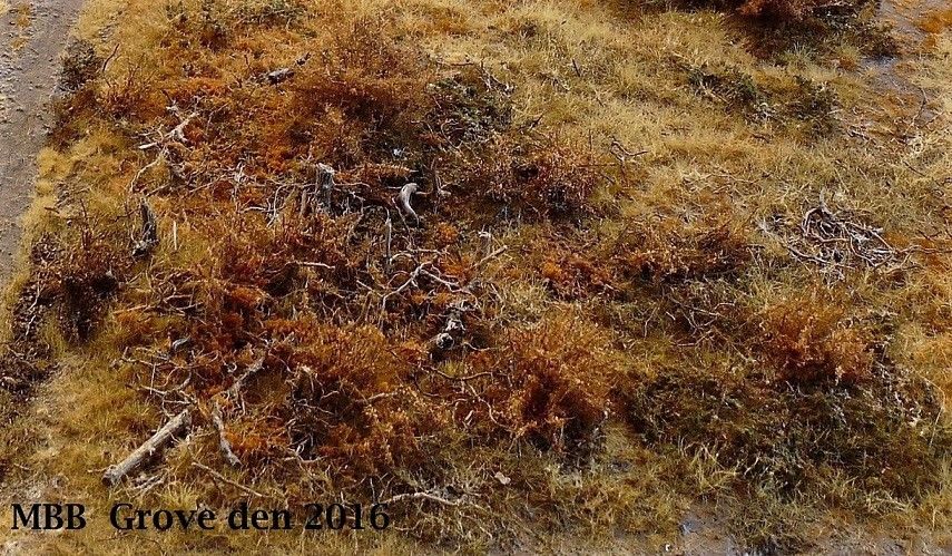

scotchpine
Posted - 10/16/2016 :  6:22:58 PM  Show Profile  Reply with Quote
Thank you 3 times Munch! =) and Bill too of cours.
Yes Bill I alredy read your messages- several times- in your thread about your weeds!
Still working on it and adapting to our most common weeds overhere...incl the Solidago spec.! ;-)
just a detailshot of the small diorama:
and some more spruce trees H0:
[url=https://flic.kr/p/21uFfz6][/url][url=https://flic.kr/p/21uFfz6]rudolffichten30jan2015a[/url] by [url=https://www.flickr.com/photos/153065234@N07/]Jos Geurts[/url], on Flickr
Jos
Edited by - scotchpine on 12/08/2019 3:12:08 PM
Country: Netherlands | Posts: 350 Go to Top of Page

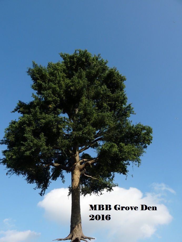

scotchpine
Posted - 10/30/2016 :  03:19:27 AM  Show Profile  Reply with Quote
Tall to handle but small in ( scale)size:
1:32 tree. 14 inches
[url=https://flic.kr/p/2hWGN8r][/url][url=https://flic.kr/p/2hWGN8r]beukRoman25juni2016 klform[/url] by [url=https://www.flickr.com/photos/153065234@N07/]Jos Geurts[/url], on Flickr
Jos
Edited by - scotchpine on 12/08/2019 3:18:48 PM
Posted - 10/30/2016 :  09:11:41 AM  Show Profile  Reply with Quote
Impressive! and although it is tall, it looks light enough to float on air :)
