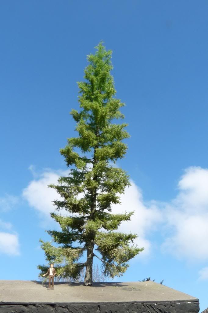

Posted - 02/19/2013 :  04:56:10 AM  Show Profile  Reply with Quote
It's funny, Jos. While I thought it looked bigger than its HO counterpart when still unfinished, I think it looks MUCH bigger after the last addition of needles.
And beautiful, too.

scotchpine
Posted - 02/20/2013 :  05:32:08 AM  Show Profile  Reply with Quote
Thanks Frederic,Frank, JvB,Brownbr!
Martin: yup it is realy fun working with this "magic" stick......!
As promised the picture in real good sunlight!
Jos

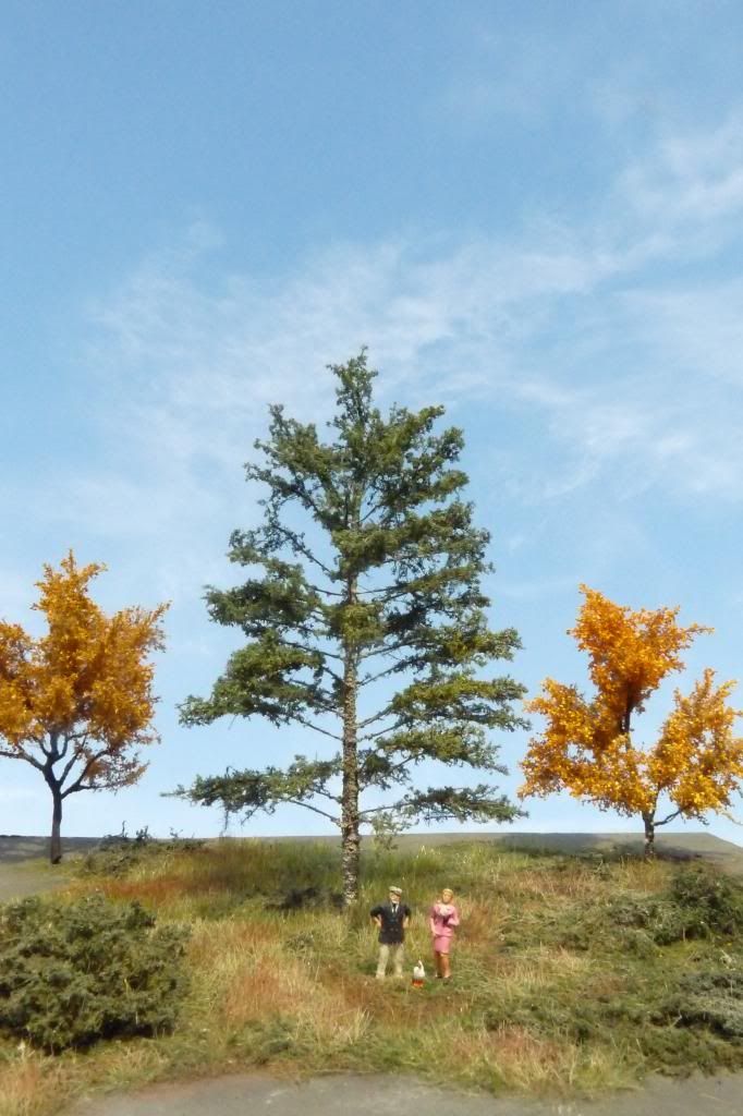

scotchpine
Posted - 02/22/2013 :  05:08:02 AM  Show Profile  Reply with Quote
Thanks Wesley!
Some small H0 ones...
Still no needles= fine turf Woodland S.
But within 10 minutes :
Voila!
Jos
