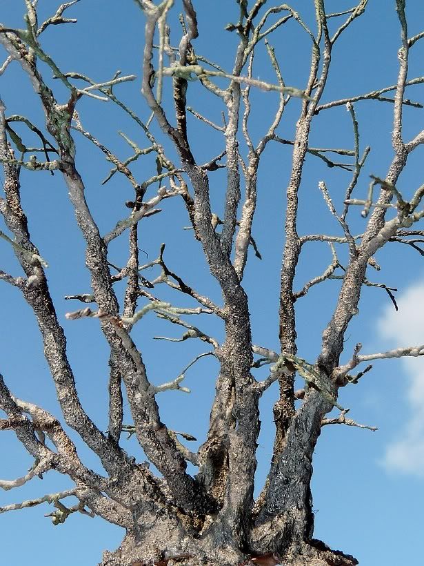

Posted - 10/14/2011 :  4:44:06 PM  Show Profile  Reply with Quote
After showing some big O or H0 trees now some smaller ones: N scale.
Not ready yet. Only the foliage....
Gnarled old limetree and 2 "younger" ones:
base of the treetrunk(s) are max. 4 1/2 cm= < 2 inches. Hight= 5 inches
the other 2 lime trees:
5 inches high
Jos
Country: Netherlands | Posts: 332 Go to Top of Page
wirten
Posted - 10/14/2011 :  5:10:08 PM  Show Profile  Reply with Quote
Jos,
I think you wrote somewhere in the beginning of this thread that you used Florist Wire that was 0.6 mm thick.
The thinnest I seem to bee able to find is 0.8 mm. Have you tried thicker wire and deeemed it worthless or is that just something you tried and it worked?
Iíve also had trouble finding the aquariumfibre, but Iíve seen the pages that Marty and Fredrick has been discussing (if thereís something left now),
The aquarium fibre Iíve encountered has been much like Steel Wool, yours seem a lot easier to work with. Iím I right?
No need to say I guess, but the gnarly Lime trees look gorgeous!
Anders
Country: Sweden | Posts: 70 Go to Top of Page
scotchpine
Posted - 10/14/2011 :  5:37:46 PM  Show Profile  Reply with Quote
Hello Anders,
For the "bigger" scales I use indeed the 0,6 mm floristic wires...for smaller scales , like N, I use the 0,4 mm.
I use the 1,2 and the 1,4 mm wires as "corewires"
A "central" wire on wich I twist the smaller/thinner 0,4 or o,6 mm wires...
yes the fibers I use right now are ,well kind of, softer/more thin....
Thanks!

scotchpine
Posted - 10/16/2011 :  05:04:19 AM  Show Profile  Reply with Quote
Hello Mike,
Watching the picture in the link you gave about that aquariafilterfibers...
I think they look like they are a kind of thin and too "curly"(?)
It looks like the Woodland Scenics fiberstuff, when using these kind of fibers by chopping them into smaller parts and add them to the branches, is a lot more "work" than using the stronger/thicker ones like the"Decotwister"/"Wooly" fibers.
These fibers are heavier and of course/therefore can fall easier on and over the branches....
Also the don't stick together that much as the fine chopped fibers from W. Sc.
But with these fine fibers the results can/will be as good as the decotwister/wooly fibers...
It is just one way of manyto get to the finalresult : a selfmade realistic tree for on your layout!
Jos
