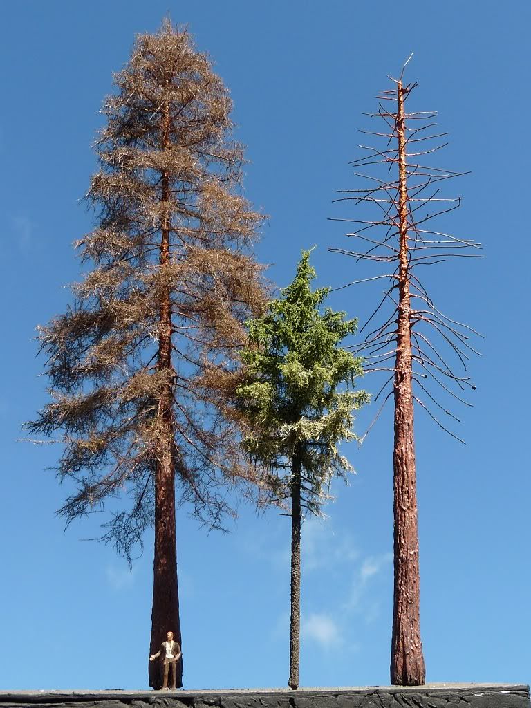

Here a picture of the sequoia under construction;
I still had to remove the loose and to much fibers .....by using tweezers and shaping the fibers with a sharp pair of siscors...
I also think, Martin, that you don't have enough branches on that trunk....
Also try to cut the fibers in lenhts of 1-2 cm and than glue them on the branches with some sprayglue....the tree I see on your picture looks like it is overdone with fibers....
Here a picture after "cleaning up"the loose fibers and adding some 6 mm grassfibers over the decotwisterfibers that were left after my "cleaning up" I also painted( sprayed) them in a brown/dark color.
and added some fine turf from WS or any other kind of needles/leaves.....

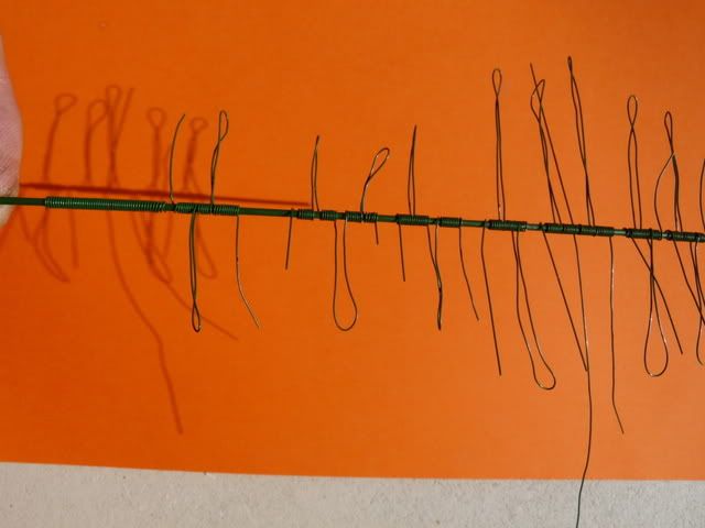

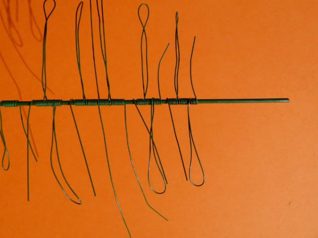

I use, as you mentioned already, a "main corewire"...around that wire I built op the branches.....by making loops...
Watch the pictures carefuly and I hope it will be
claer how I "twist"the wires to become a nice straight trunk + branchesframe
first one is the base of the treeframe= trunk with "dead"branches
next one is the top:
As you can see I gently tore the wires apart some mm...to show how many loops you can make out of one wire each = 40 cm long.
When glueing the frame with cheap "superglue" I slide the twisted wires firmly + carefuly against each other.
So when frame is ready you've got a 2 dimensional frametree.
I bend the first/highest "branch" straight up as the topbranch...and cut away the corewire wich is to thick comparing with the branchwires I use...( of course this is not that important, just small details...
When superglue is dry ( at least an hour!) you can bend the wires in shape...

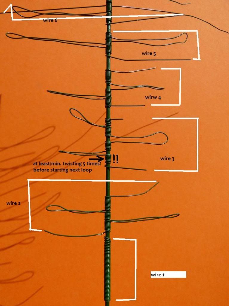

Maybe I misinterpreded the hint "two wires" in the bottom part of this image :
Also I shall have to wait a little for the sawdust since even the most finely ground I have is still a bit coarse compared to what your pics show. I suppose I'll have to try to locate a thinner sieve...
scotchpine
Posted - 09/19/2011 :  4:38:58 PM  Show Profile  Reply with Quote
Yes Frederic, I know ...I had to write: 2 seperate wires...twisted on/over the core wire.( lucky me my english improved just a little bit!)
