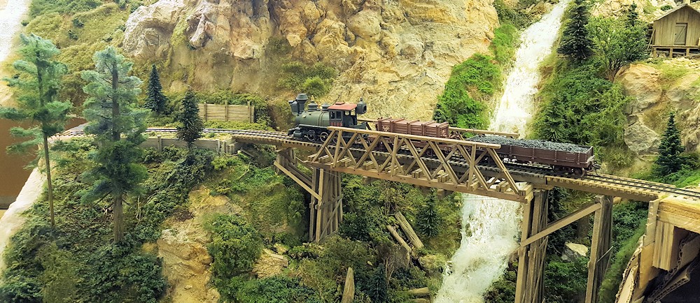

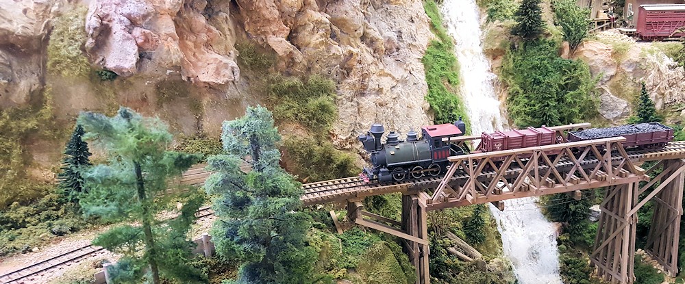

Just for the fun, two shots of a train crossing the chasm. I could have done them earlier, but I couldn't locate the roof of the switcher (it was hidden in one of my many drawers...).

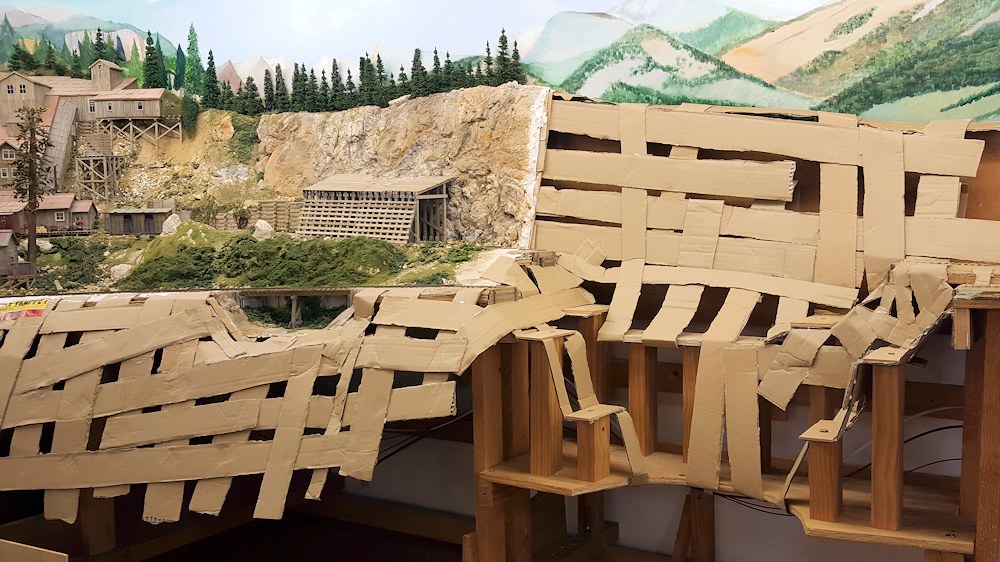

And the start of the cardboard lattice. Quite modest yet.

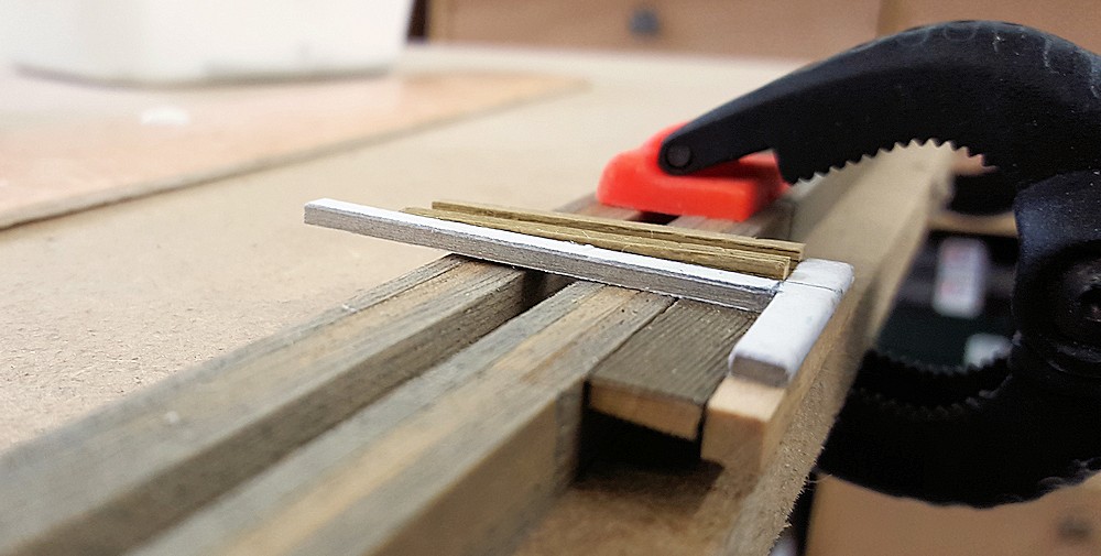

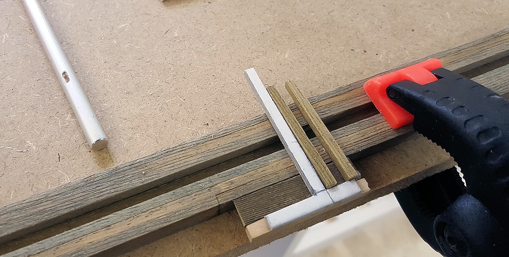

Fred's latest jig : the "trestle tie locator".
As usual, machined from the most sophisticated materials as you can see.
Probably not precise up to the nanometer, but enough to position and glue the nearly 75 ties of the first of the two bridges, the building of which I am facing now...

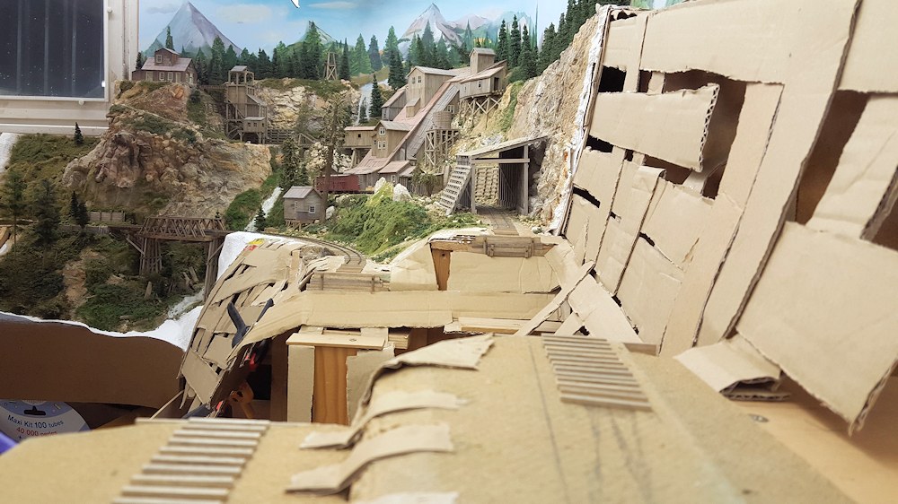

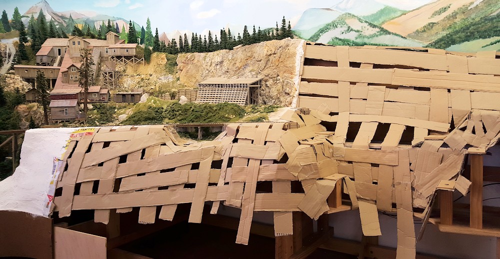

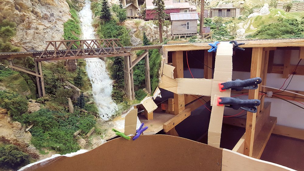

Speaking of construction, here are a few shots of the making of the new chasm and mountain. Lots of cardboard and white glue, a bit of patience. The pictures show the result of three work sessions. It's interesting to think of the way one will shape this mountains.

It's an interesting part of the hobby. Less easy than one could think at first sight, especially when you have to deal with very vertical - almost overhanging - cliffs.
Anyway, the cardboard operation is going on and things are starting to take shape above the lake, and in the twin bridges area (twin but dizygotic )...

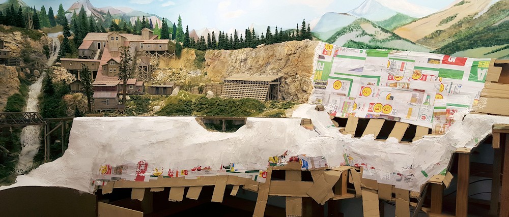

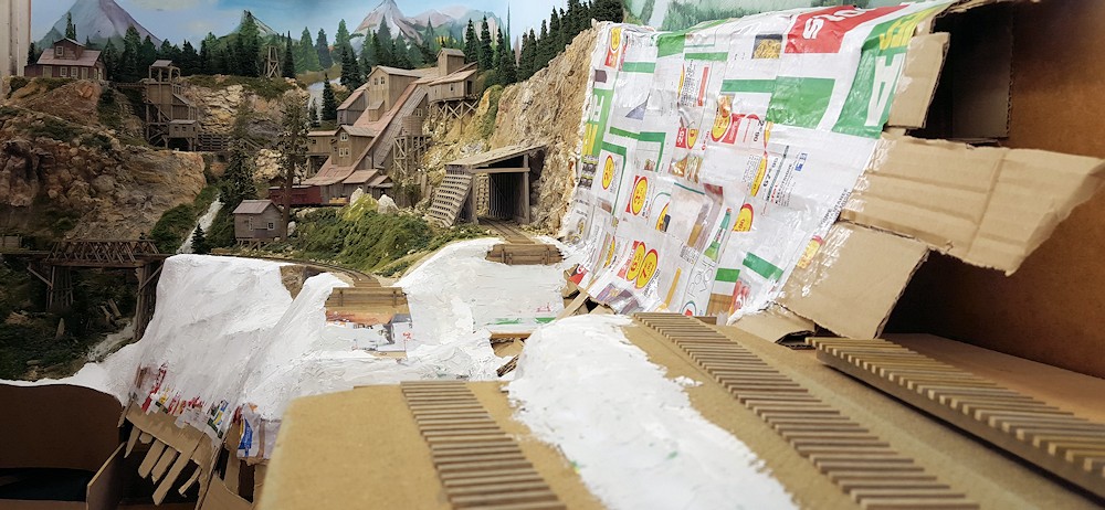

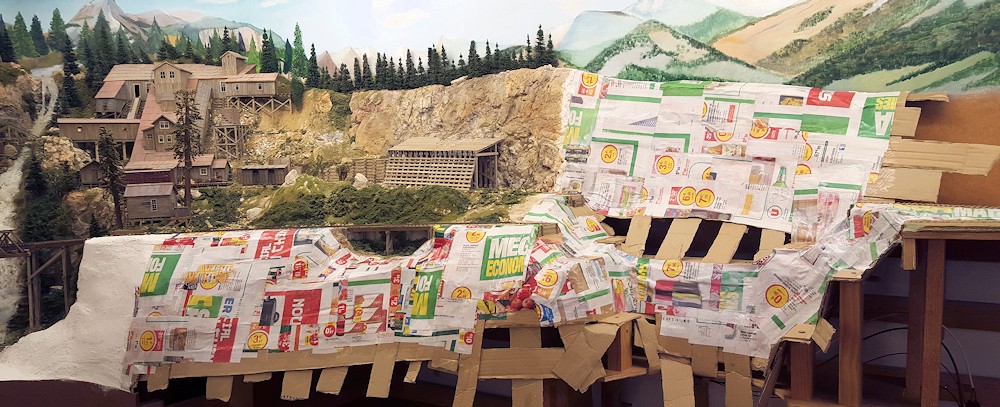

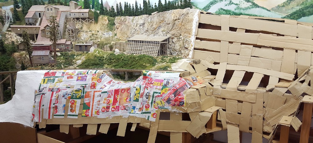

Some slow progress these past days : the end of the cardboard substructure, followed by the glueing of paper sheets (we receive tons of adds in the mailbox, here is one of the rare occasions when they happen to be useful), and a spackling step before applying a first coat of paint. You may wonder why the cardboard seems to stop in the empty. It's because I don't want to install yet the fascia board since I'll have some trackwork to do on the right part, which will be an easier job without this board interfering. In all rationality, I should have done it first but first I wished to see how the mountain would look, and second it seemed reasonable to add this part of the track after the bridges, which should be installed after the rear mountains.
Here are a few shots of my past four days work.
Cardboard hardshell complete.
Adding adds sheets.
And after a bit of spackling.
