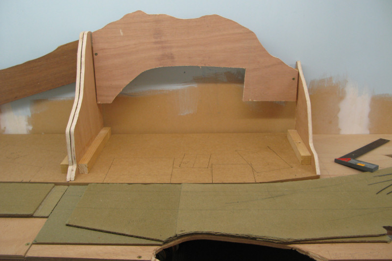

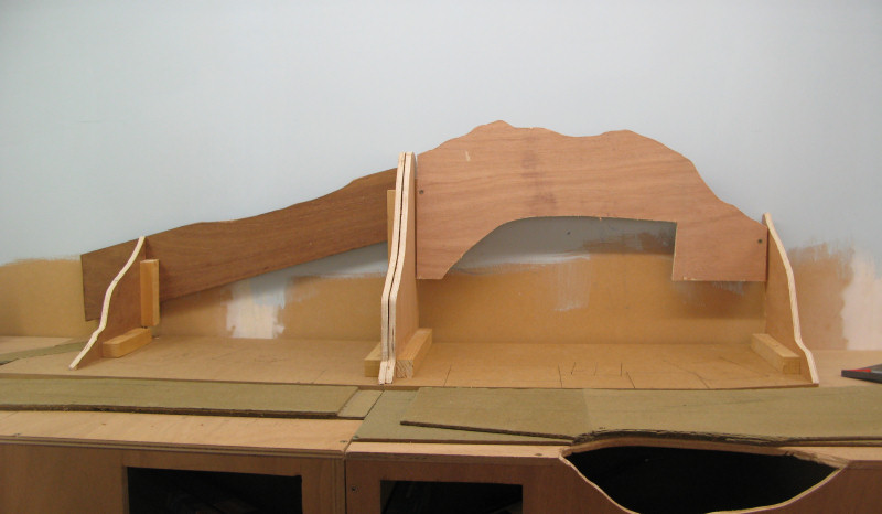

Slow but real progress. The mountain line in the background, the location of the buildings and headframes on the diorama basis.

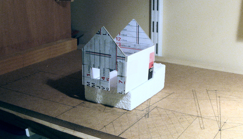

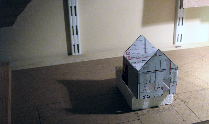

The cardboard core of building #2 has been cut. It will be covered with Canson paper (ala Troels) and decorated (ala almost Troels - in the best case...). A small office building nested in between the heavier mining structures.

Good to see life again Frédéric... Black cardboard would ease your life a little... Won't show between planks, interior invisible if needed, light won't shine through etc. And if you use matte board, it is acid free too.

Troels, you're right about the material but in the case of this building, it will be clapboard sided on the front, so no 'between planks', and I'll cover it with payne grey or burnt umber on the sides that will have plain planking. Besides the sides will be against other structures and not very visible.
That being said, if I had been able to locate this humphggrrhhh black piece of cardboard, I would have used it...

I'm glad to see you building again. The little bin (it's hard to see on the phone) is a fine tease of the good things to come

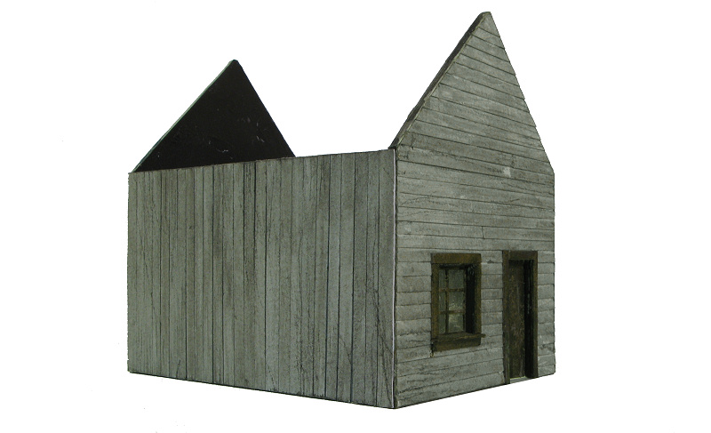

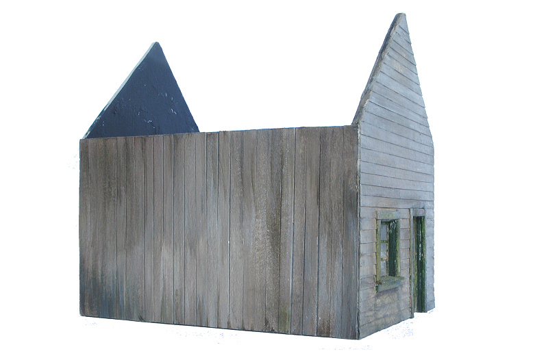

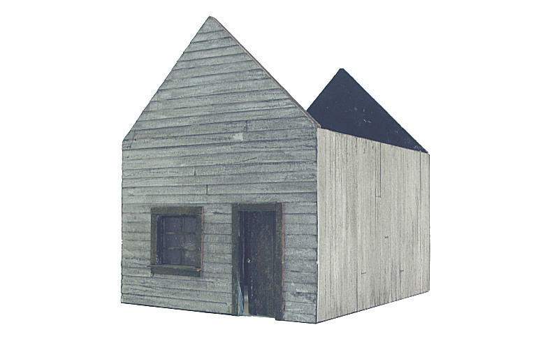

Work is going on on this building, with the help of my children who layed the vertical Canson planks on both sides (my girl also helped me paint the inside in Payne Grey to avoid seeing the white through the window). While some parallels were not perfect, I think they did a nice job, and once covered with India ink and water, the walls don't look bad.
The rear of the building will be against a steep cliff, so no time wasted on it.
Light was not very good when I shot the pics, so I reworked the colours on the computer. On my screen the last pic shows accurately the color of the side. But in any case, painting is not done yet, and some brown will be added.
The door was scratchbuilt, the window is a Rusty Stumps S scale lasercut one.

The colors came out good Frederic. and thanks for getting close enought that I could see them on the phone. Can't wait to see them on the big(er) screen. Isn't it 10x funner when you can get the family involved too.

Nice job !! Think a not so perfect allignment of planking adds character to a build. Great fun to see your children love to model to...

Thanks, Bob, Martin and Troels.
The children made walls turned out quite good once painted in fact.
Troels, I'll have to see if I can find this 100% black material. In any case, the white/black one has been rediscovered in the layout room.

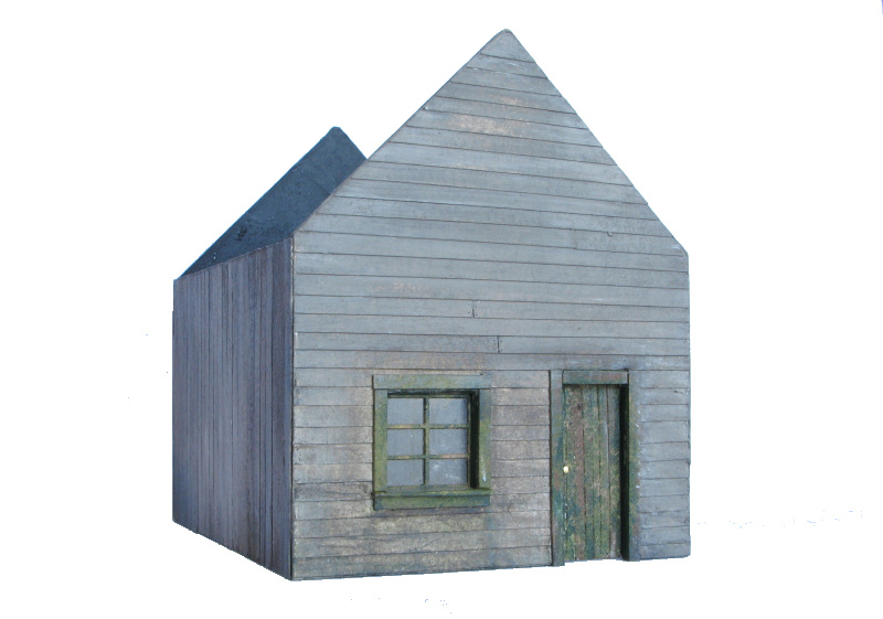

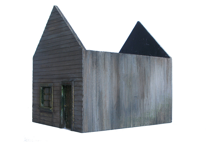

Here are three shots of the painted structure. I thought it was a bit dark and have slightly lightened it since. I see the door frame requires a little more paint work.
I'm currently working on the roofs (both for this building and the little one in the logging diorama). Pics and text to come later.
