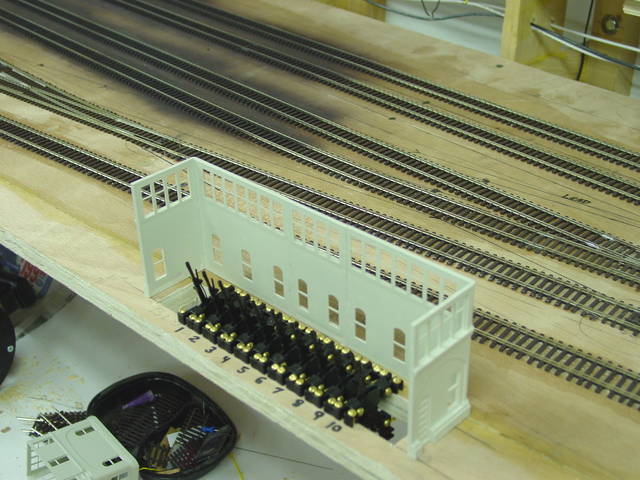

Hi James, I was happy to see that you are using Humpyard Purveyance controls. In case you haven't seen it, here is a pic of what I have at both ends of my passenger terminal. I have yet to finish the building but I think it is going to work out well. I really like the controls.

I'll have to remember that mounting, if I wind up with a place where a building can hide it in the next phase. For my Bexley yard, I left an open slot between the engine terminal levers and the yard body levers, and it makes it easier to work them by touch. I am going to do the same in West Lynn, with the 3 already installed for the Middle track, and the left 4 for the east runner.
