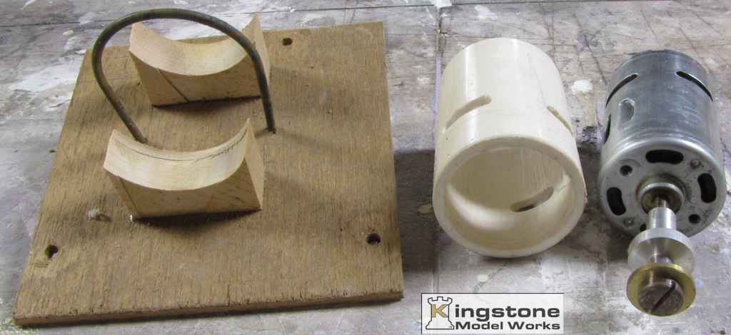

So lets get started. First you'll need a motor that will vibrate when something on the shaft is offset from center. I had the perfect motors. Back many years ago I got very interested in building model air boats. Both gas powered and electric powered. I started to build an electric one to retrieve the gas powered one when the engine quit. I didn't get to far before I lost interest and went back to model railroading. Anyway I had started to build the electric powered one with twin 12 volt electric motors. I got as far as building a frame work to mount the motors and two pontoons to support the batteries and motors. The first picture shows what's left.
The motors are out of one of those little plastic cars that kids first learn how to drive with. They have two motors a bunch of plastic gears, a charger and two 6 volt battery's. I think this is how they get two speeds out of the vehicle. I happen to be two driveways up from the towns transfer station. The guy that is there on duty is my neighbor and allows me to bring back any purchase I don't deem keepable. The motors are quite powerful and run at a fairly high rpm.

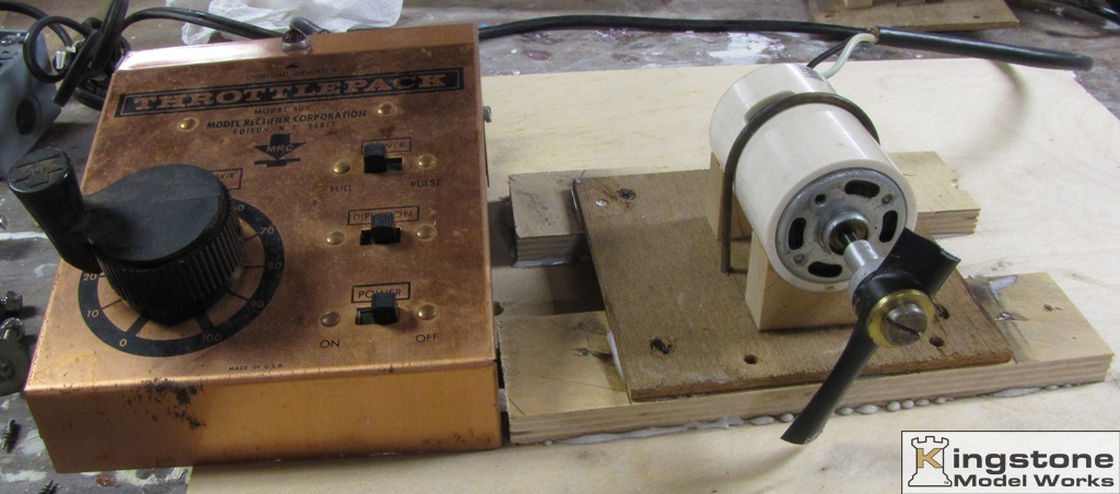

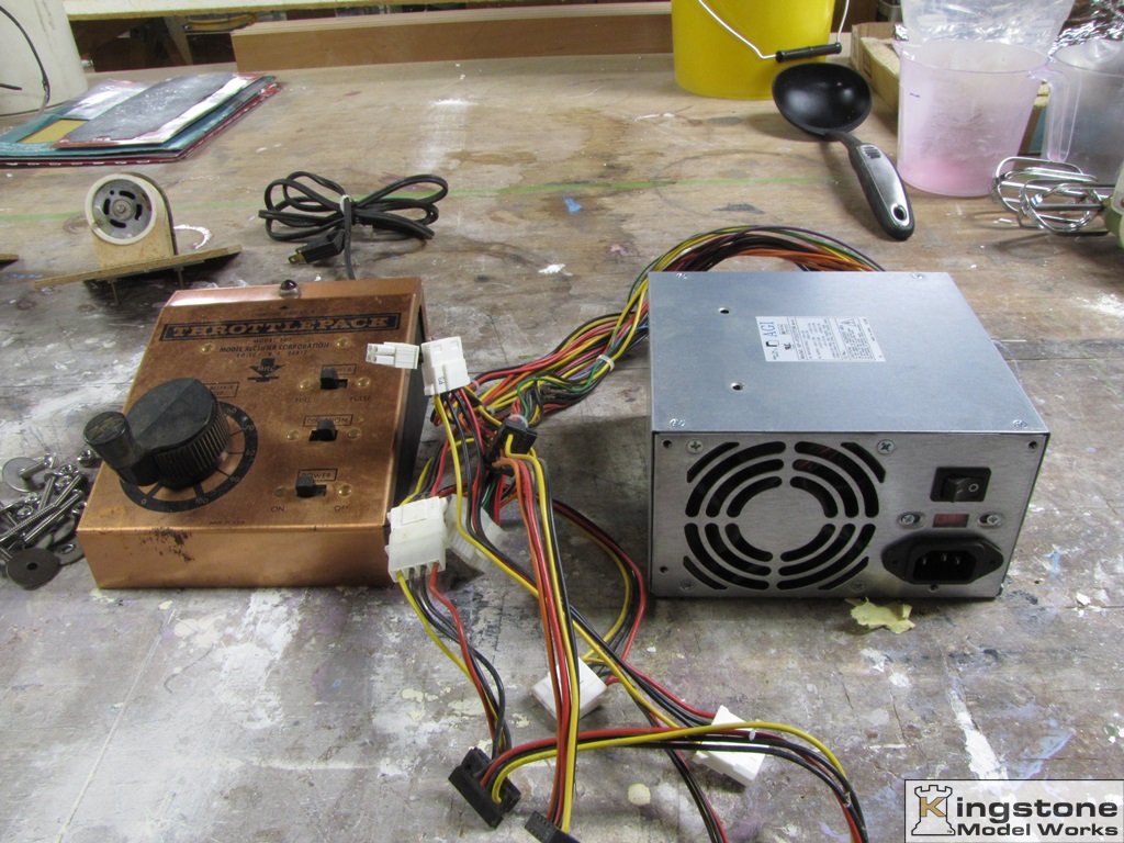

Before mounting the motor to the table I needed to find a power supply. The computer power supply didn't like the motor at all. It would start but the power supply would shut down. One of two things happening here, either to much amperage ebing pulled or way to noisy (electrical spikes back feeding into the supply). The old train transformer worked okay but would would also pop the circuit breaker. I lubed up the bearings a bit and the supply seems to be able to handle the motor at around 9 to 10 volts.

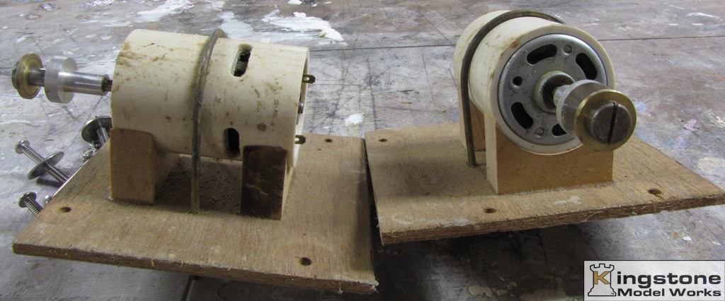

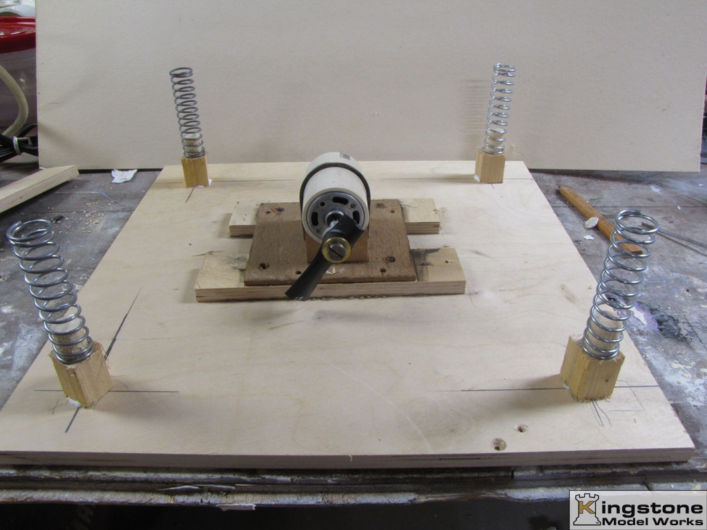

when I had built the motor pods I used some PVC piping I bored out to the motors outer diameter. The motor is a tight slip fit. I did that so I could pull the motor out without having to unscrew it from the frame. Also the hold down band didn't squeeze on the OD of the motor.

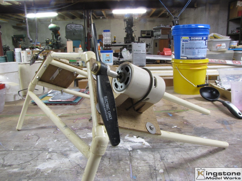

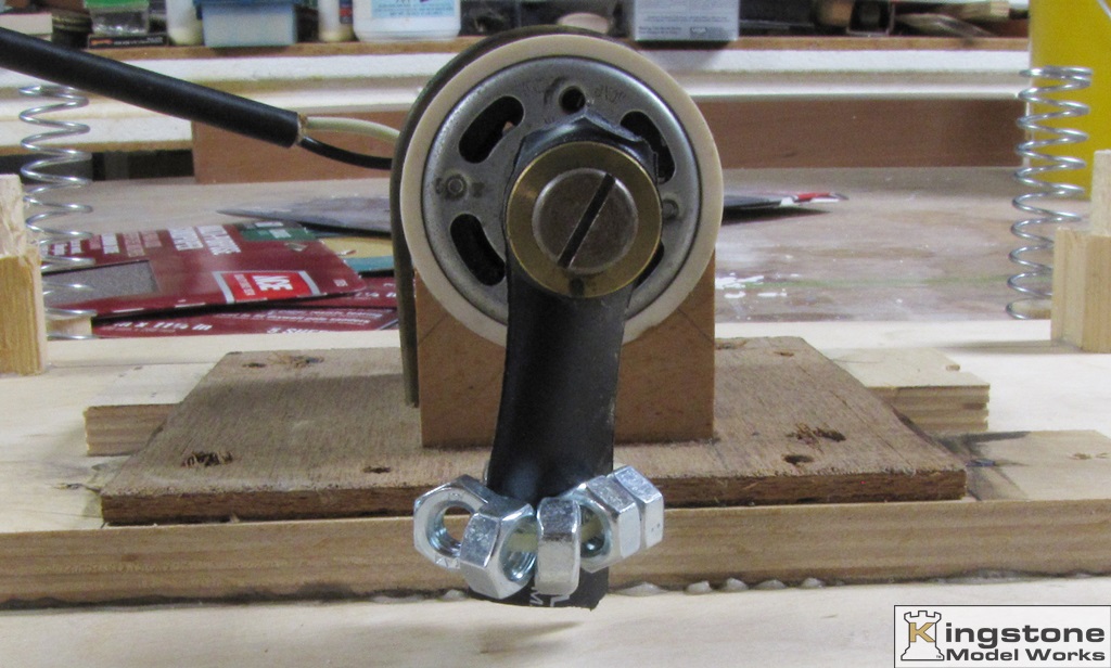

In order to get a vibration out of the motor I took one of the blades and dismembered it.

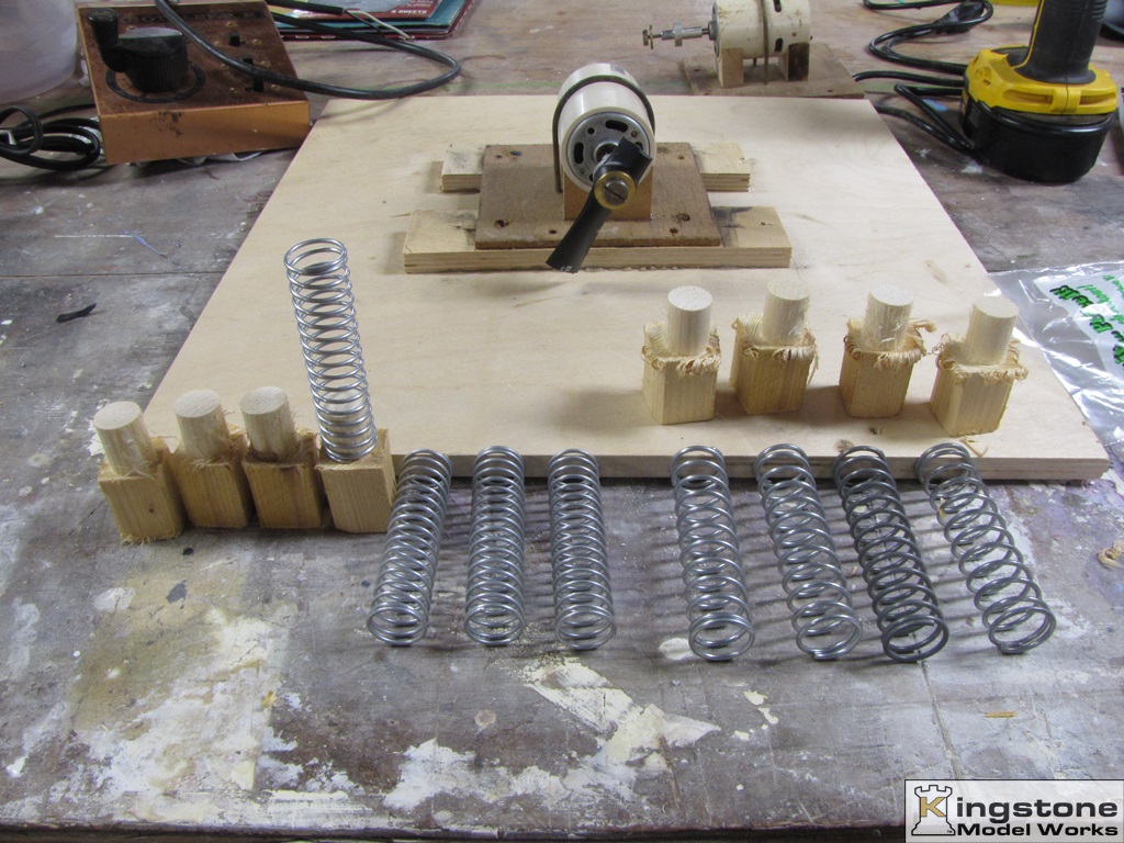

The motor was mounted on one to the plates. I purchased two sets of four springs that I thought would work. The set on the right have a larger diameter wire to make the spring a bit sturdier. I turn four pieces of square wood to the ID of the springs for a snug fit. At this stage of the project I couldn't find the dowel I knew I had hid somewhere.

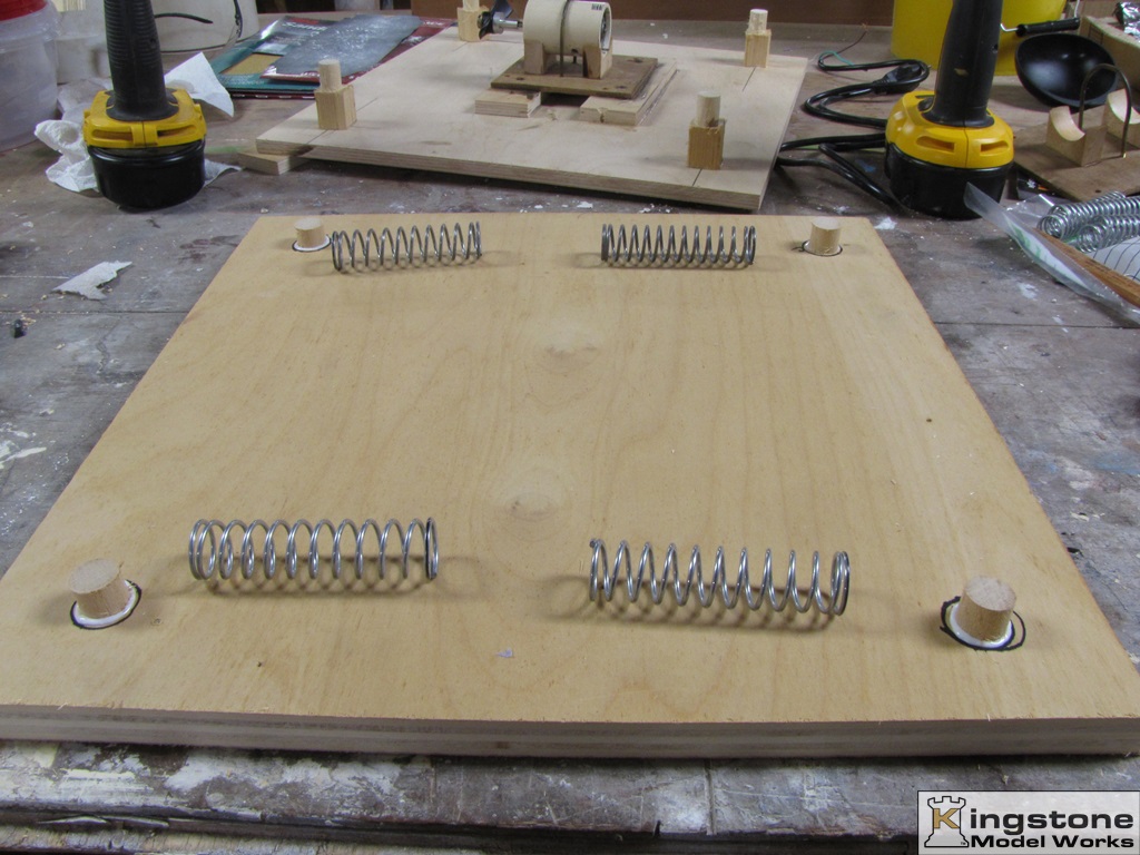

The turned pieces were glued and screw to the bottom of the table.

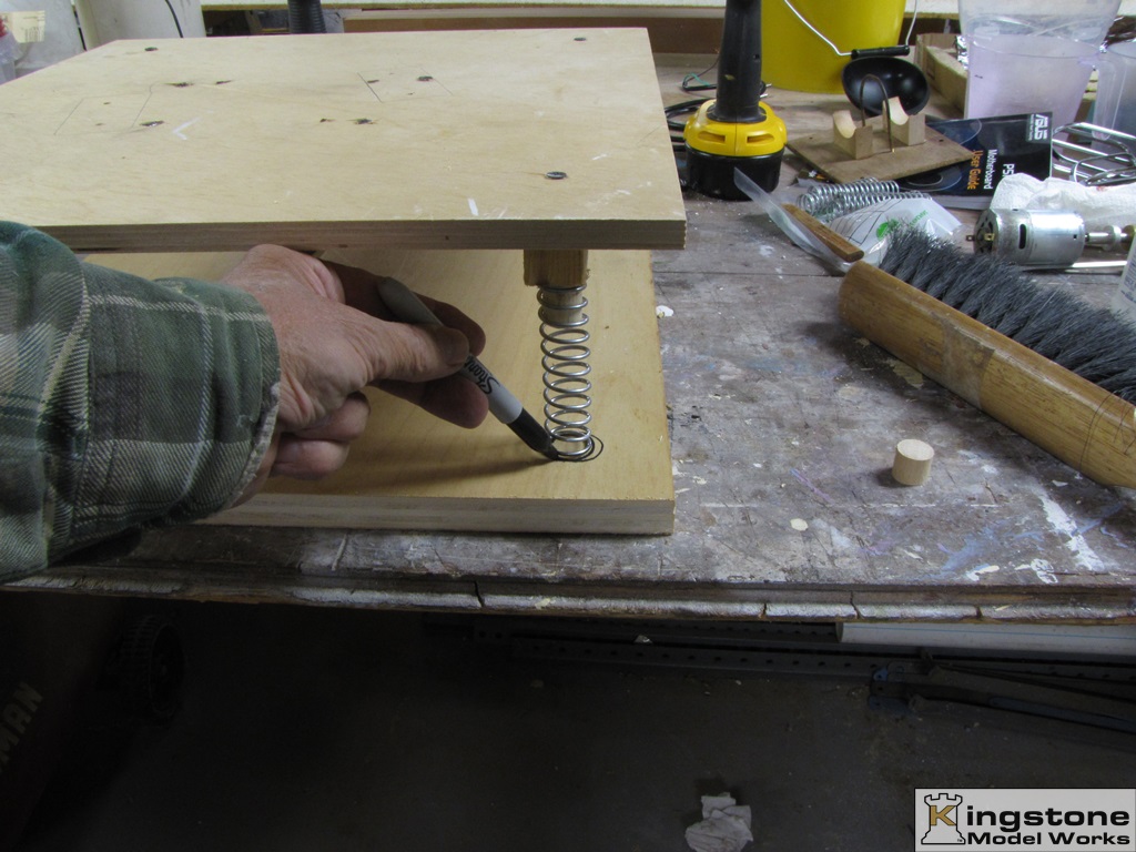

By the time I got around to doing the bottom part of the vibrating table I had found my dowel. Here I'm marking where the round dowels will get glued to. I was going to drill a pilot hole and also screw the dowels down but found it wouldn't be necessary.
Waiting foe the glue to dry so I can take the table for spin.....ah vibrate.

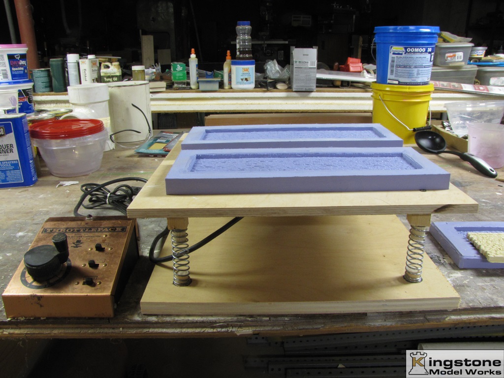

And the finished tool. Works quite well except it doesn't vibrate enough. I'm going to have to add more weight to one side of the abused prop to give it a bit more vibration or make something on the lathe. That's still up in the air. I tried a casting last night and it still had some bubbles in it but not like before.
I'm going to try some Hydrocal tonight mixed like Rich (Pennman) had said to try.

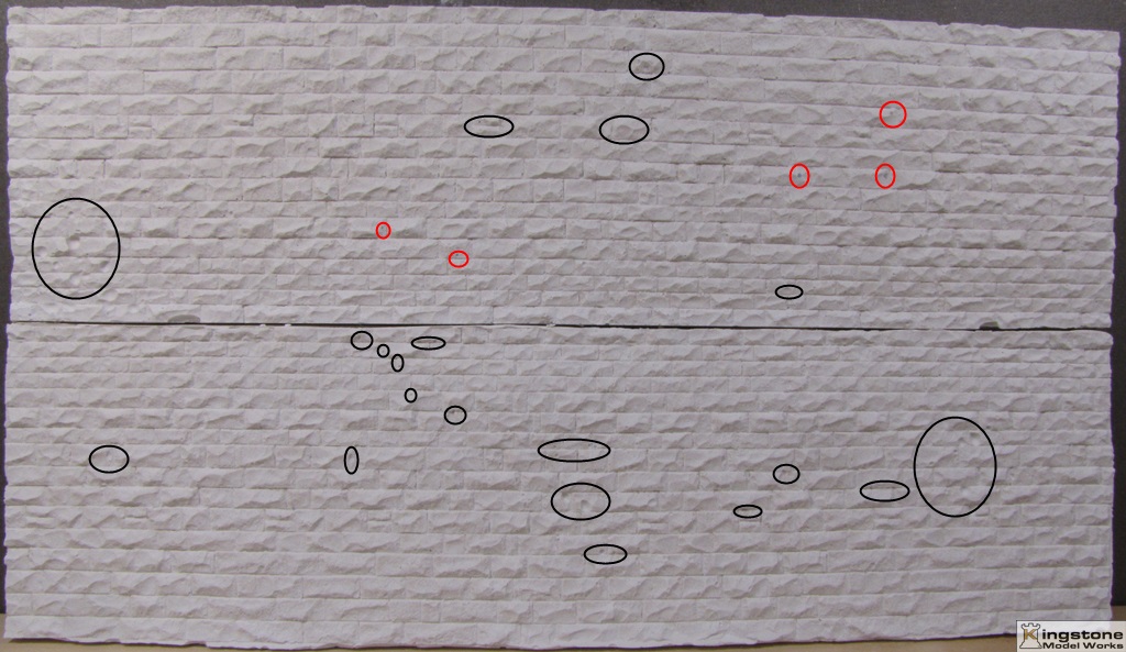

Okay, to wrap this discussion up. I’d like to thank all of you for putting forth your ideas in a fun way. I think by the time we get done with this project we will be able to handle the matrix of question anybody has on casting almost anything.
I have several observations with the casting process. I think I still mix it too fast and create too many bubbles. The vibe-table isn’t doing its job properly and the Hydrocal, plaster of Paris and even the Durham water putty is quite thick, even in a pancake consistency. I'm afraid if I make it to watery the cast medium will loose it's strength and crumble like my first two casting I made.

I'm not certain on how fast your modified propeller spins around, but I'd be worried that your zip tied nuts might go flying off!
Perhaps drilling a hole into what's left of that blade, so that you could feed the zip tie into the hole instead of just around the blade would be a little more safe.

I followed Pennman's suggestion of a 2 to 1 mix. The hydrocal was of a nice pancake batter consistency. I tried my best not to get any bubbles in the mix. But they did happen. So I waited for a bit for them to come to the surface. After about a minuet I poured the Hydrocal into the molds and turned on the vibrating table. Not much action action of the bubbles raising to the surface. I let the motor run for quite sometime. This morning I demolded the two castings. A close inspection showed bubbles. Hard to see in the picture so I added black circles for bubbles and red where some of the finer mold detail got pulled off the mold.
I increased the weight on the one side of the prop by adding 3 more nuts and cut off the remaining part of the prop on the opposite side. Much more action.
I'm trying to solve the bubble problem here and can think of a couple of solutions. Now, I did clean the mold by washing it in warm water to get any plaster residue out and sprayed it with mold release. I'm going to try what Bruce Hirst suggests in his video of casting dental stone. He talks about using dishwasher rinse agent. I put the link here so you don't have to go back to my other thread. If your impatient click at about the 1:30 mark. That's where he shows the bottle of rinse.
