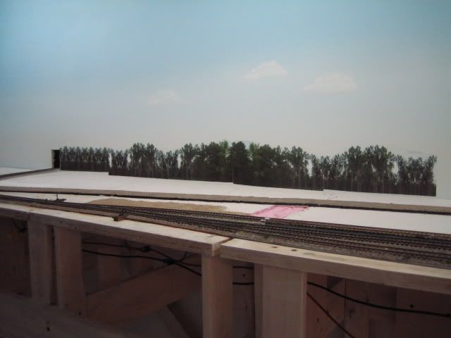

N2626 Posted - 04/24/2016 : 10:10:25 PM
That ain't Cheatin', that's taken advantage of a good way to go!
darrylhuffman Posted - 04/24/2016 : 06:48:00 AM
I cheated for this backdrop and used photos from the internet cut out and spliced together.
