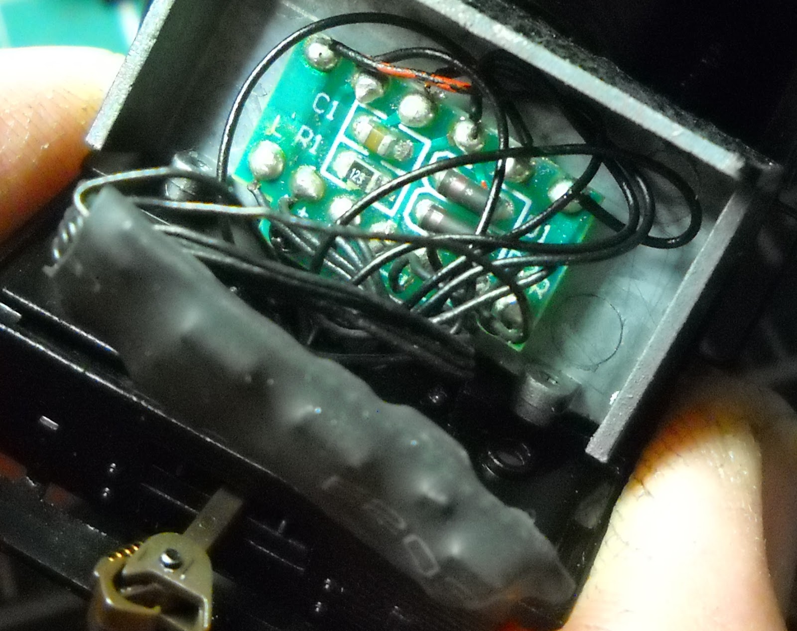

Hookup to a DCC sound 0-4-2 is easier and here is on with my hi tech camera mount.

I so appreciate the info here. I built a keep alive circuit for installation on a tender for my Porters. The diagram for the 0-4-0 sound was perfect and the loco runs great (Have to turn off that CV for the DC option).
Now has someone added a keep alive to the non sound 0-4-2 and the 0-4-0's? Where to solder the two wires would be great info. Oh and the gas mechanical.
Porter 0-4-2 non sound.
On the board the connections at the top go to the loco, motor, front and rear lights, and input from the track pickups. The lower connection go the the decoder. From left to right are:
Pick Up L
Motor +
L+
Rear Light-
Front Light-
Motor-
Pick Up R
