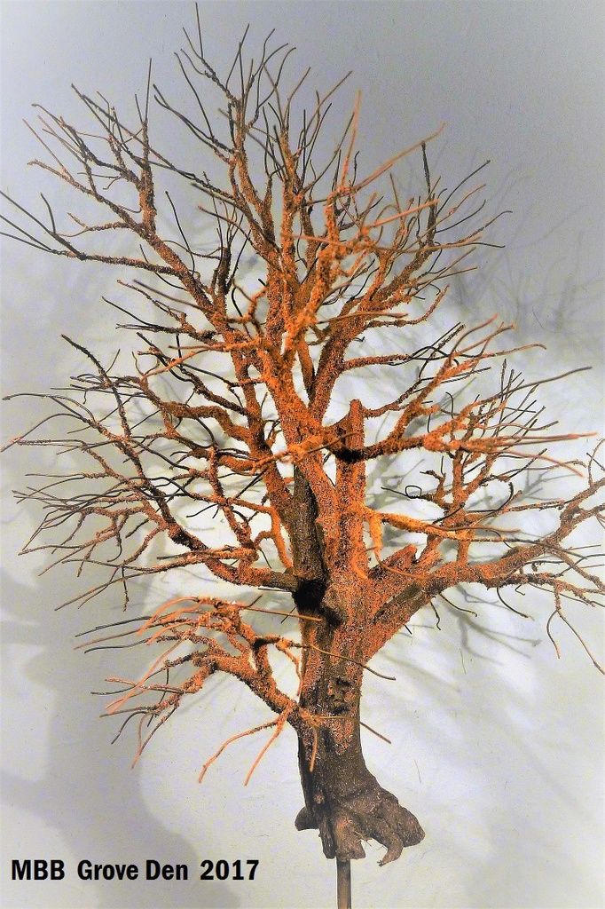

How I accomplished it?
I just start watching/observing trees forthe last 40 years and started to modell them for 12 years ...with in the beginning a "lot of trash" but in the last 4-5 years something happened.....the jigsawpieces came together!
Still some left but the overall image/picture is already clear!
the frame of the oak still without the bark....
Jos

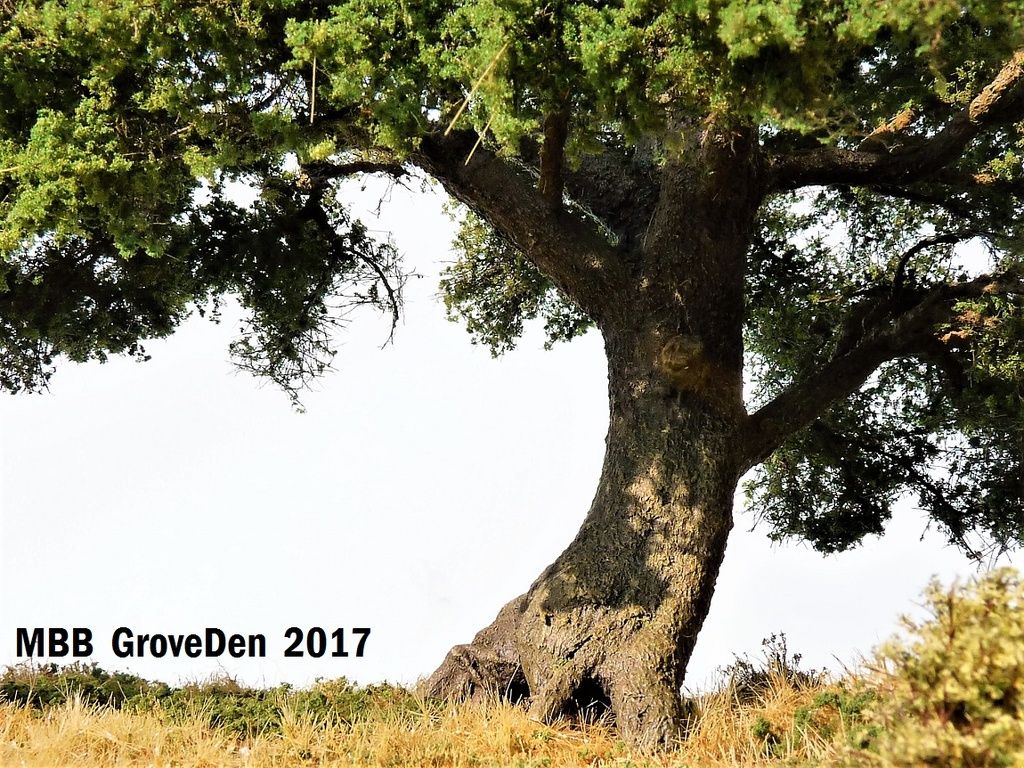

kebmo Posted - 03/17/2017 : 9:24:18 PM
damn! that is simply amazing. i'm still unconvinced that its a model.
Frederic Testard Posted - 03/17/2017 : 7:16:59 PM
Another masterpiece, Jos. Magnificent tree!
jeyjey Posted - 03/17/2017 : 3:50:59 PM
Masterfull!
scotchpine Posted - 03/17/2017 : 2:23:43 PM
Something "big"
an 200+ year old oaktree-H0 27 cm/11 inches:
and the base of the trunk. btw you can see at the top of this picture still 3 not removed 12 mm Fibres the "basic"layer for the foliage.:
and in winter, without leaves:
Jos
